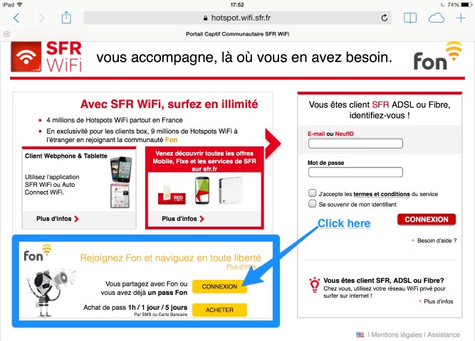

We connected through SFR W-Fi Fon network in France recently using my BT Broadband log in details with no problems what so ever.
That along with the 3 Mi-Fi we have meant we had internet access every day.
We need the internet so the wife can keep a check on her websites and answer any queries that arise.
If you are connecting to SFR Wi-Fi Fon do not use the main log in section on the right.
Use the section slightly lower on the left which is highlighted in Yellow here SFR Wi-Fi Fon.jpg
