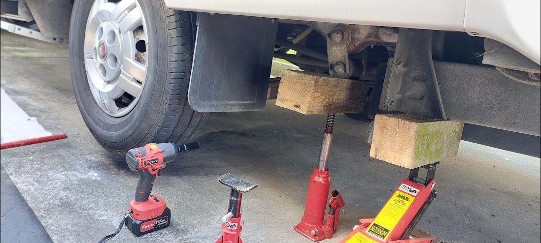

Needs a few blocks to get off the ground. Rear wheels off to do the brakes last month.
