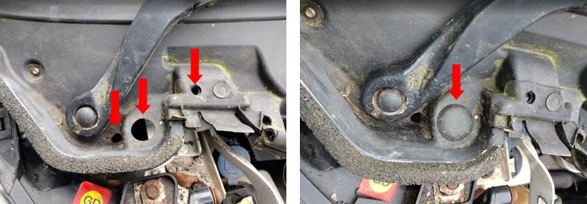

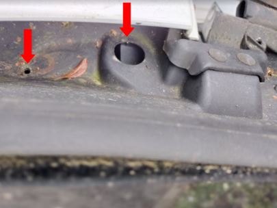

To replace the windcreen wiper motor I had to take the off-side scuttle (drain below the windscreen) off.
As well as the main drain hole, which dumps the water below the engine, there are other holes through which the water will drain into the engine bay.
The photo below shows the holes, on the off-side, around the wiper arm. Only one has a bung, as shown in the right hand photo.
Below is the near-side, two holes and no bung.
The question is why so many holes. I don't see why they can't be sealed.
Any thoughts?
Two thoughts
1) The holes may be used in the LHD version and having both means the same part can be used
2) Once the water gets to where the holes are it is going to end up in the engine bay hole or no hole.

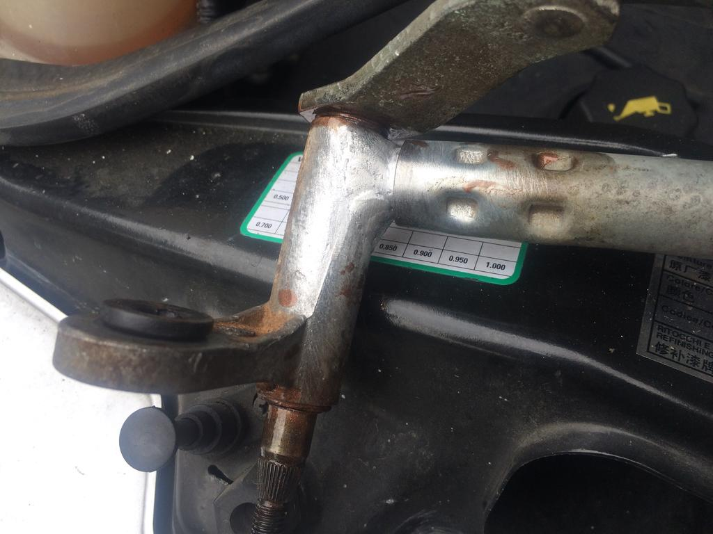

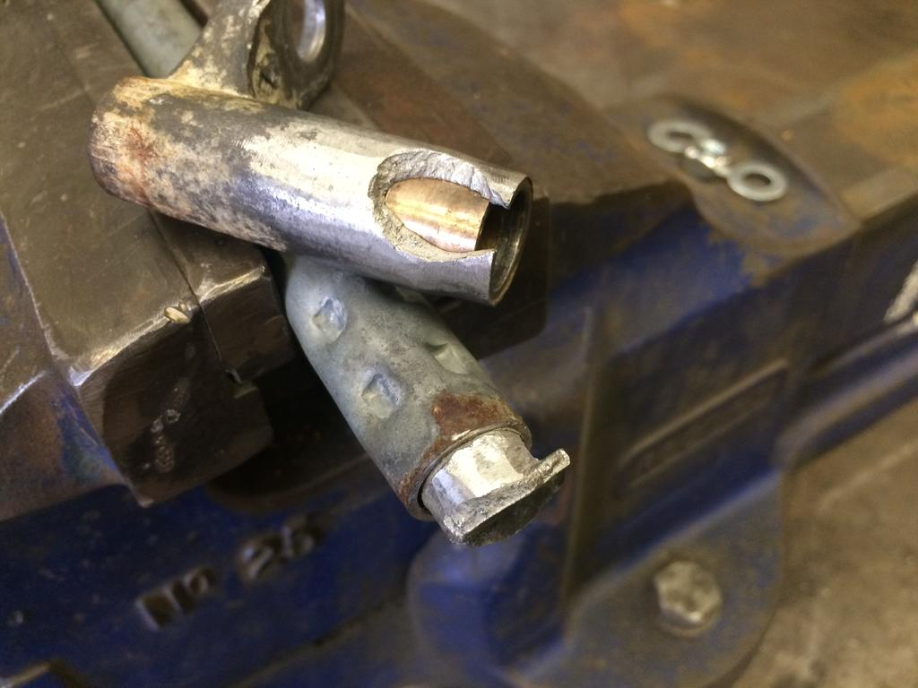

Make sure you keep those drains clear or water will get into the wiper pivot point and it will seize up and snap the pivot bush leaving the arm and blade dangling. If you are lucky it will not damage the bodywork and not happen to you on the M1 in heavy rain like it did me
Yes, this makes sense. But I would have thought the water would be drained away from the engine bay, not into it. Perhaps Fiat hopes that the main scuttle drain will take away most of the water. The hole under the wiper spindle, the one without the bung, is tiny so could easily become blocked. Overall a poor design.

The pivot after I had welded it back together. One thing I do miss with retirement is not having full workshop facilities available anymore. Now its throw it in the bin and buy another, it just seems so wasteful to me.
I certainly learned my lesson on that one and always clear leafs before leaving a parkup.

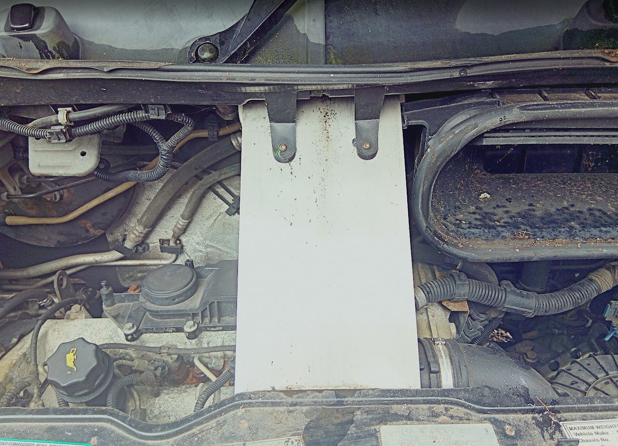

There is another common point that allows this to happen and has not been mentioned in thread :(
On the X250 model (Model from 2006 with the big headlights), the plastic scuttle below the windscreen is made in two pieces that have a centre overlap.
This overlap is not sealed in anyway (or if it was, it is not done very well) and allows water to drain onto the engine and fill up in the recess where the injectors are.
I didn't really realise about this until Andy (of Andyjanet/Sidders) pointed it out to me, and while I was doing some work on his Motorhome, he did some on mine to address this issue (y)
The silver metal plate in the photo below that he fitted deflects any water coming in from that centre join away to the front to drain away. Where before I had water always pooling in the injector area, now it remains totally dry. I just wish I (and the previous owner) knew about this years ago!
The Facelifted X290 Model has a one-piece scuttle now and I bet the water ingress in the middle join is a significant reason why!

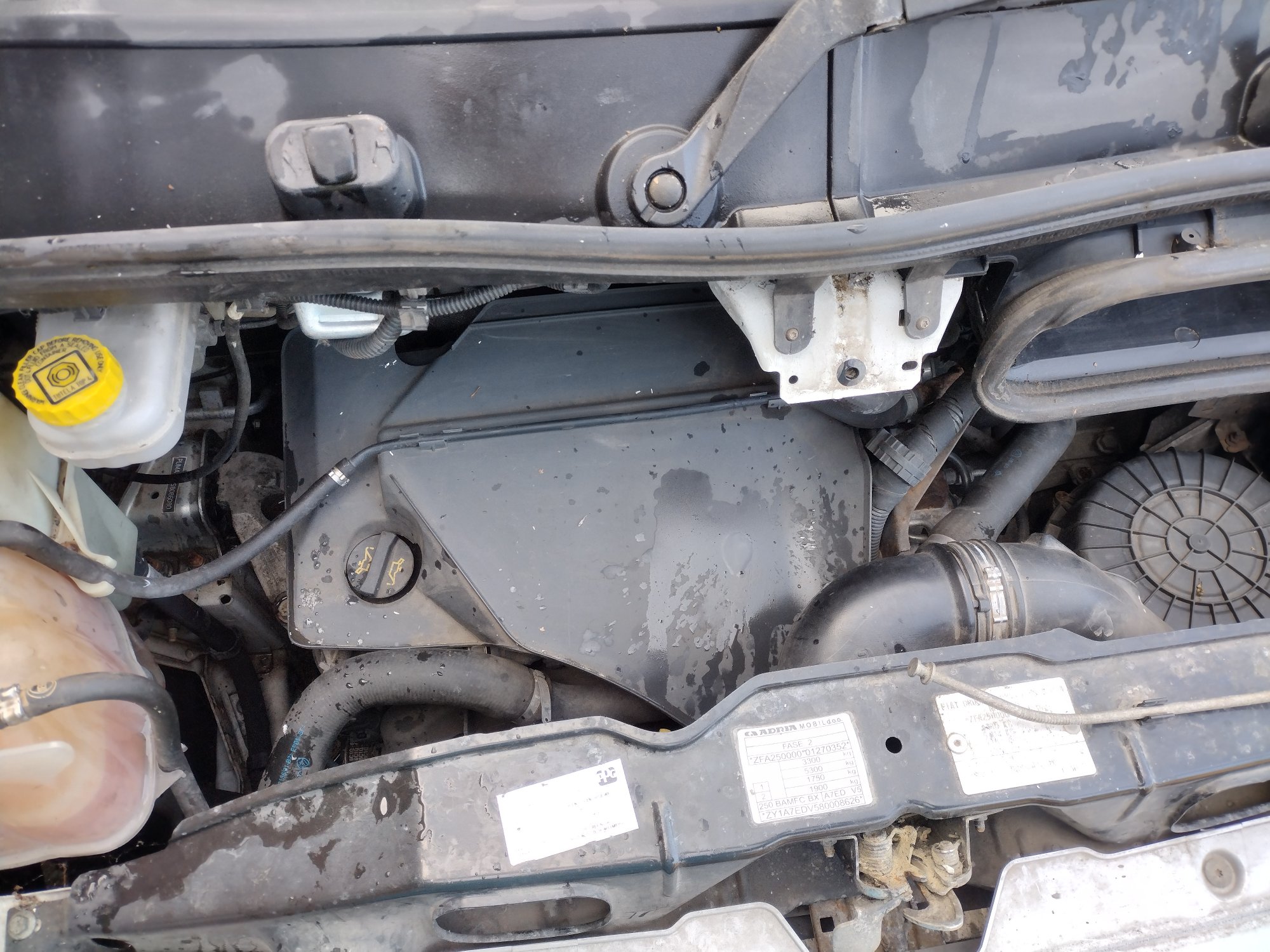

Yes, there was a also a plastic top cover missing on yours over the engine, missing from I see from the picture, to help protect the water ingress, but still allowed water to drip onto the throttle body which made the actuator seize up, which I replaced. I fitted a drip tray under that dodgy scuttle joint with a drain pipe.
Mostly cured on my series 8 ( X290 facelift) now water only runs in the air intake on the bonnet and drips on the engine ☹️
They make changes over time to vehicles, some to fix unexpected issues and others to save money. You have an engine cover on yours (don't think mine is missing as it was never there), but to compensate for the extra cost, they removed the vehicle battery cover under the floor mat :)

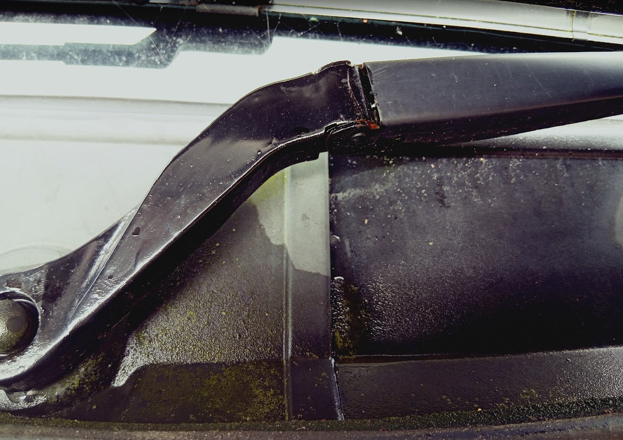

Over the last 16 years I have not had any issues with water leaking into the engine bay from the scuttle, which is surprising considering how it is 'designed'. On removing the offside scuttle there is a strip of foam where it overlaps the nearside scuttle but the overlap is very small. I added some sealant when I reassembled it.
I can see why the small hole in the offside scuttle needs to be there to prevent water build up around the wiper spindle (especially as this is where water pools when I park at home - it's on a slope).
I don't recall seeing holes for the passenger side wiper spindle - I'll have a look when I take the tarpaulin off to refit the now resprayed bonnet.
I don't see why the holes on the nearside, two holes and no bung. can't be sealed as there is no wiper mechanism there. These holes are above the battery, but as above I have not had any water issues over the last 16 years.
Checked this morning and no drain holes for passenger side wiper spindle.
The join in the scuttle does leak, despite the sealant, probably due to the very small overlap between the two halves of the scuttle. However there is an engine cover, which takes the water away to the front of the engine bay. So it looks like the scuttle is 'designed' to leak.
