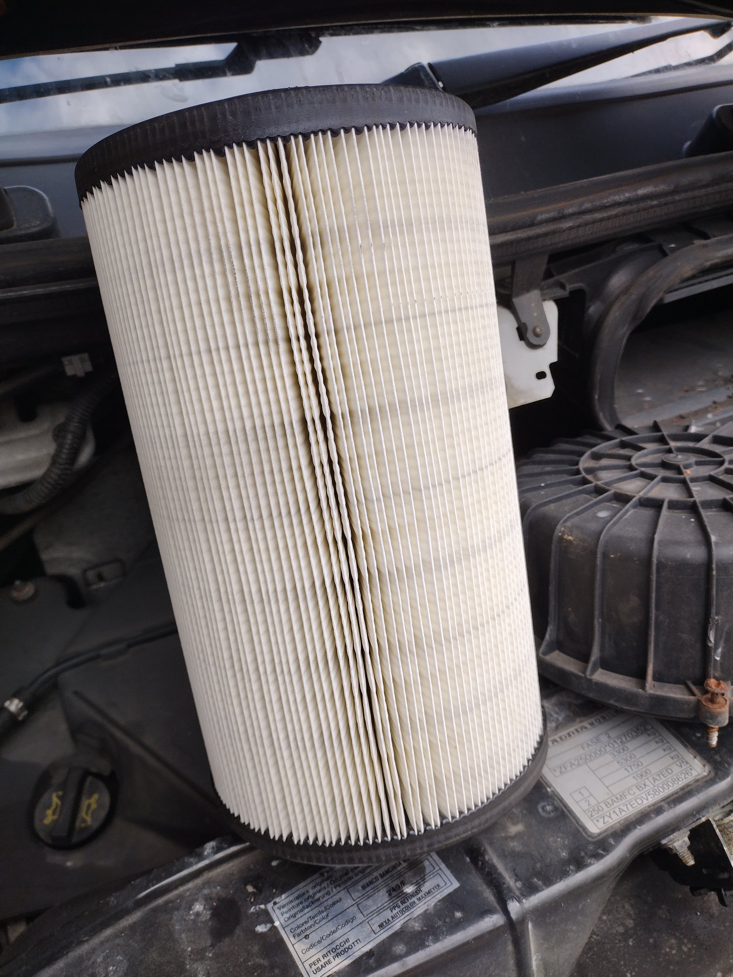

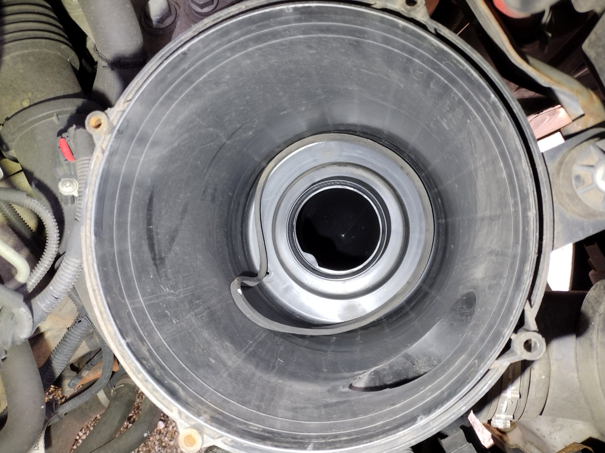

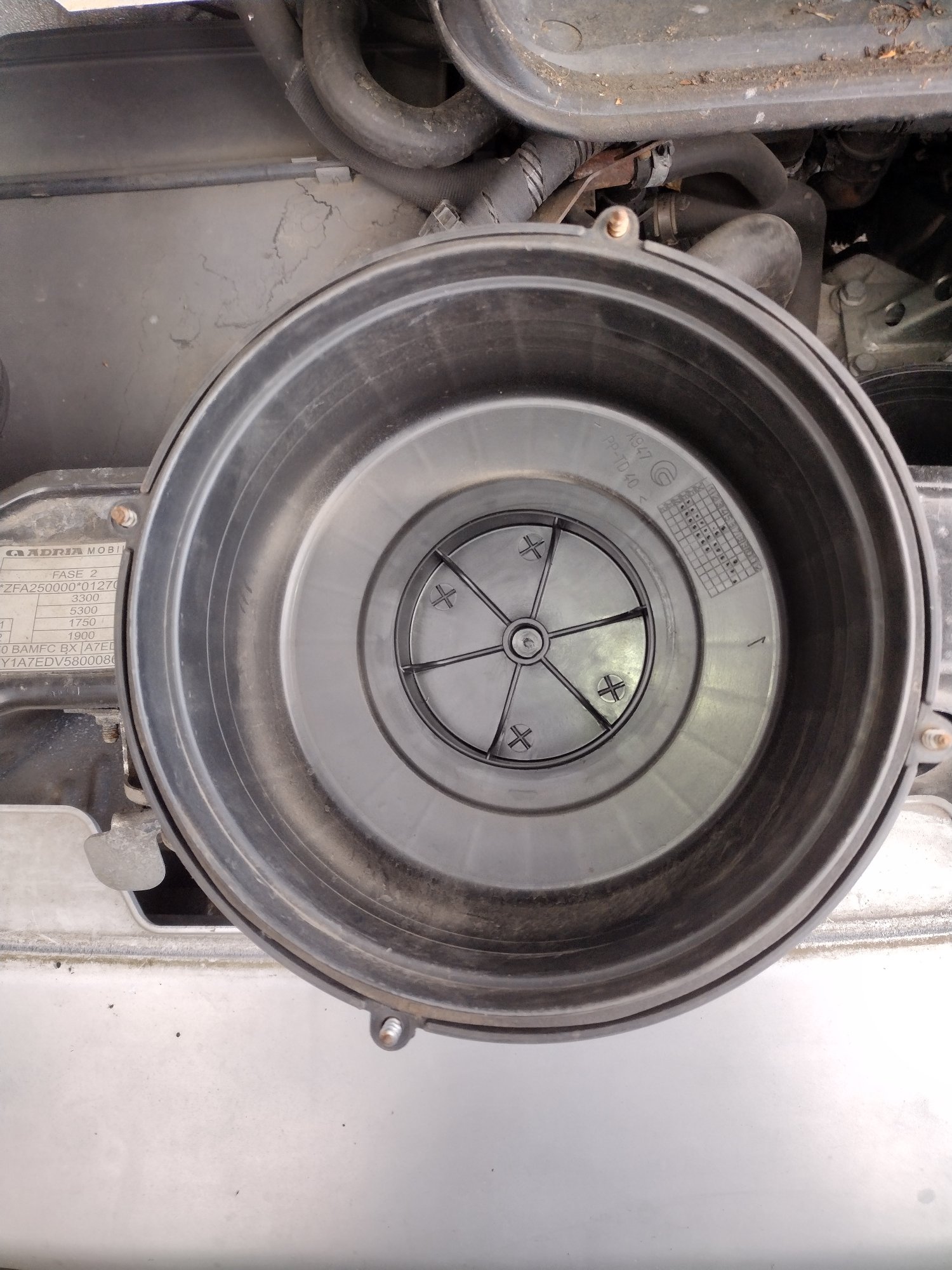

1. Mice / debris in the air filter or pipework. The filter was changed in early April and I would hope that if there was a mouse hole in it the garage would have told me. But as they left the cap seal in the bottom of the filter housing my confidence in them is not what ii was - have been using them since 2012.

The photo of the filter housing has the seal part covering the drain hole, so I can't see if the hole has any gnaw marks, mice tend to do that after they get inside. The throttle body on that year is another weak point, fairly easy to check, pull the pipe off and using finger open valve and allow to shut itself, this should be nice and smooth, any roughness it's kapput. Iirc the potentiometer for throttle has three tracks, they sometimes play up. Then there's the other problems mentioned by other posters, it can be a real minefield.

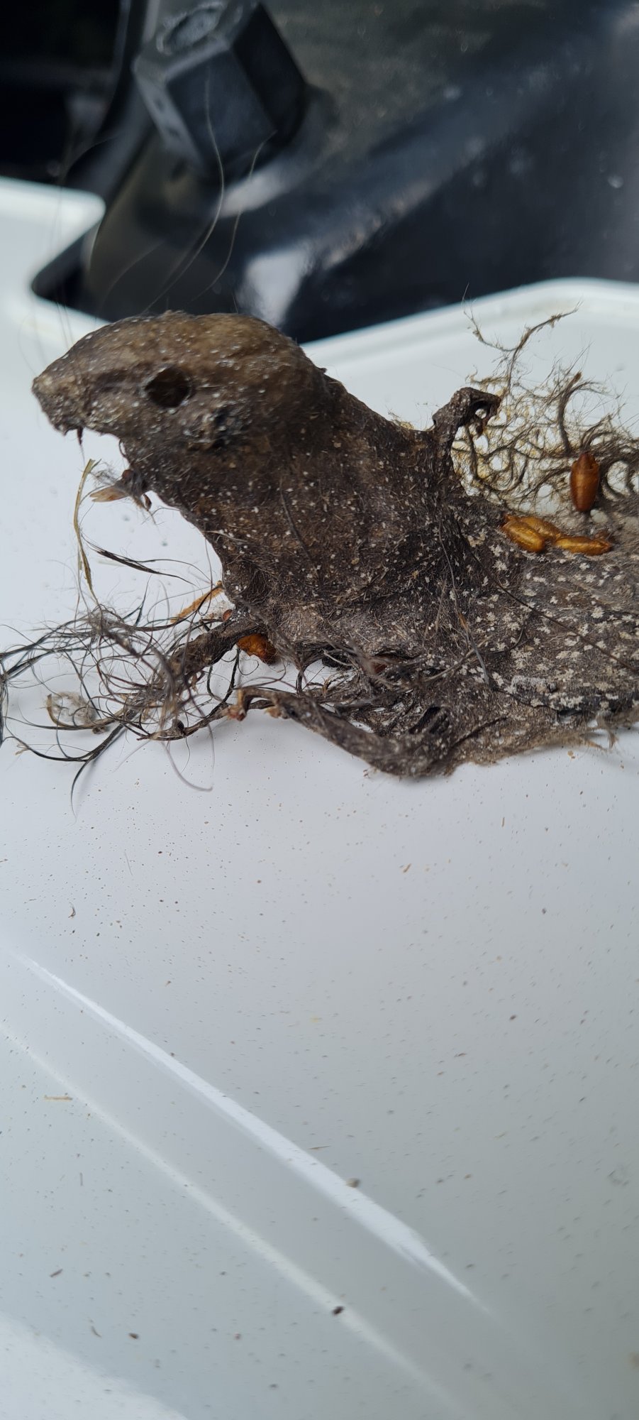

Even with a diagnostic tool it's not always easy, my van threw several errors, Fiat (un)Professional started on the "replace this, replace that" approach, so I took it away from them, and took it to Nick Fisher of EuroTrucks, at the time a large Fiat rental company with their own workshops. Even he struggled to find the problem, in the end he sat in the passenger seat with a full diagnostic suite plugged in and the van was driven for many miles until an error occurred and he could see in real time what the sensors where showing, from that he decided something was upstream of the AMS, stripping the pipes and out dropped a dead mouse.
Mice getting in the filter of x250/290's motorhomes is now recognised as fairly common if they are laid up for a few weeks at a time.
Here are the remains of my critter!
