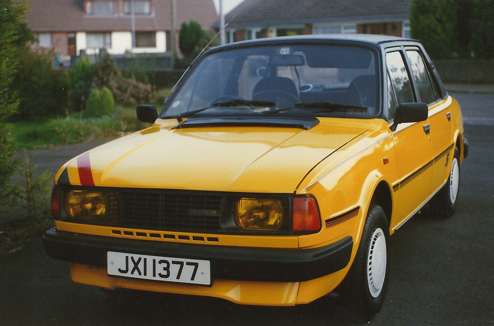

What more could you want?
A skoda estelle.
