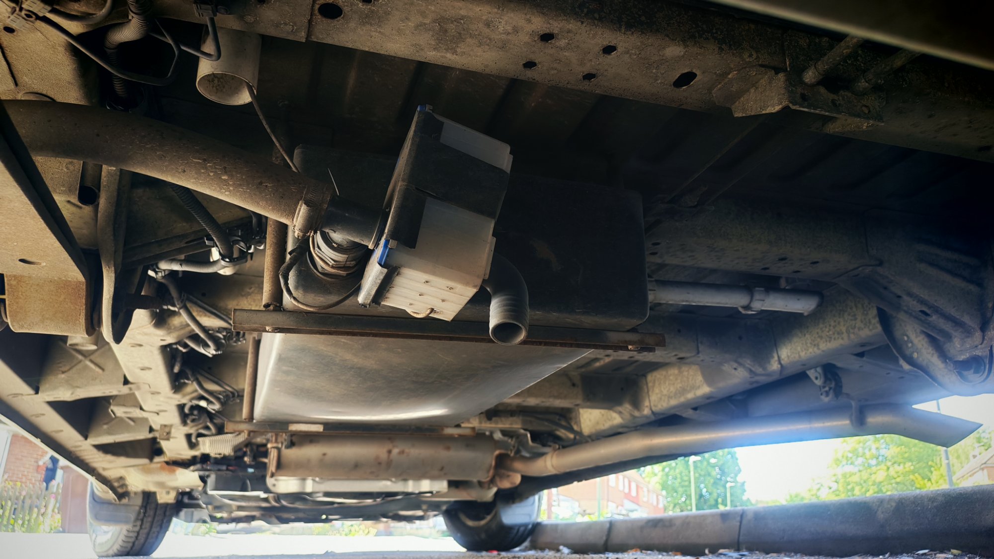

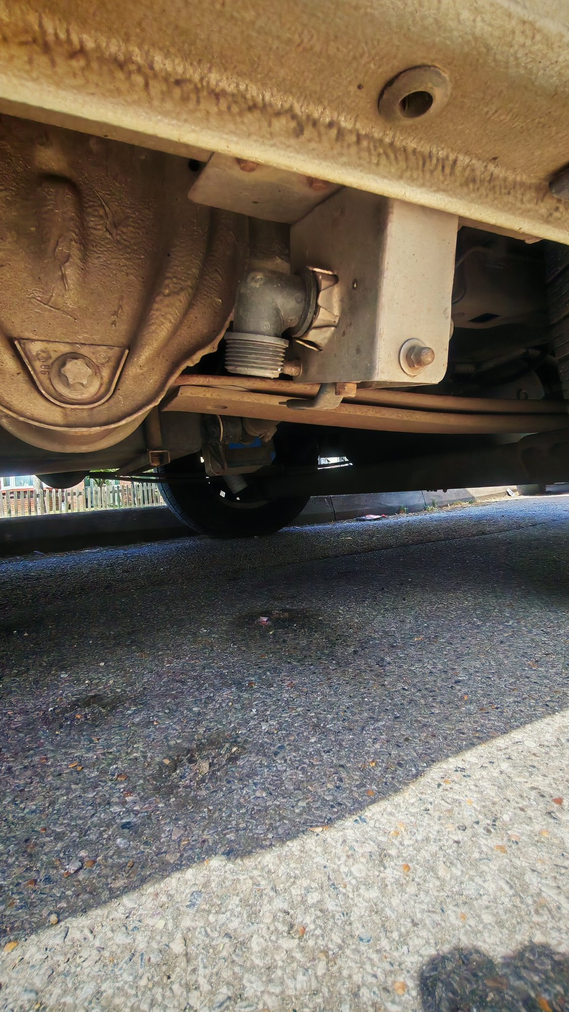

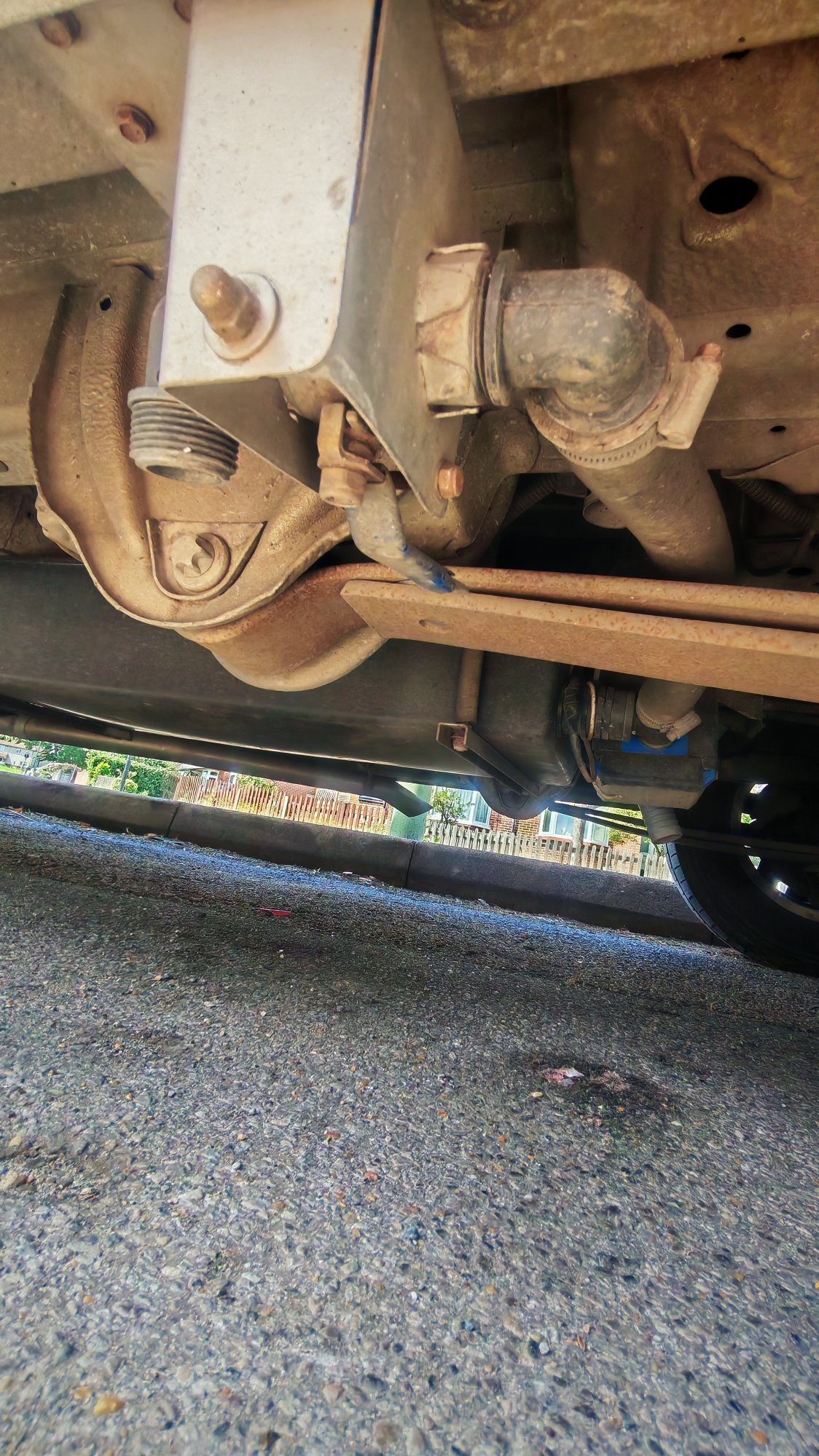

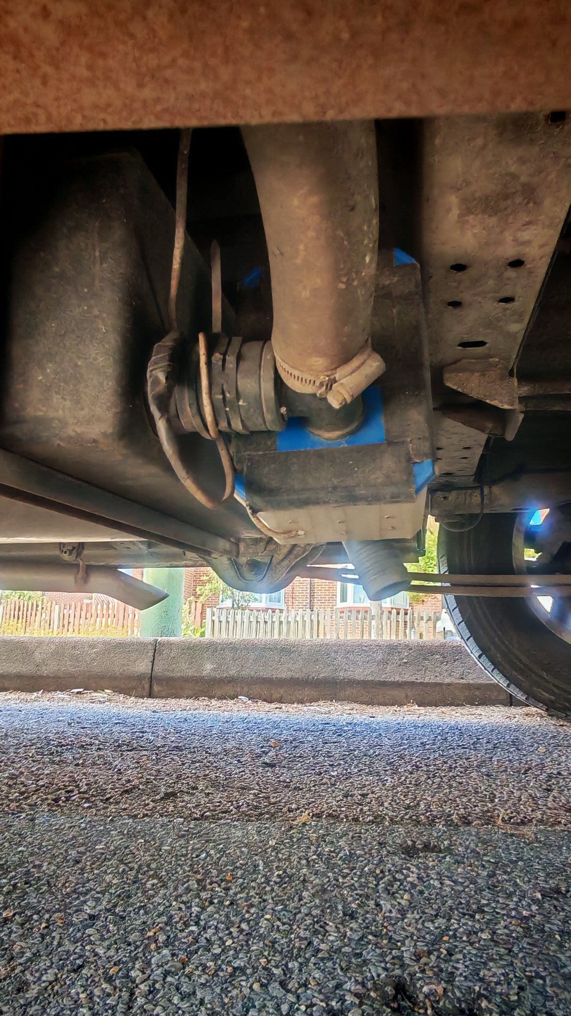

A few pics..... I had forgotten that I had protected the valve in a Kreg screw box.....no bracket.
