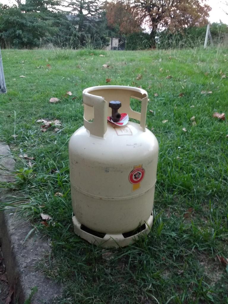

This is intermarche own brand bottle
50 x 28 cm approx
