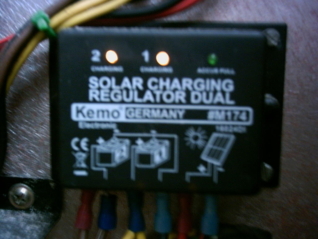

Is there a gismo that can top up my engine battery from LB and solar panel .I know their are SP controller that split charge ,i have a good controller but it dose not split. Thanks Bazz
Try this ,its what i have in my van and works v/well,£25 of ebay or amazon.

Thats the way mine works splitting 200w solar into both batteries but picking up the lowest first,at £25 and simple for most diy folk its a no brainer.

Nop it works of the solar panel and is active in daylight hrs,look at the picture again.
