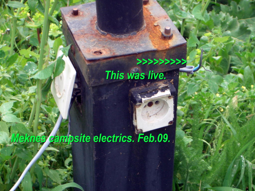

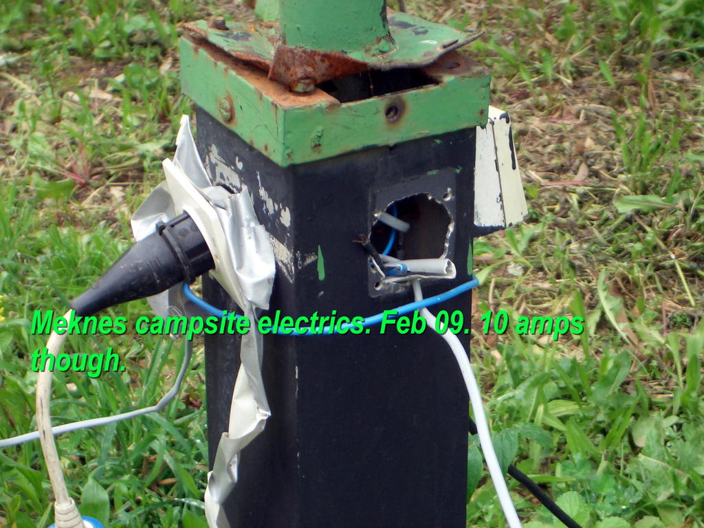

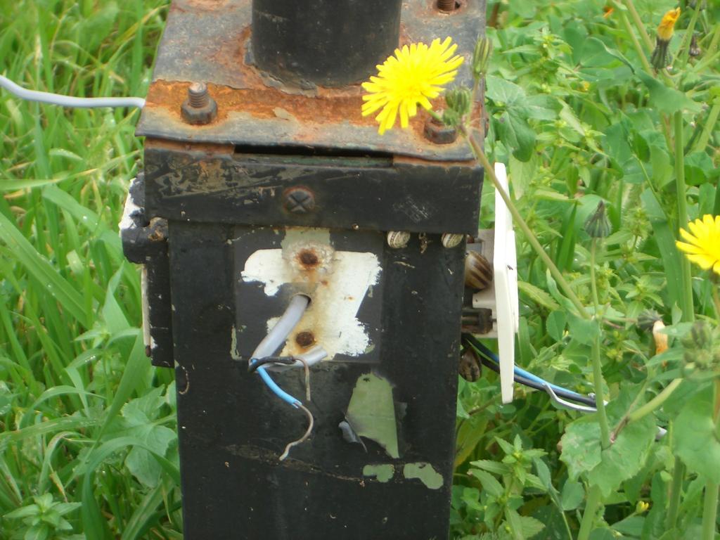

I was offered this hook up facility at Meknes campsite in Morocco.cables were live.
Had you read to the end you would have seen the final paragraph
