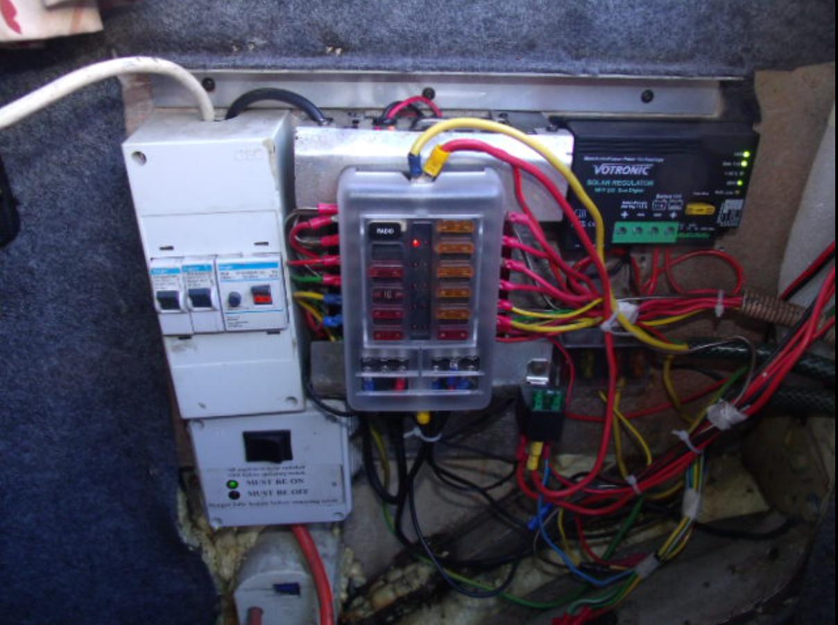

To be killed by reverse polarity, you also need to grab an unisulated neutral wire. It takes a special sort of stupid to do that.
Don't touch mains connectors, children.
In most countries, everything is double pole switched by default.
Euro plugs are reversible, so the concept of reverse polarity isn't a thing.
If you have an RCD in your mains supply (normally in the bollard even if you don't have one in the van) you are protected in any case.

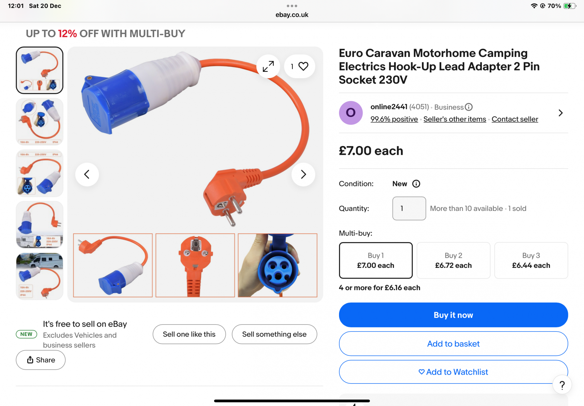

Quite often on French sites several vans are connected to one point using adapters. This makes the risk of surges higher.
