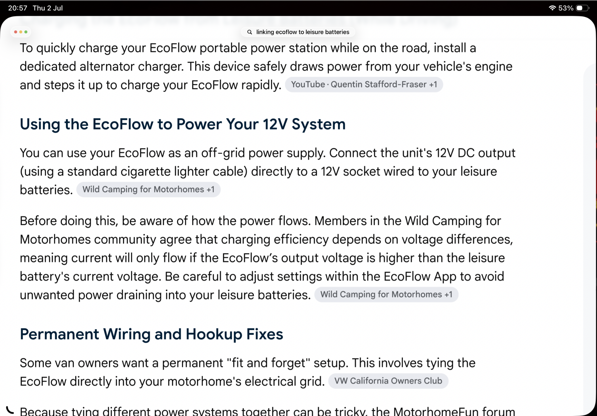

Hi, I have a Delta 3. I wish to use the 12v dc out socket (cigerette socket) to act as emergency power supply to the motorhome fridge. I was going to hard wire the supplied lead to my leisure batteries. As these batteries are also charged with a roof mounted solar set up (175W) would this be an issue? I was concerned that there maybe a back feed to the Delta from the Victron solar controller.
Running our fridge in the recent heatwave caned the twin battery setup as the fridge was running constantly, to save the batteries from dropping below 12.0 volts I connected a standalone 4 amp battery charger to see us through the night. It then dawned on me that there must be an easy way to access the 12v power from the Delta3 box rather than convert it to 240, then back to 12 again.
