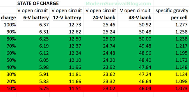

These things are only a very rough guide, and usually only tend to confuse as people take them literally.
battery-state-of-charge.jpg As a battery can show a high voltage but have little in the way of amps when they a.re getting knackerd and when a load is applied the battery voltage will drop very rapidly. If you are looking at your solar controller during the day what you could be seeing is the voltage been put into your battery which os not actually the state of charge of the battery further confusing things. Go to a reputable battery supplier for a proper battery drop test, before spending on your Eber. As it is working Ok with the engine running would indicate there to be nothing wrong with the Eber.
