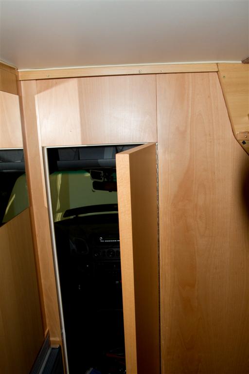

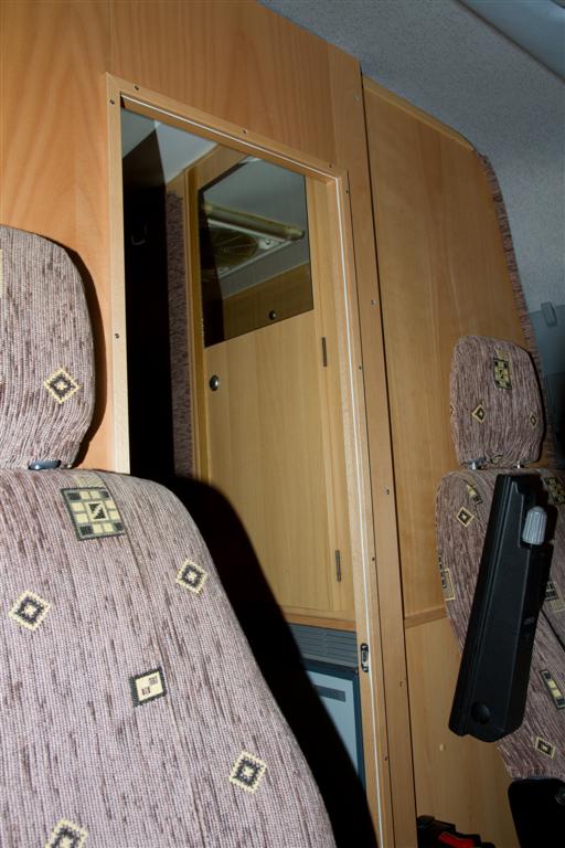

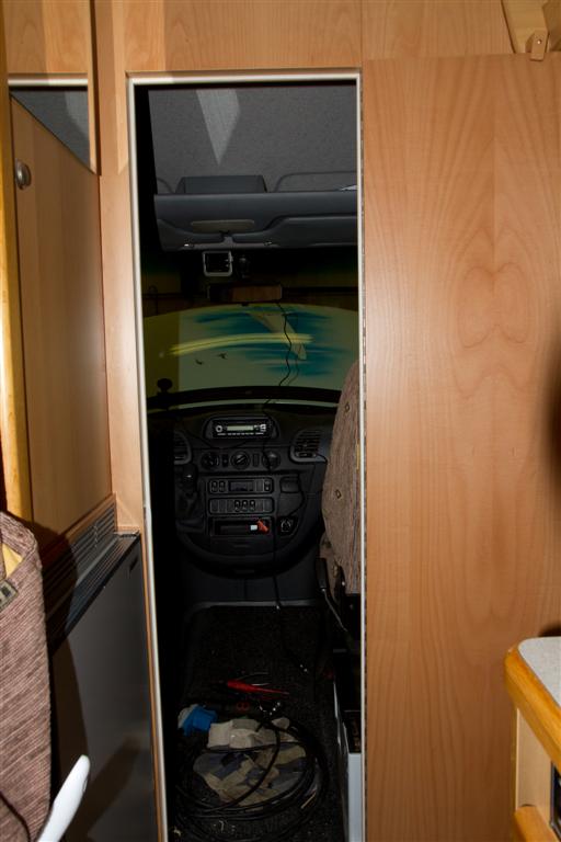

As a further adaptation of the camper to our clima I've got an isolated (w 23 mm pu-foam) separation w door made behind the drivers compartment made. See pics:
From front and from back w door open and closed
