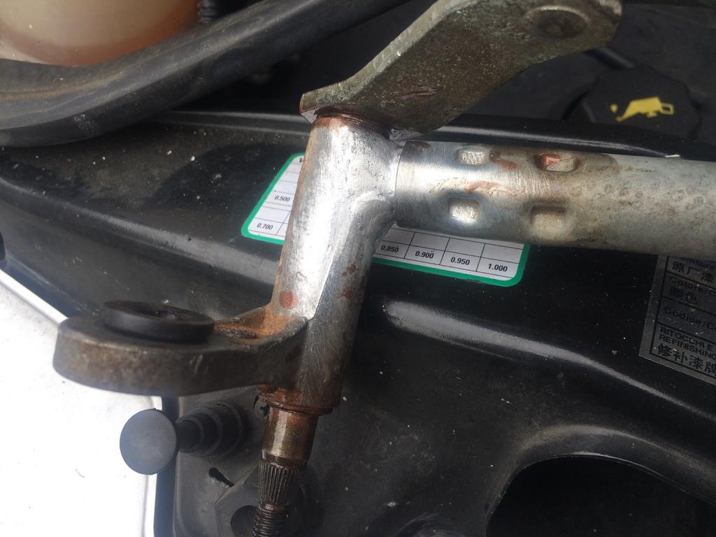

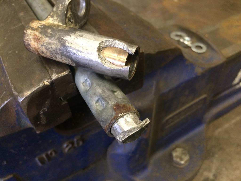

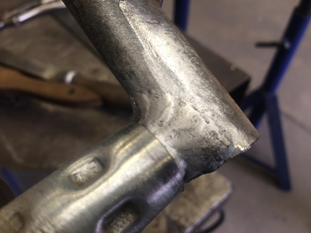

I would also check the windscreen wiper bushes. Mine seized and broke, tearing the aluminium bush off its crimped stub end coming up the M1 rendering the wipers useless. Luckily I was able to repair and didn't have to buy new. But a pain in the arse to remove.
Repaired Bush.
