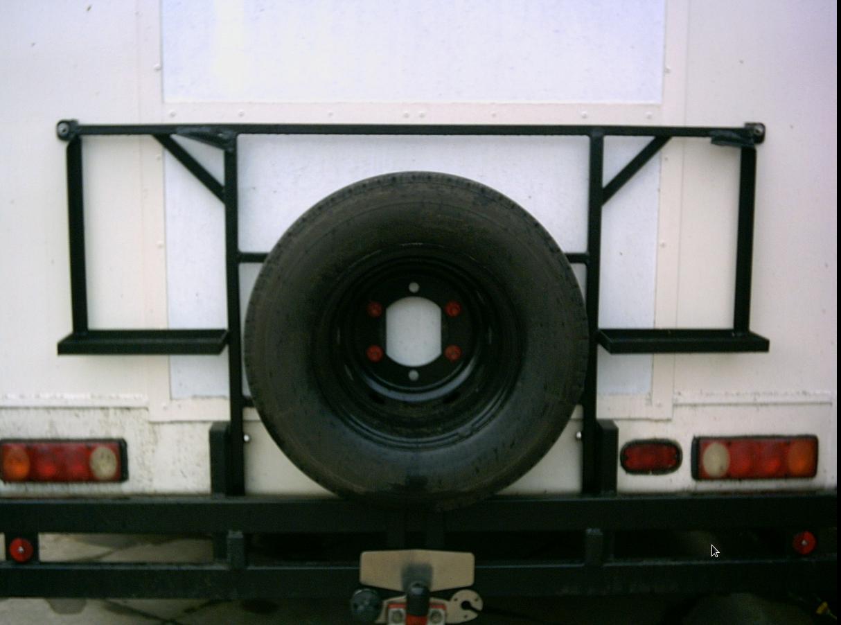

However I did build a rear door mounted wheel carrier for it (or more accurately, designed one and give the spec to a local company to weld up) as I wanted to use the side carrier for another purpose.
Clarence Rear
by David, on Flickr
Similar kind of thing to Trevors I guess, but dare I say a little more subtle? ;)
