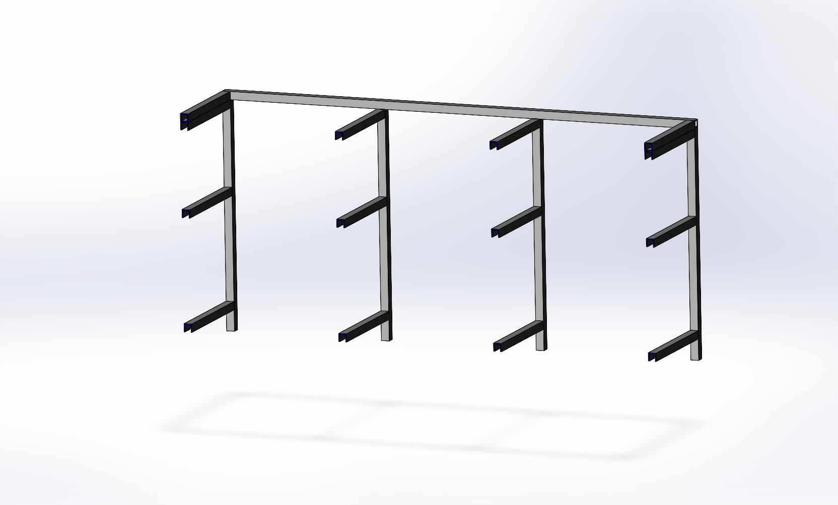

This is the kitchen sink unit with positions for eight drawers, the ninth being a dummy for the sink bowl.
Hafele Metal Drawer System 400 x 150mm (toolstation.com) for the bottom six.
Hafele Metal Drawer System 400 x 118mm (toolstation.com) for the top two.
I'm thinking 6mm buffalo for the sides, bottom and front. I've found ply tends to warp with age. I don't want a thick front, so I'm thinking about a fabric facing.
Section view to show how the drawer runners will be bolted. A bit of a pain as countersunk set screws will be required as Hafele don't give you a lot of room.
The rear legs have to be short as plumbing gets in the way. They will be bolted to the former seat fixing rail that is above the plumbing.
Handle and catch hunt next unless someone points out my foolish mistakes :(
