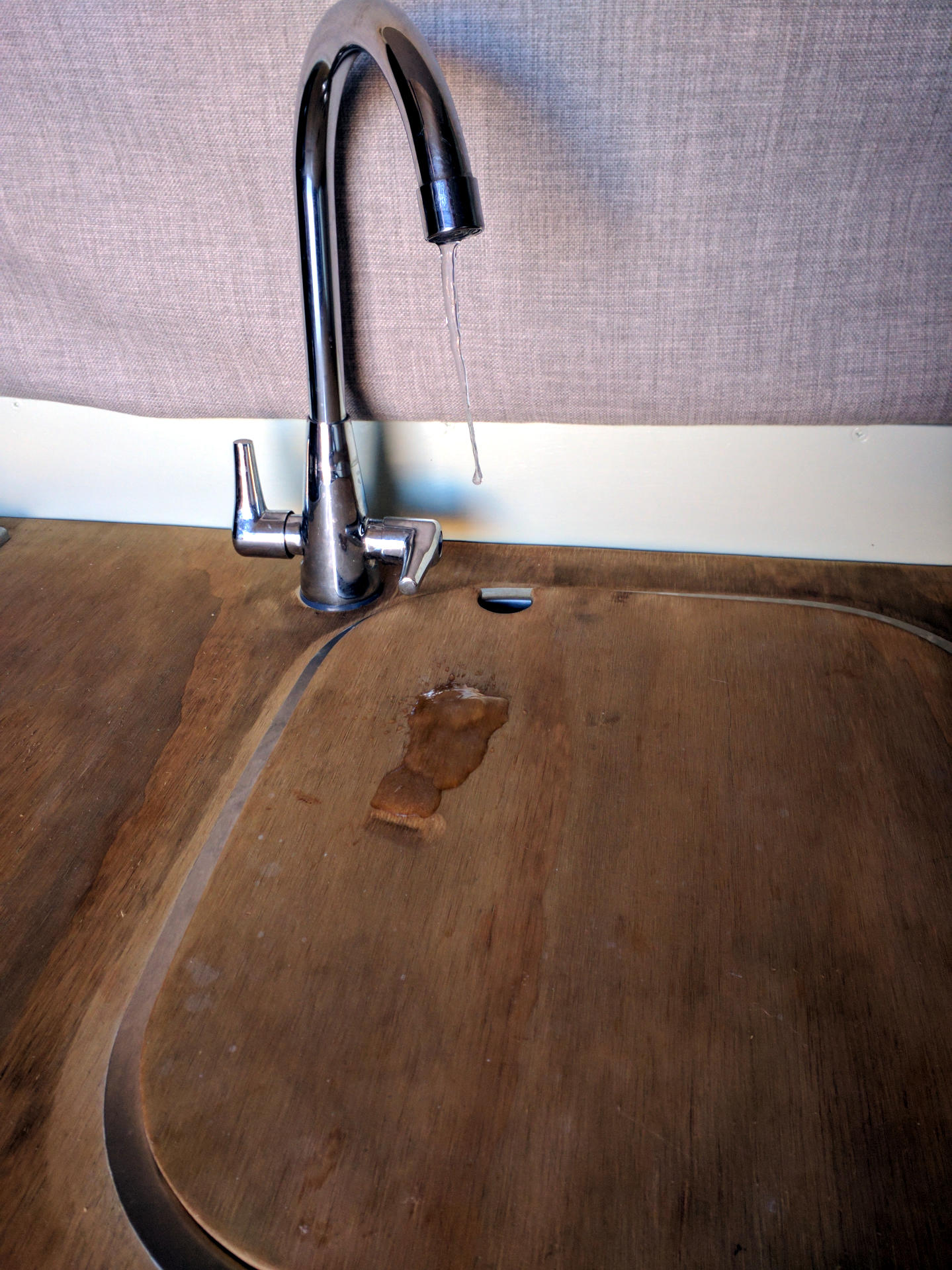

Went to the van this morning to find a little stalactite out of the tap - I always leave it open and typically control it via the pump on/off switch, so maybe a good thing here, who knows - I'll need to turn the heater on to thaw it all out to find out. It's all silicone tubing and the tank was almost empty so I doubt any real damage. (The hot side isn't connected to anything sensible)
Inside the living side was -2°C when I checked... So 2 nights out in it with the outside at -6 then come home and one more night and without me in it, it get a bit chilly... Hey ho!
-GView attachment 115886
It's the water in the pipes/pump/boiler that's the problem rather than the tank. Once the big freeze is over I would run the system and check for leaks everywhere and hopefully no damage done.

No boiler (yet) and the van is regularly in-use for 2 nights a week (next is Sunday night) - Friday is looking the warmest (only zero!), so I'll get the heater going to warm it all up and see what its like - I know there wasn't much in the tank (it's only 20l - more than enough for me for 2 nights) but maybe a good idea to pump it all out after every trip..
