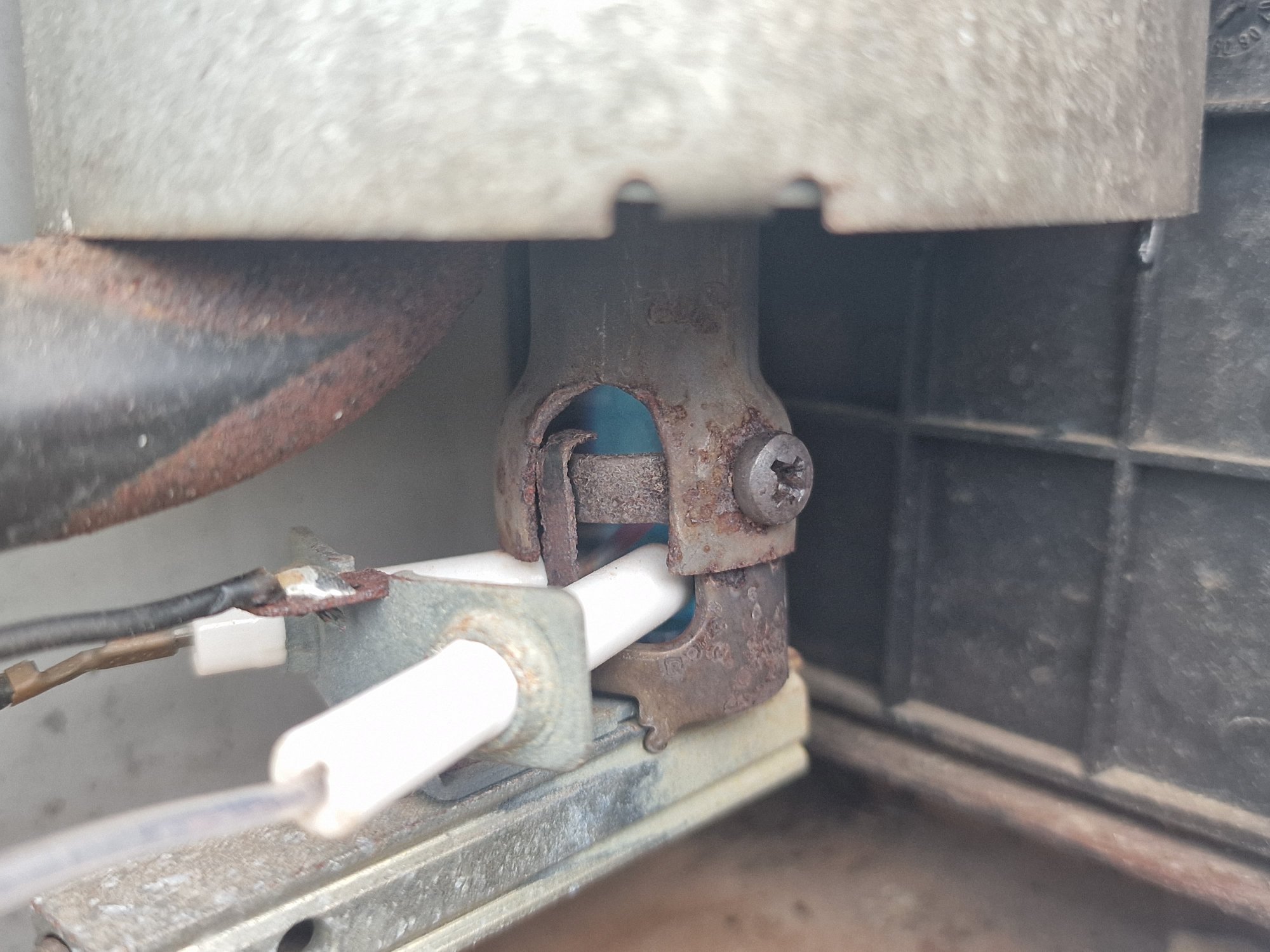

Above works fine on 240 volts, both freezer and fridge no issues. On gas, both won't work. Unit auto automatically switches from 240volts to gas, hear the clicking, then light stays on the front of the unit. Taking the outside cover off, can see good gas light at the botton of the flu and the flu feels warm to the touch. Any ideas before I commit to a replacement as I'm away fishing so use the lpg/gas option most of the time

3) Photo of "good gas light at the Notton (another typo for "Bottom"?) of the flu" please.

Wil, post picture when I get back from fishing this afternoon.

So I took the wind cover off to take this this morning. Freezer compartment sitting at 0bdegrees still
