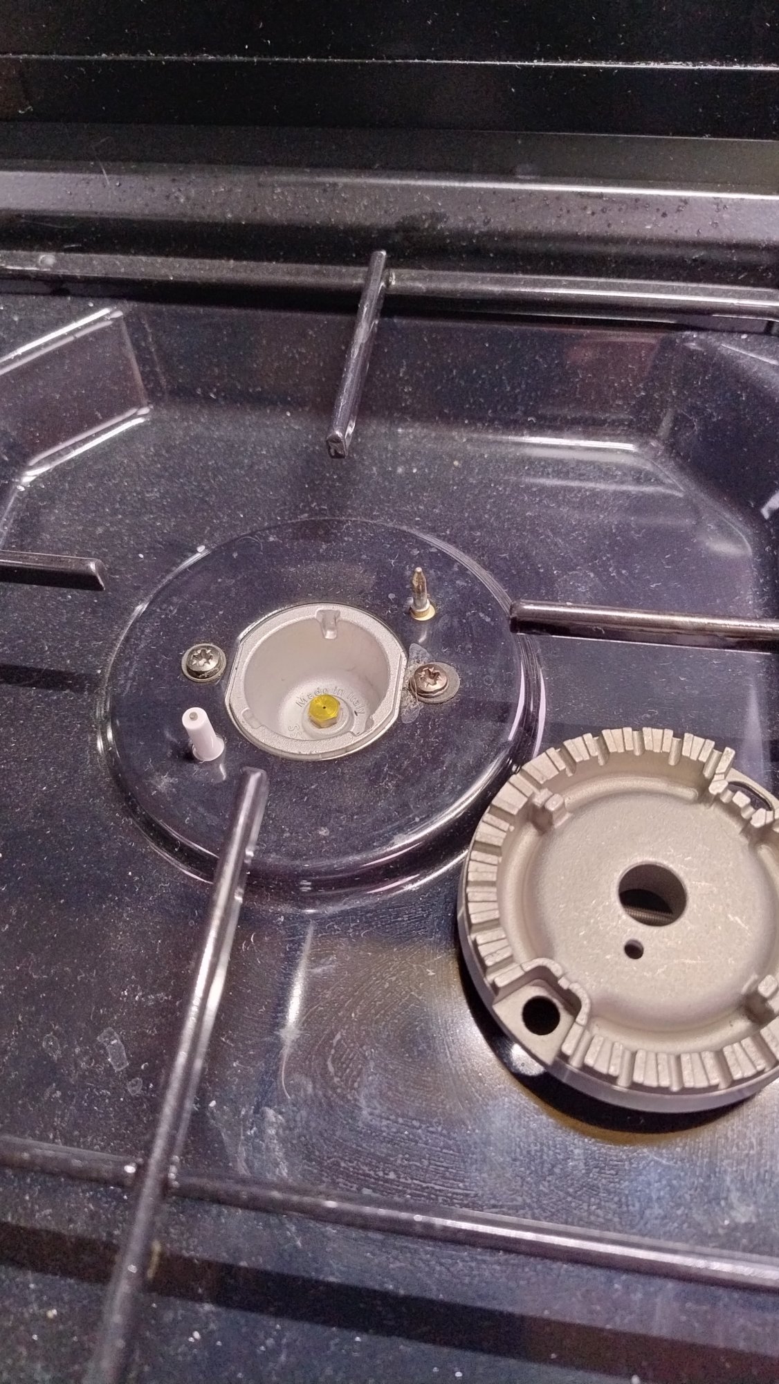

Three gas rings. Two work perfectly, they light first time with built in igniter etc. The third ring only agrees to light 50% of the time. When it does light, 50% of those times it abruptly shuts off after a minute or so. The rest of the time it works normally.
Causes? Remedies?
Thanks Gents. I'm not brave enough to remove the thermocouple (how even?) but with the van being newish the thermocouple looked very clean. Anyway, I cleaned it in situ, and (technical bit coming here) wobbled it about a bit, gave it a good talking to and so far so good. It
catches light quickly and is remaining on.
I usually resolve problems with the thermocouple by locating the connection under the ring and at valve, and gently wriggling them
