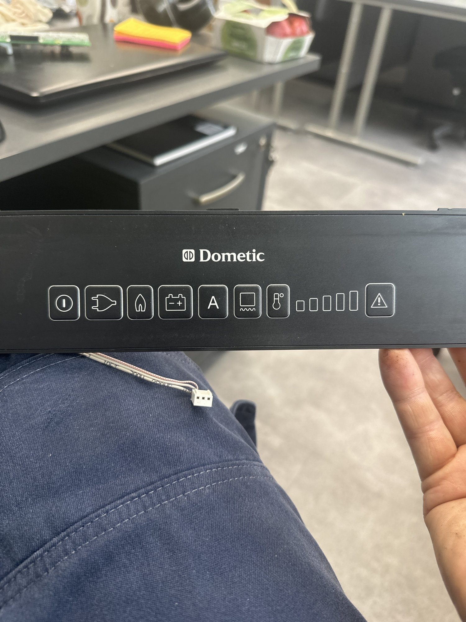

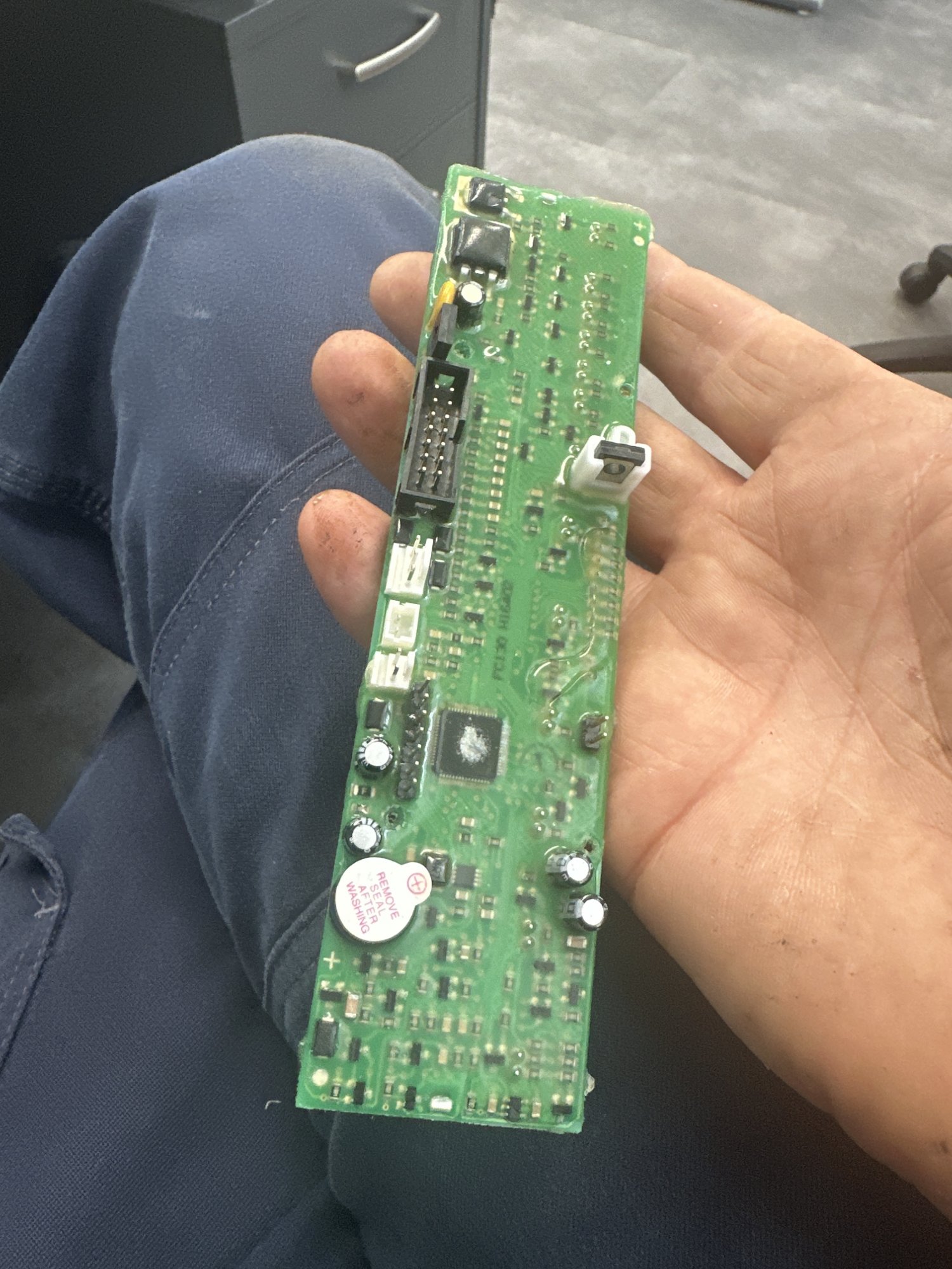

Hi Chris,
I’ve a similar problem with an RMD8505 Donmitec. I think the panel got damp because I didn’t put on the frame heater and I could see the water running down the frame. The fridge light wouldn’t work and now the Auto or mains buttons on front control panel won’t work and it defaults to gas. I turned it off and took off the panel to try and dry it out.
I see your fix but I don’t have a menus button. You’re simply turning off the AES function but I don’t see a menus button on my fridge.
I have panel buttons L to R,
Power on off,
Mains selector
Gas Selector
Battery selector
Auto or AES selector
Fridge/Freezer door frame heater
Fridge/Freezer temperature
Temp display
Then at the end there’s the alarm/reset button. I think moisture got in behind the panel to those selector switches. Do you know how they work as there’s no connection to the actual control panel.

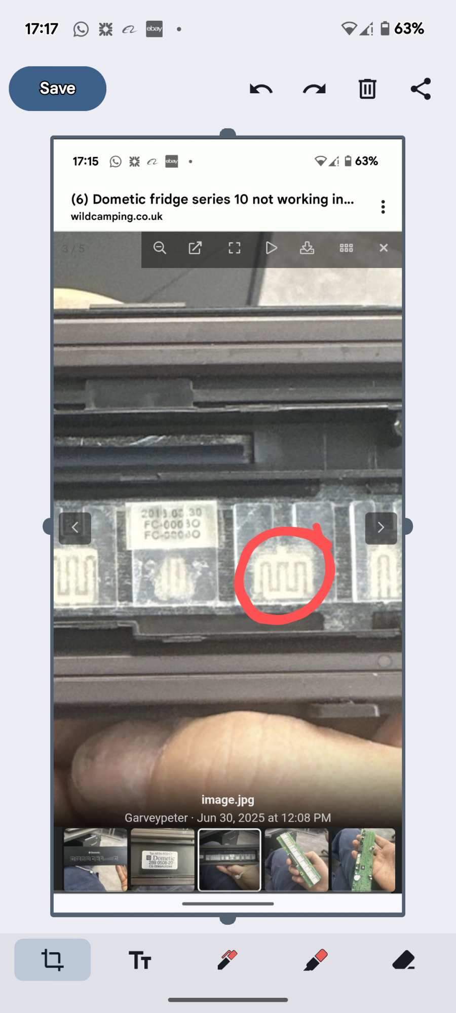

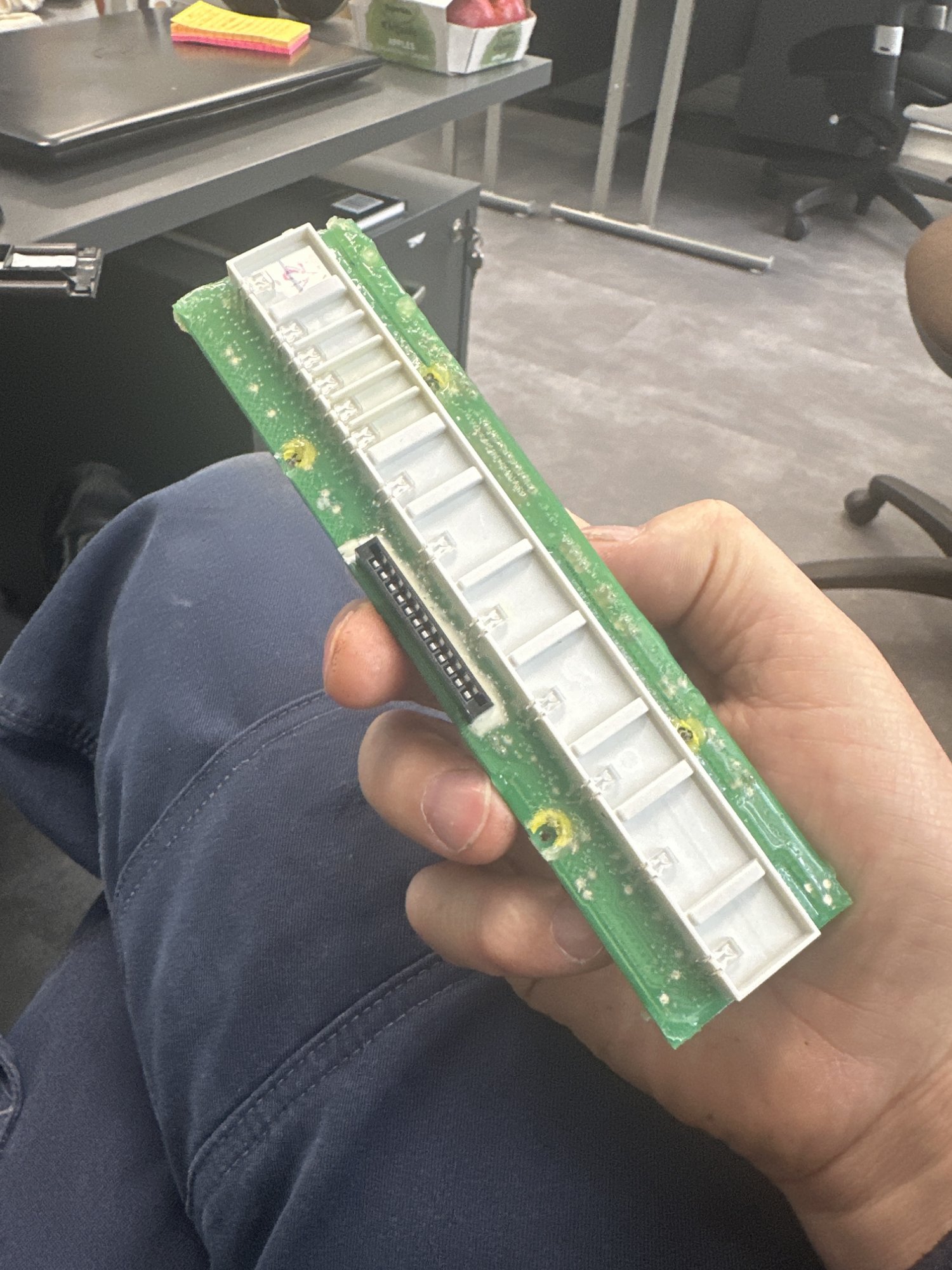

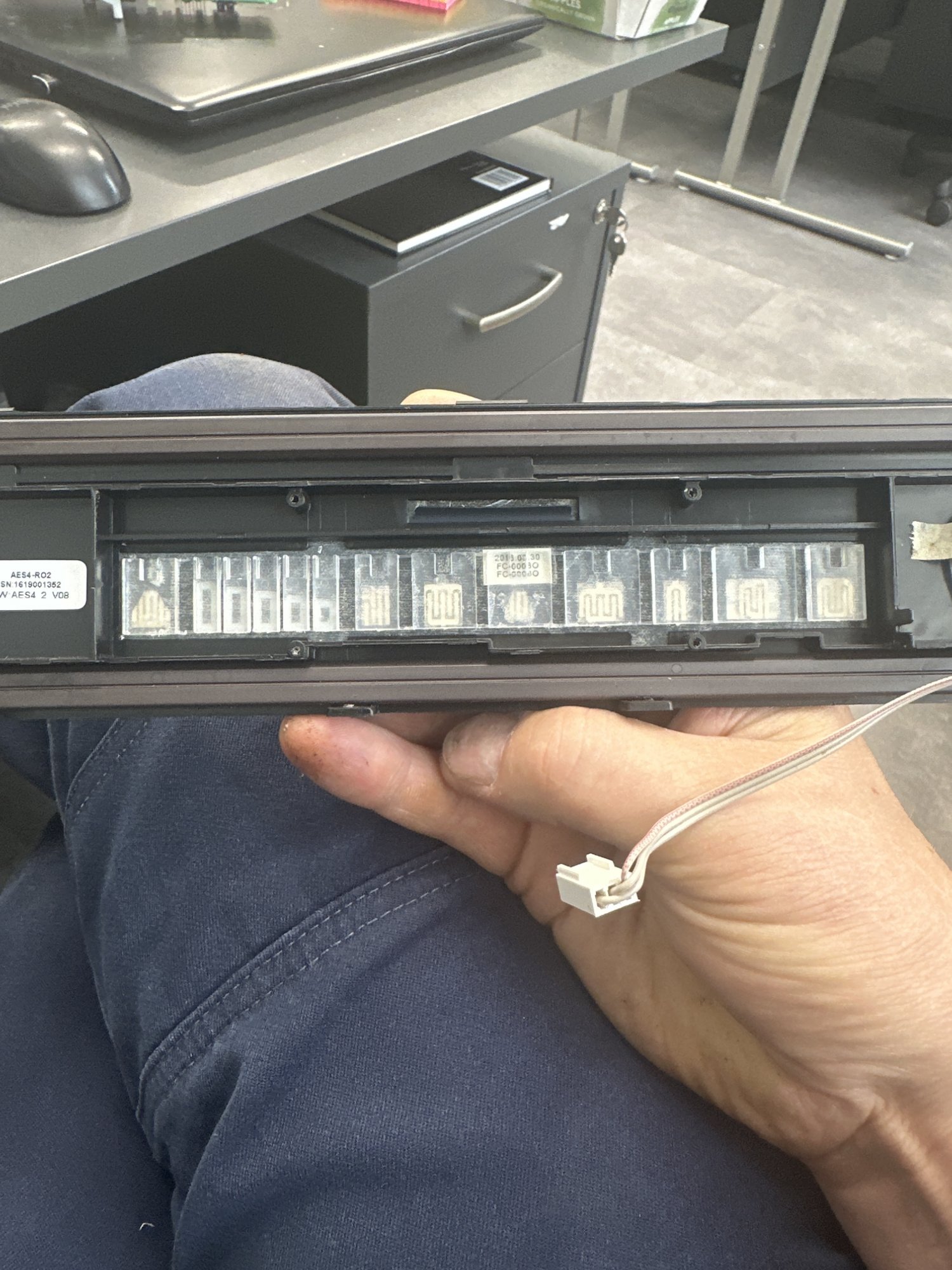

There's a pad that's disected into 2 separate parts by a zig zag line so the 2 parts don't touch. ( Shown in the red circle) There's a conductive surface on the membrane above, the conductive surface sits slightly proud until you press it, then the conductive surface bridges the 2 connections of the contact pad.
Hi Chris,
Power on off,
Mains selector
Gas Selector
Battery selector
Temp display
