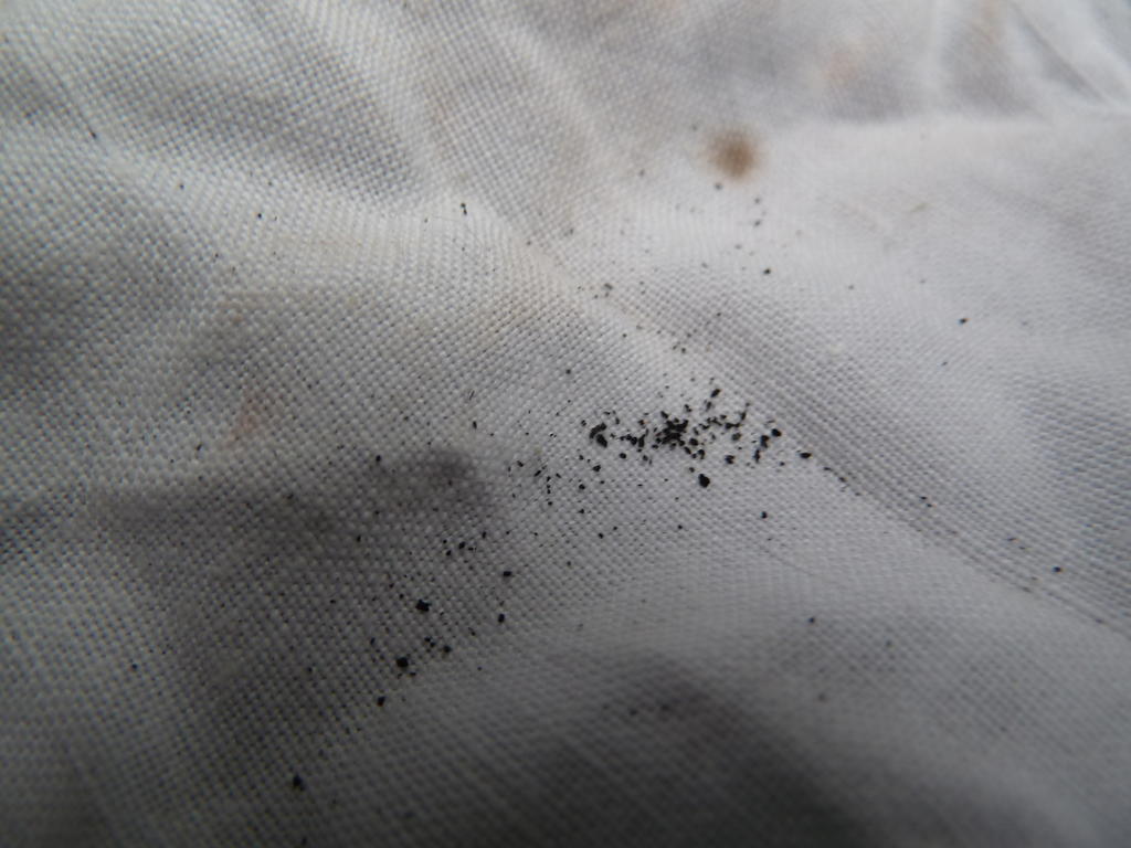

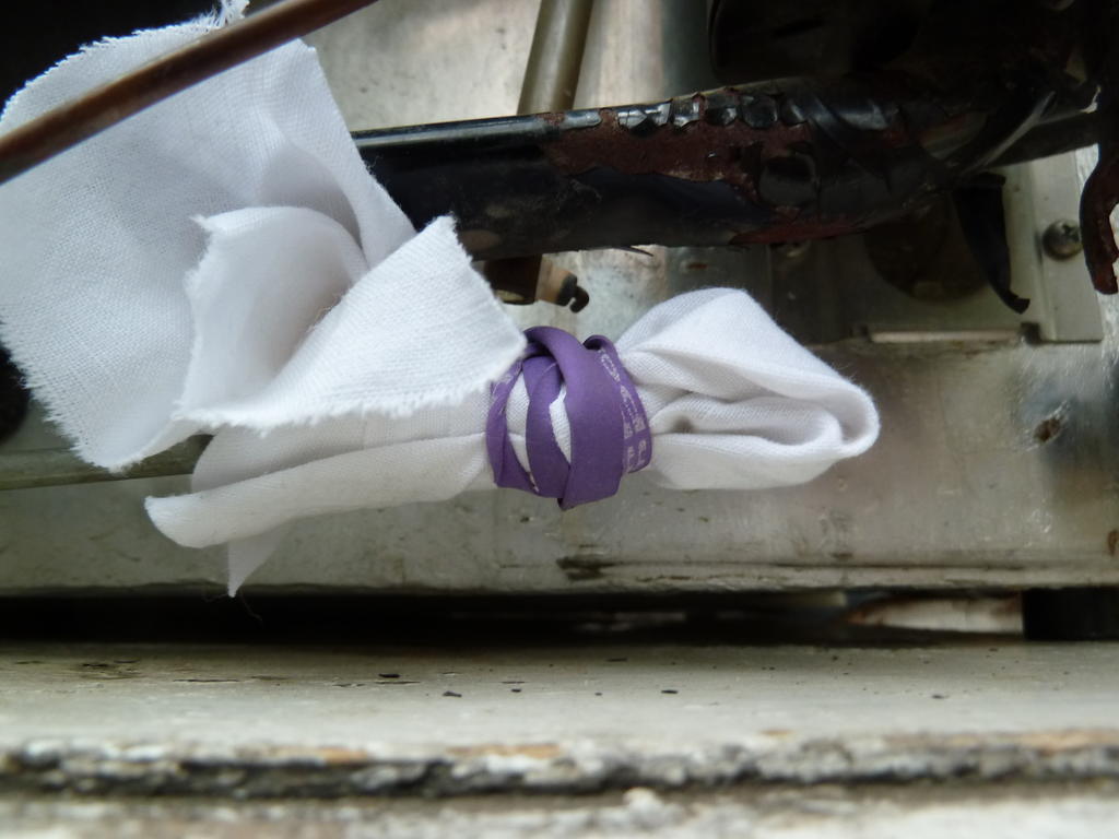

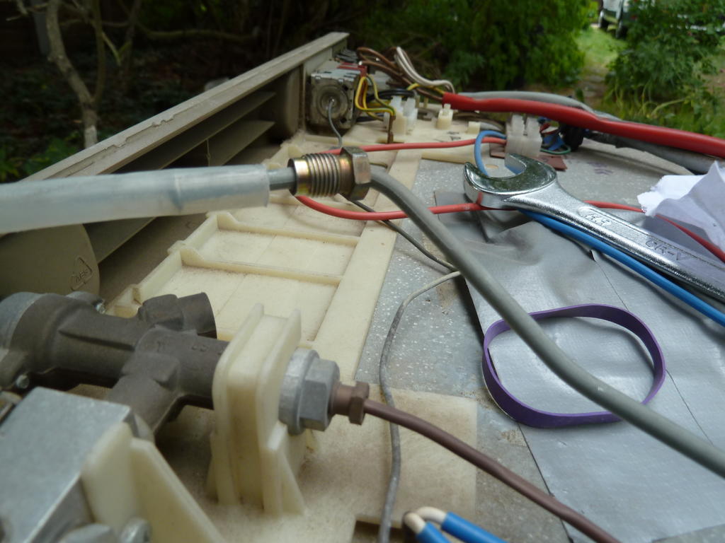

On our older vans a certain amount of shale? tends to build up in the gas pipes & driving on our pot holed roads shakes it down to the burner & partially blocks the jet. I use a strand of fine copper wire to clear it.
Recently I disconnected the pipe at the Thermostat, tied a bit of cloth at the burner end & blasted 200psi of compressed air down the pipe, amazing how much shite was in that pipe
