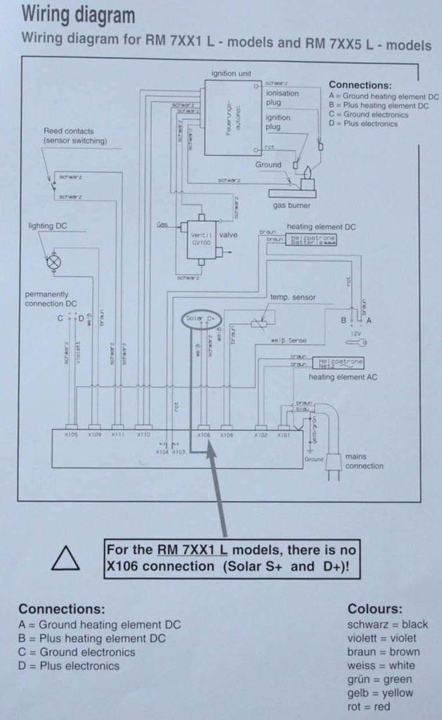

There's plenty to check when fault-finding.

Thanks again for all replies, especially the wiring diagram.
