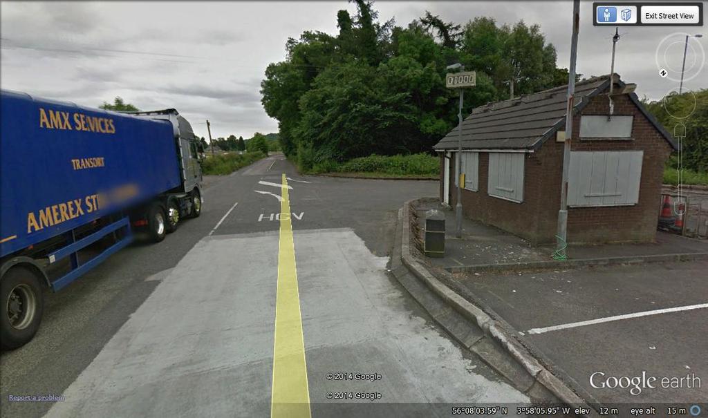

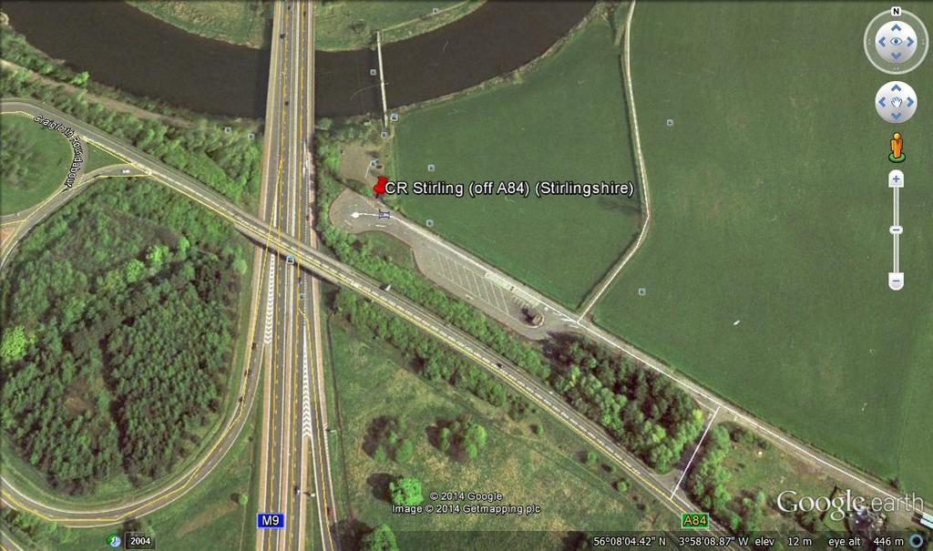

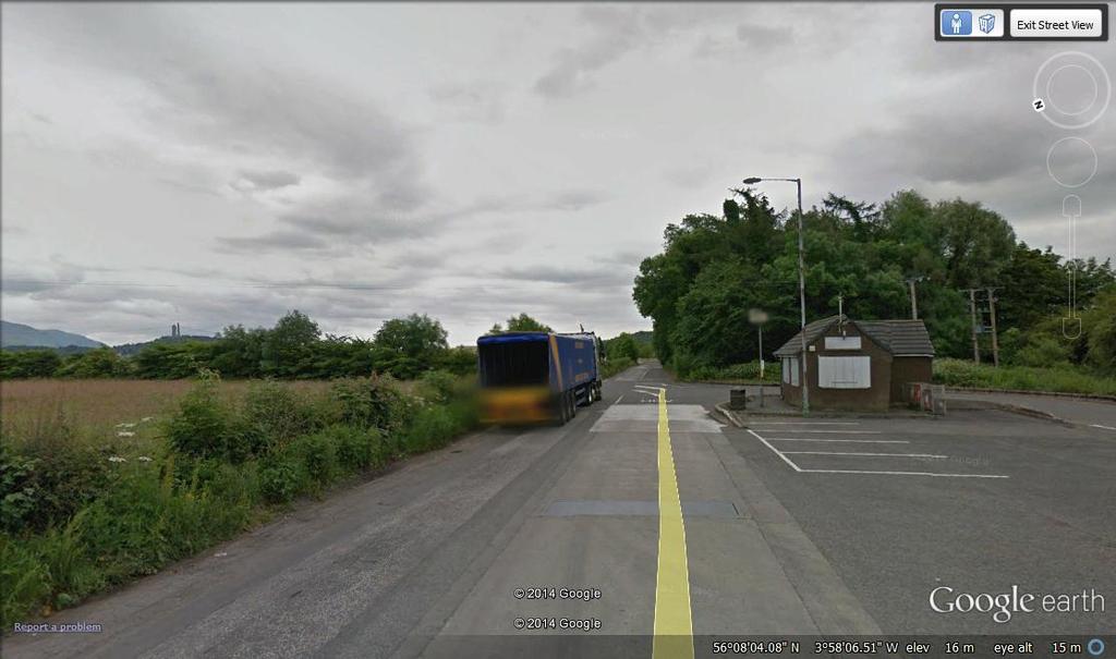

It`s a Self Weigh Facility and it`s free, just drive in and follow the instructions on the notice on the lamp post.
It`s off the A84 that crosses the M9 and it`s in the POI`s CR Stirling ( off A84 ) Stirlingshire
The last image shows the Plate that you drive over slowly
It`s a Self Weigh Facility and it`s free, just drive in and follow the instruction on the notice on the lamp post.
View attachment 26218View attachment 26219View attachment 26220
