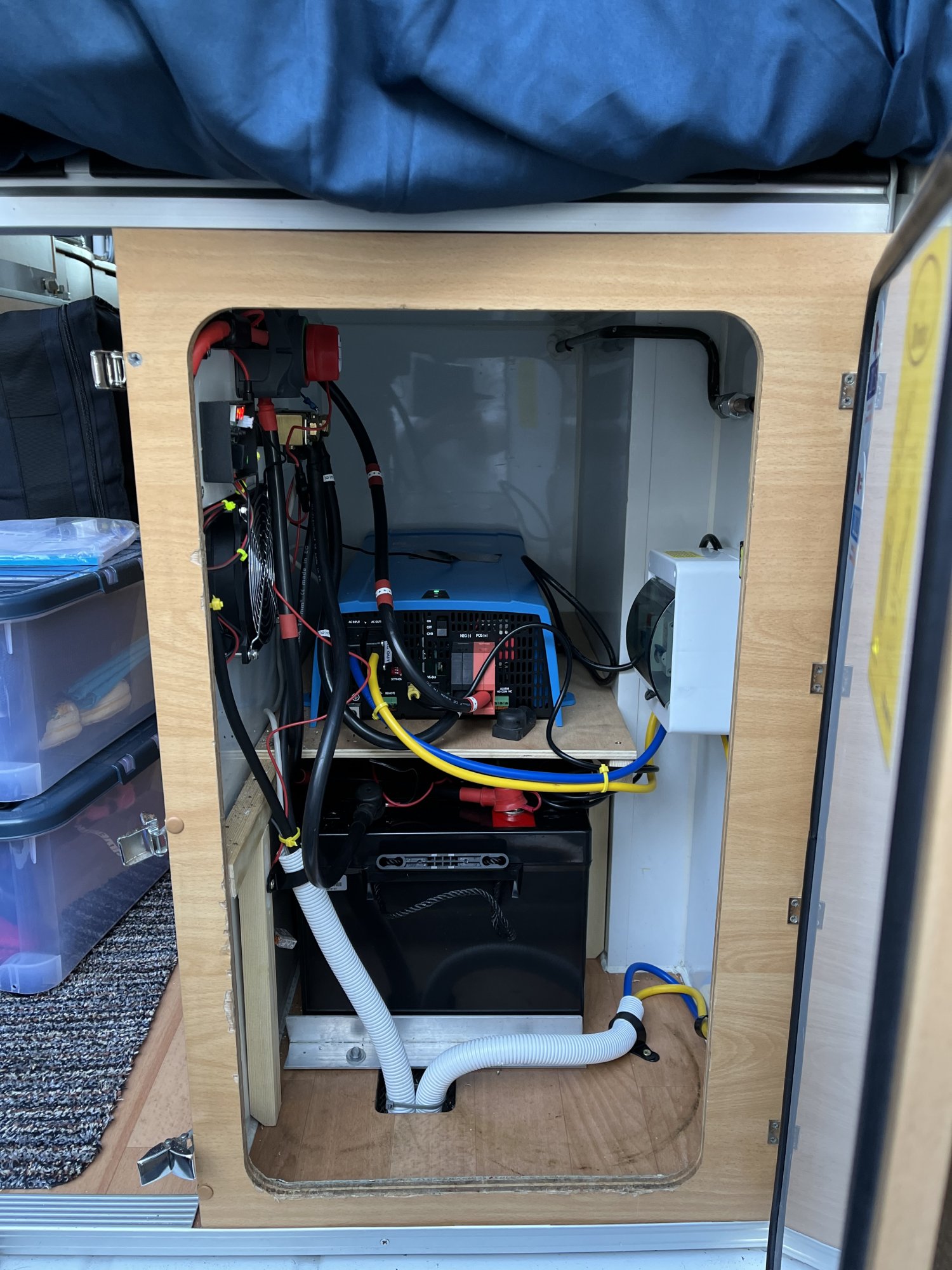

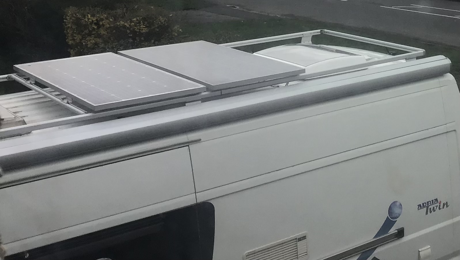

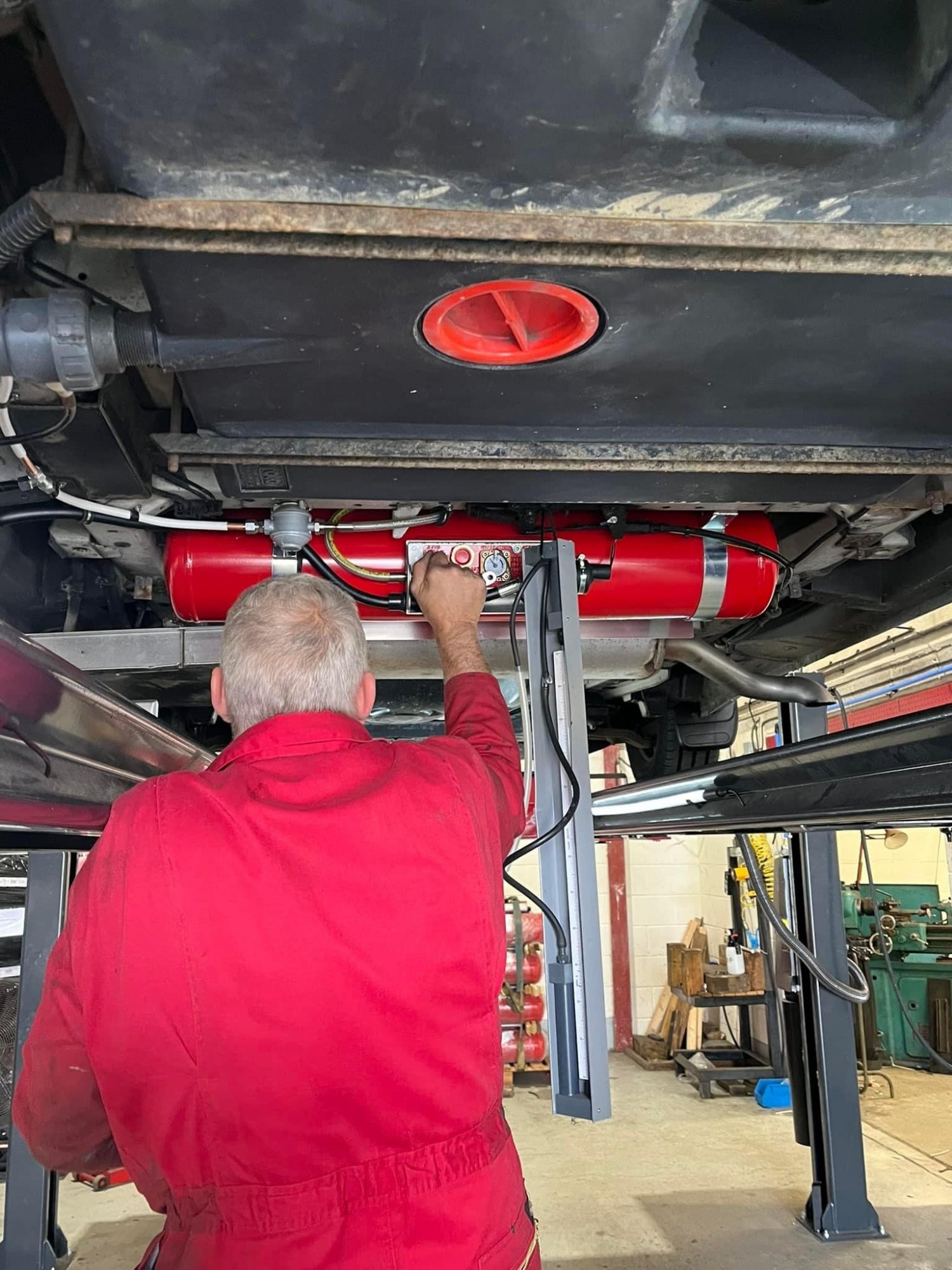

Mines an Adria twin 2009 I plumped for underslung lpg tank roof rack mounted solar panels and a lithium in what was the gas locker with the victron mounted on a shelf above the battery.
That bar holding the tank requires shotblasting and a repaint, get it sorted or i will wake you early every morning. 😂
It is black when they finished mounting it it gets two coats of an anti chip stuff and I take back for an inspection every 12 months so all is fine but thanks for caring 💋
