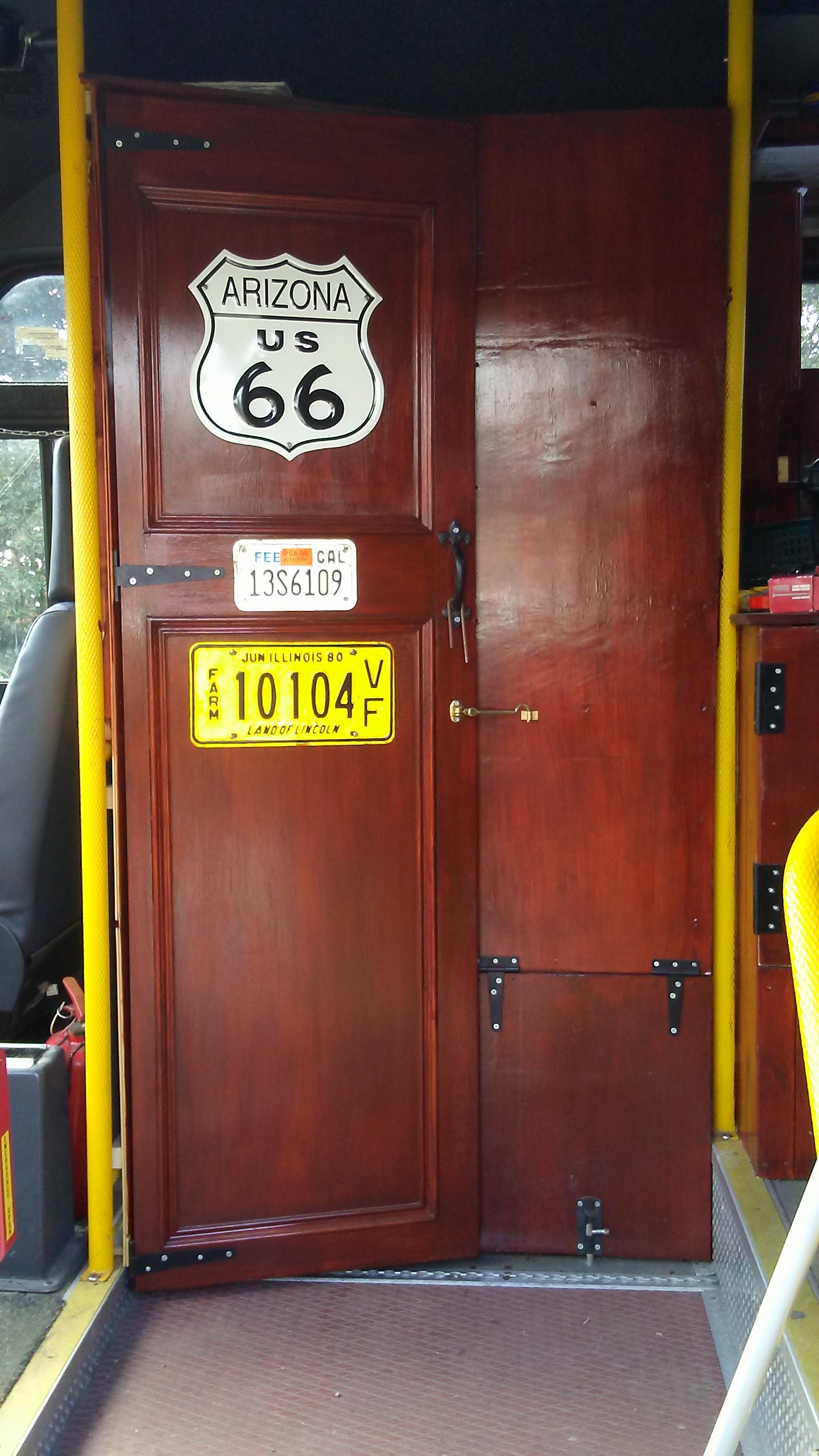

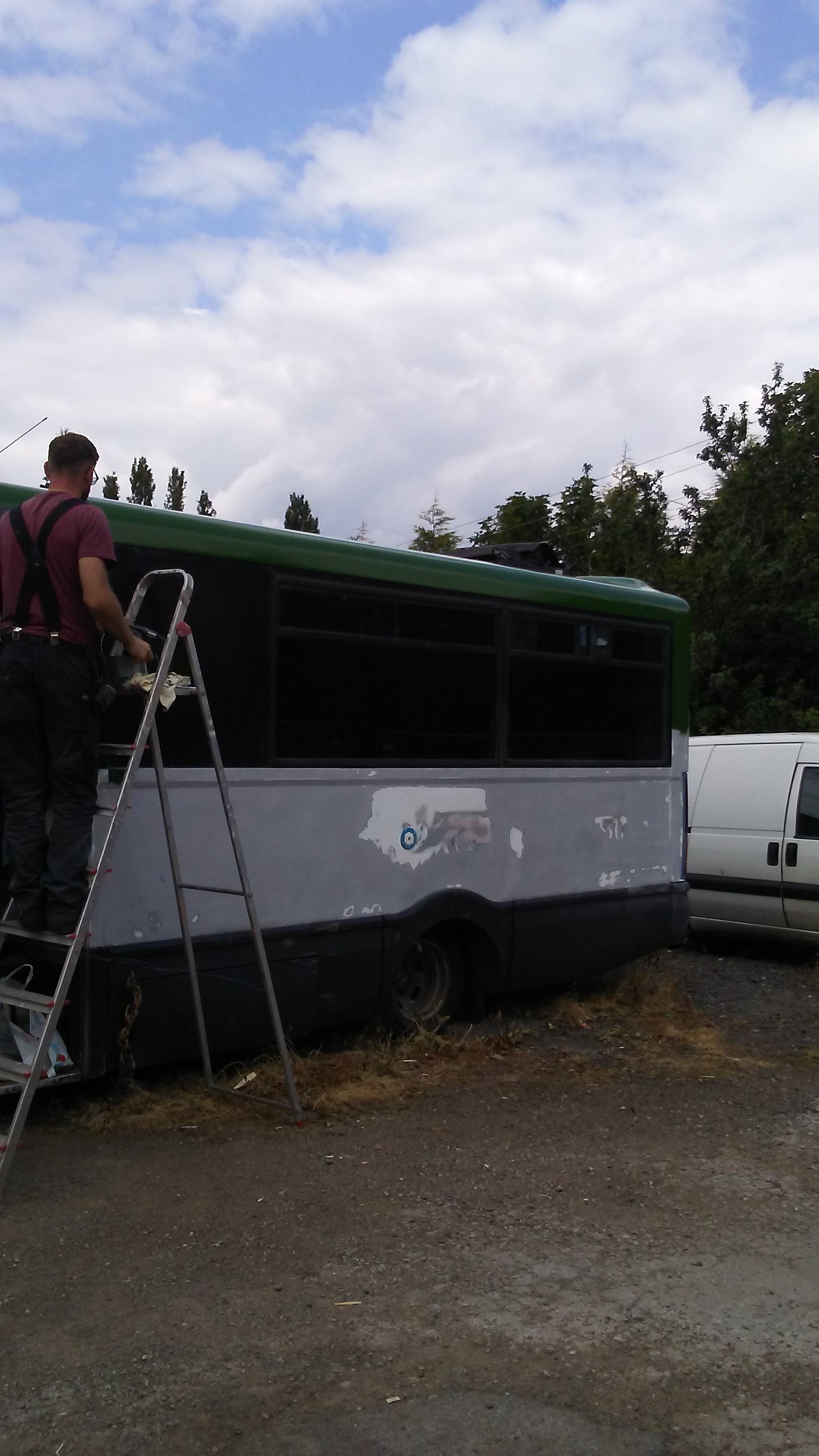

Just finished my 5.5tonne I've go self build. Been at it steadily since January, & took it for mot yesterday. Passed with no advisories & mot man says it's very tidy underneath. Been a council welfare bus before I got it so well maintained & serviced regularly so all in all, quite happy now.

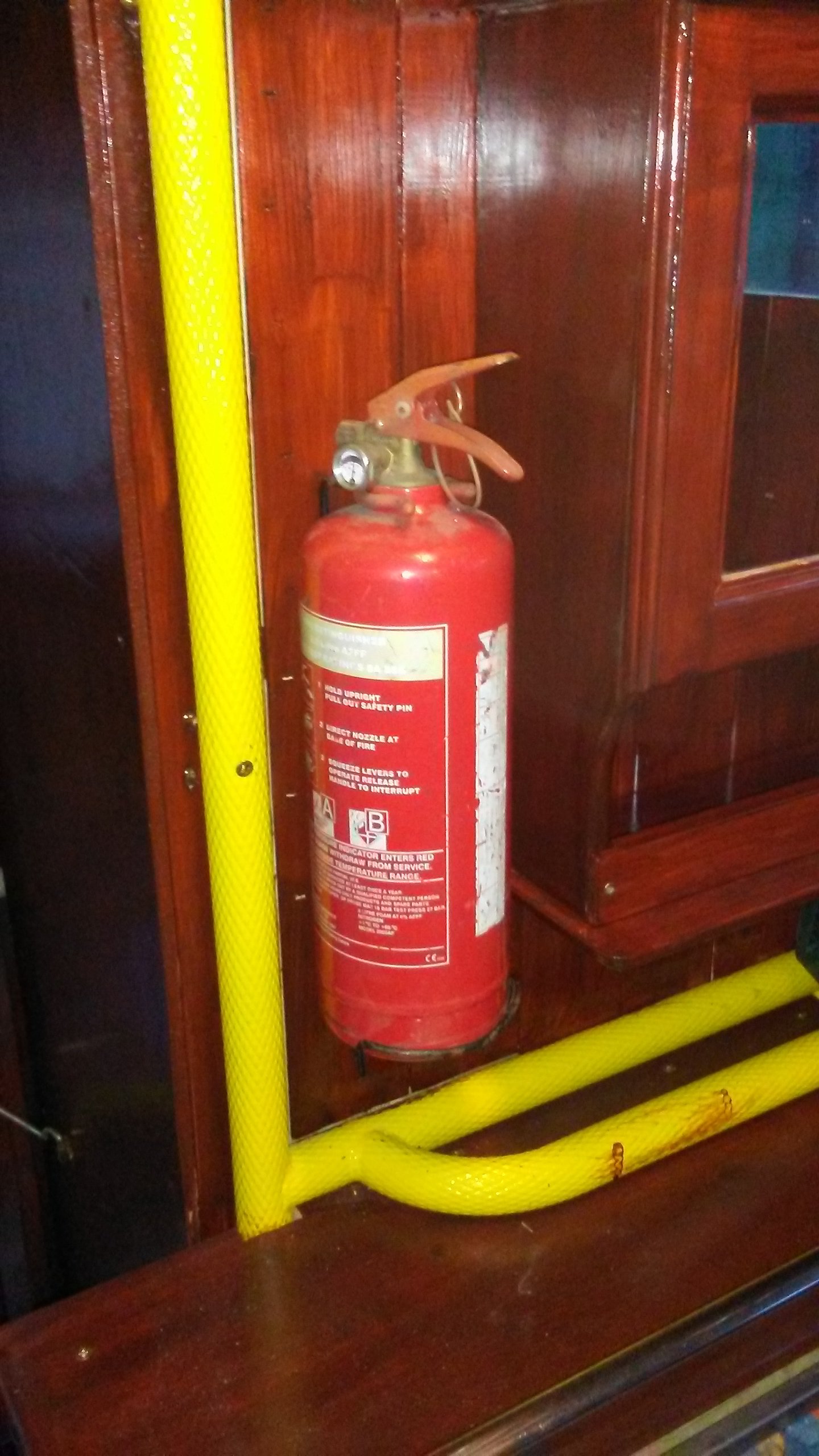

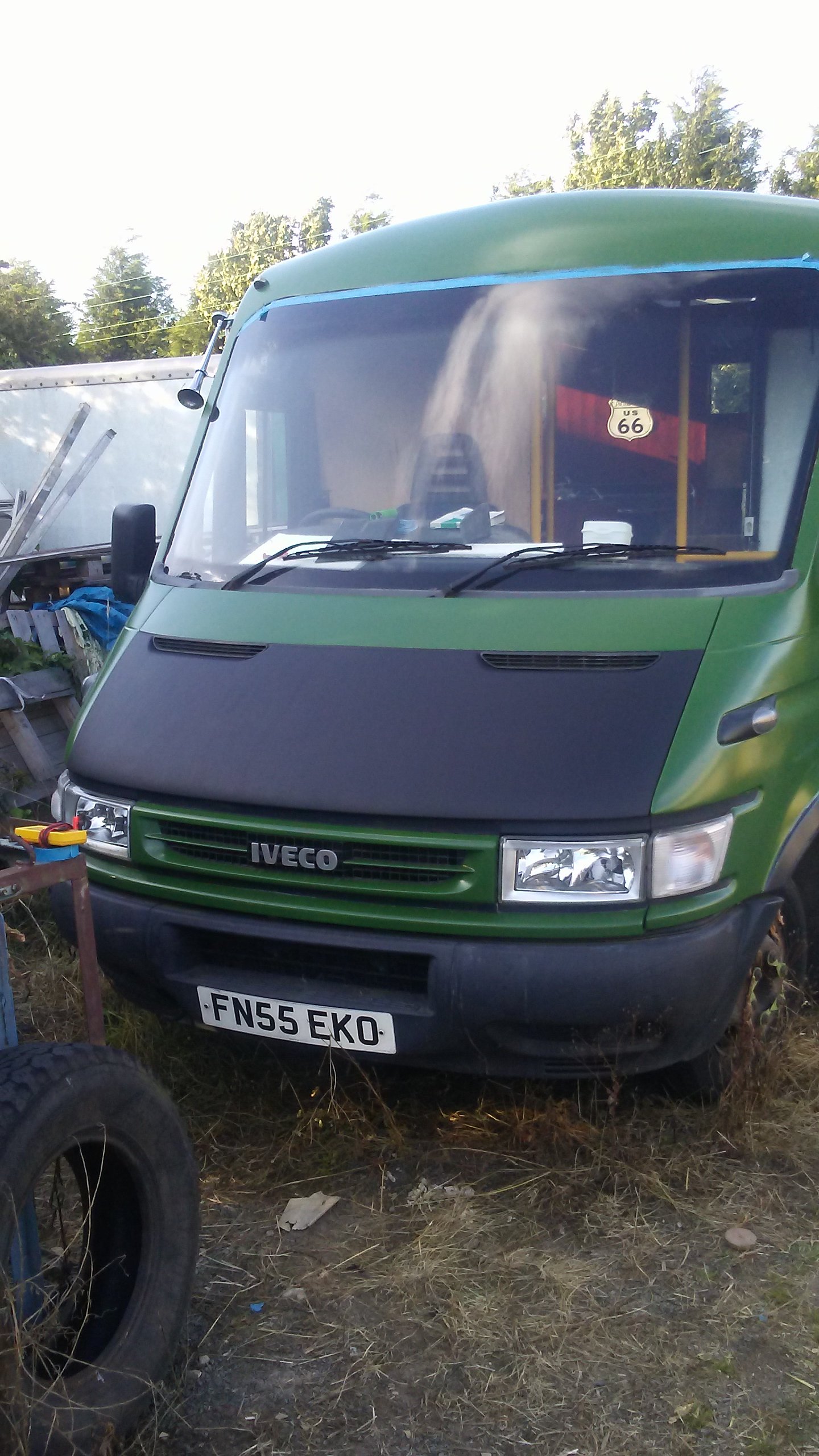

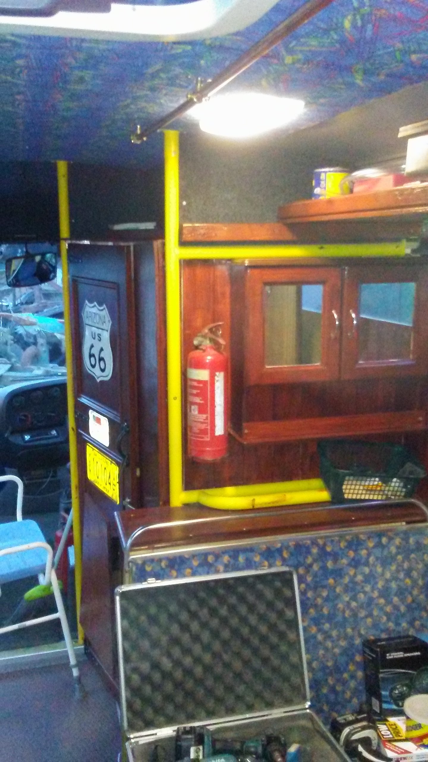

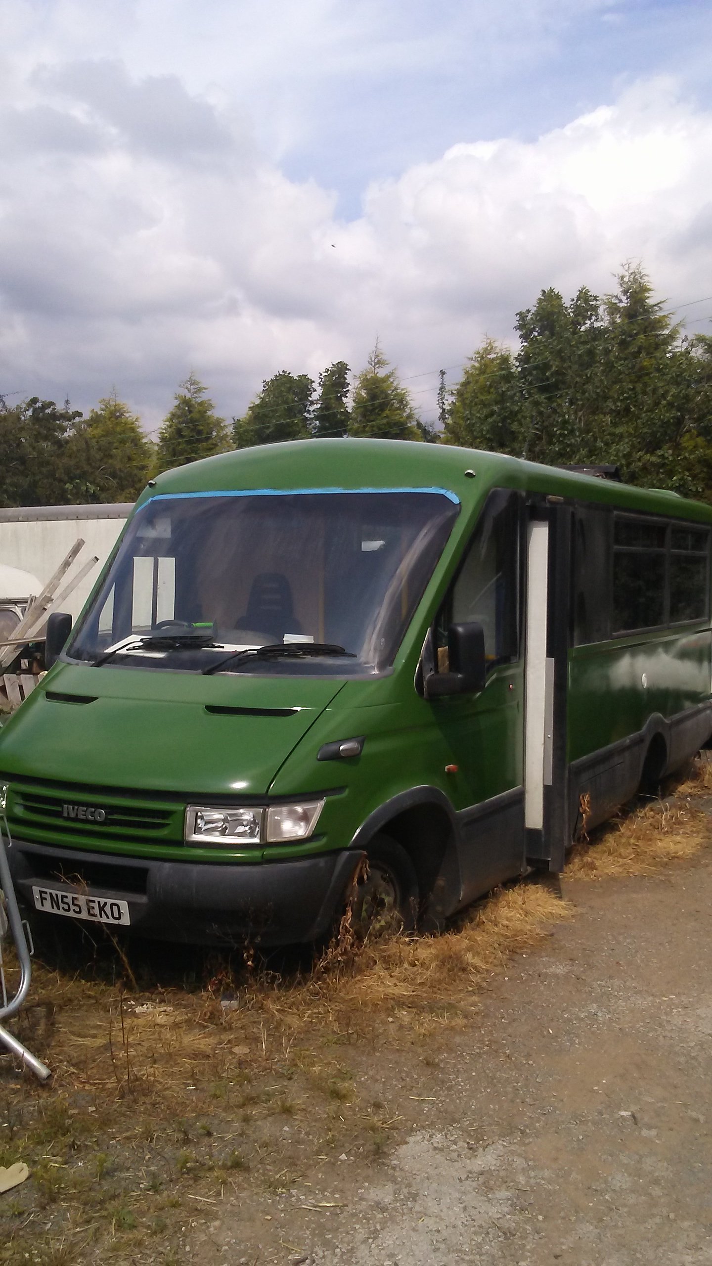

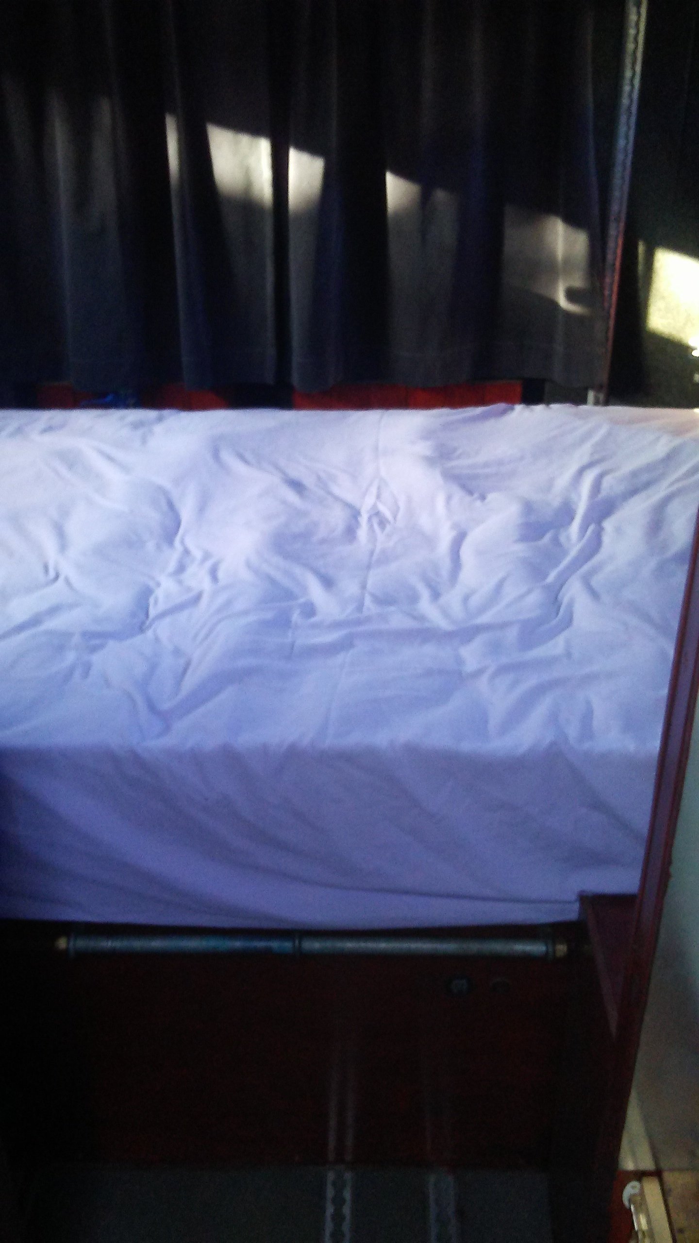

Few more piccies for your perusal

Well done, truly well done and now you can start to enjoy the labours of your efforts and you can start planning the holidays of your dreams.
Have you by any chance changed your V5 with the DVLA?
All the best
Phil
Thanks Phil, getting good feedback from all who have seen it so far. Not changed the logbook yet, taking the photos tomorrow if it doesn't rain then sending the docs off this weekend. Fingers crossed, sounds like I might have some problems with the change. Everything is done as laid out on the govt website right down to the letter, but still not sure how it needs to look like a motorhome! Watch this space....😏
Bottle Green.....absolutely love it, I have heard that people are having problems getting the log book changed, no idea why, but good luck to you. (y)
Was originally going to be mid Brunswick green same as a truck I drove in my youth, but actually ended up light Brunswick which is nearly identical to John Deere tractor green, so I'm happy with the result. Looks very good considering it was applied with a 4" brush!....
Looking good :) fingers crossed with the reclassfication (y) (would have been a done deal 2 months ago but who knows now!)
Well done Gregg,
Just take some good photos relevant ones,
Write them a letter to go with them saying as per my legal requirement please change my V5 to Motor caravan. All aspects of your current advice on motor caravan construction have been carried out.
Don't worry about demanding it Gregg if they are going to refuse it they will refuse it anyway, but I'm sure they won't, if they do you can always blame me for bad advice. 👌🤞 Phil
P.s. By the way the legal requirement is on you to change the classification just as much as it is theirs.
I'll definitely try & get it changed just to keep everything right, but have to wait & see. If they don't change it at least I tried....
