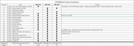

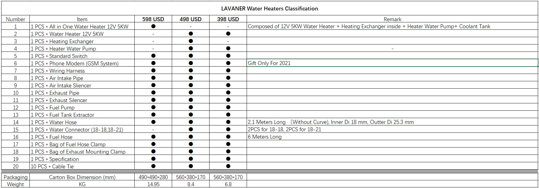

Good Idea, here for everyone as below

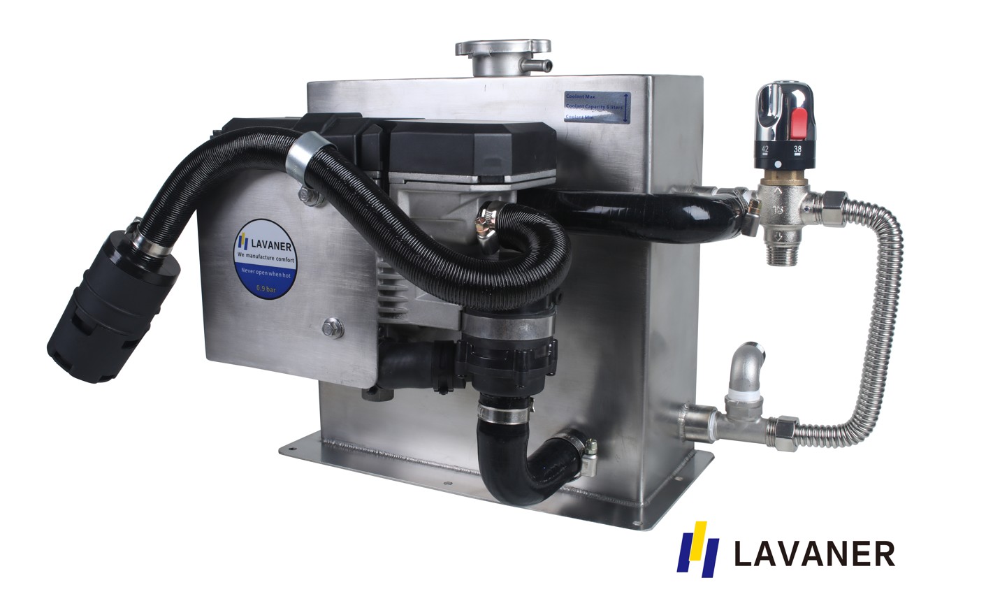

Youtube Review Video of LAVANER Pro 12V 5KW All in One Water Heater Made by Mr. David McLuckie
Test-Review: https://youtu.be/6_aqWHW6hDY
