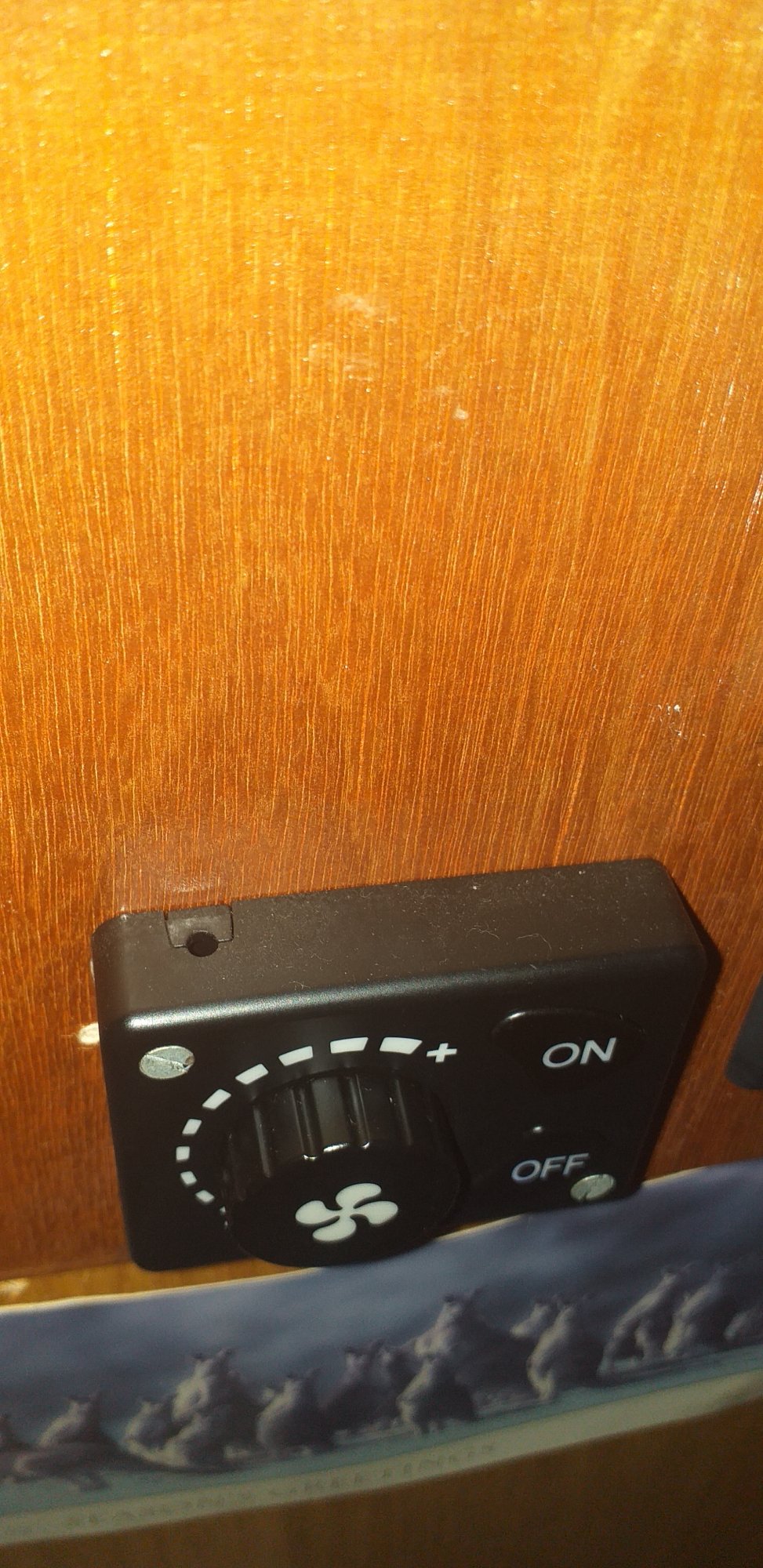

Yep thats what £70 got me a fancey head unit . But it gets to hot in van.
Just swap your lcd controller for a rotary one off Ebay at about 12 quid, they have a temperature sensor inbuilt (hole at top).
Note that the connections may be different. The LCD controller has a 3-wire connection loom. The Rotary controllers usually have a 5-wire loom and different signaling to the electronics within the heater.
