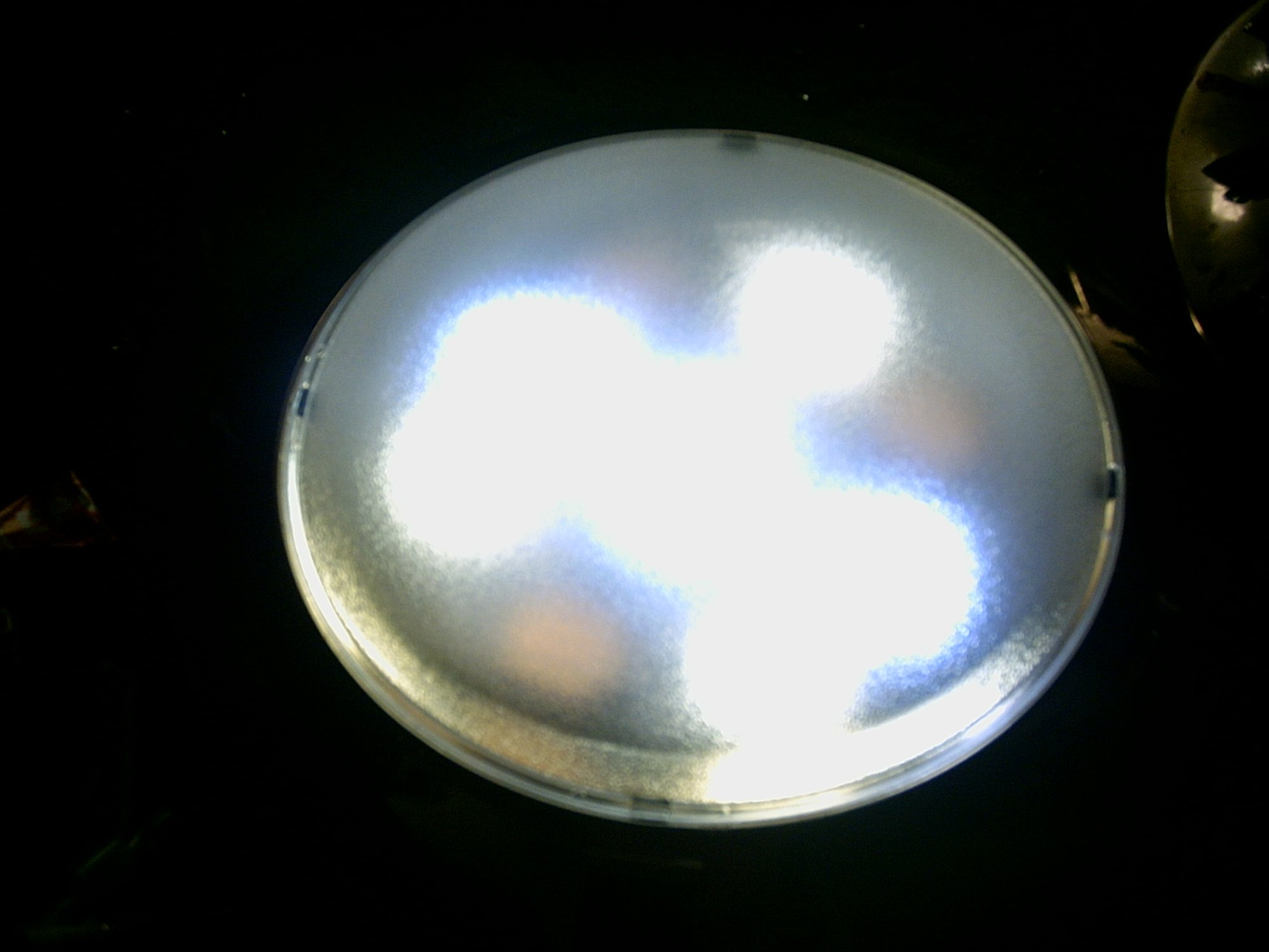

Now that's a really good idea which I'd never thought of. We have four G4 side lights that we never use because I suspect they use too much power. They seem really easy to change. Anything I should be aware of before I order some? Thanks.If the lights and tubes are still working ok I would check what power they actually use before doing anything. I changed one in the kitchen area on my van for a led tube, tube cost 30 odd pounds a few years ago and it uses virtually the same power. I didn't bother changing the only other one which is over the bed.
I changed all the G4 type bulbs and did get a power saving on those, just didn't stack up on the fluorescent tubes. Of course, no saying yours are same power as mine
Just soft or daylight,thats all.Now that's a really good idea which I'd never thought of. We have four G4 side lights that we never use because I suspect they use too much power. They seem really easy to change. Anything I should be aware of before I order some? Thanks.
ThanksJust soft or daylight,thats all.
Done them. Replaced the original halogen ones with 1.2W LEDs that work a treat and I feel can be used freely without hammering the leisure battery. Just had to be careful with the length of the bulbs because many of the LED ones were longer than the halogen ones, and there didn't seem to be much spare space in the fittings.Just soft or daylight,thats all.
Hi, I have the same issue could I ask if you have a link for the 1.2w LEDs and are the a warm glow? many thanksDone them. Replaced the original halogen ones with 1.2W LEDs that work a treat and I feel can be used freely without hammering the leisure battery. Just had to be careful with the length of the bulbs because many of the LED ones were longer than the halogen ones, and there didn't seem to be much spare space in the fittings.
A huge improvement. Many thanks for the suggestion.
