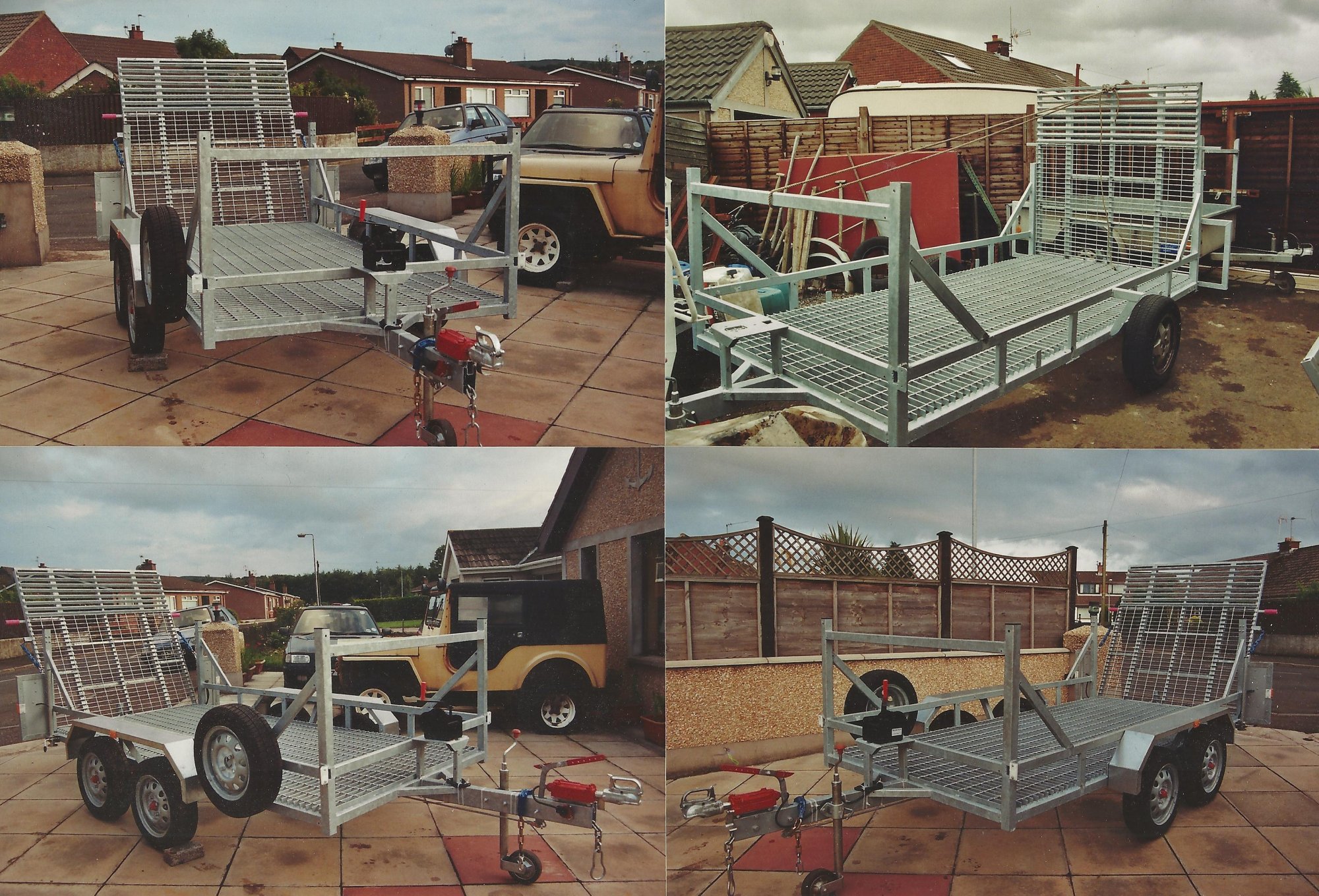

The trailer regs would have stopped all home build jobs, im guilty of to boot.View attachment 124102View attachment 124103

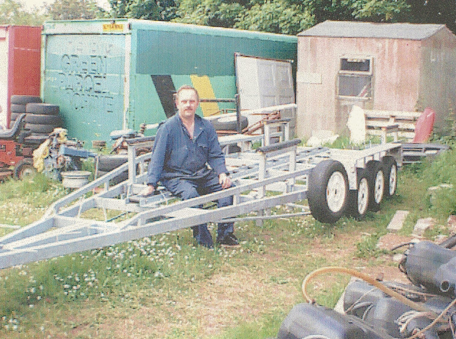

I built that we mesh floor trailer for a chap to carry a ride on lawn mower, one of the larger kubota types, it also had provision for a upper deck if required, all was shotblasted and hot dip galved, i dont do half jobs.
The boat trailer is for my Norman 23 which is in use with me.
