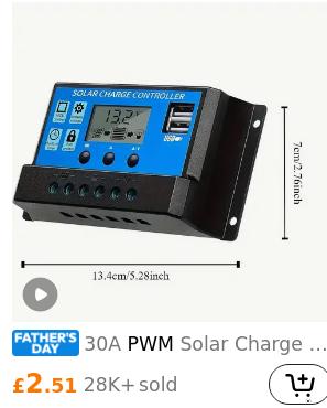

Whilst PWM's are certainly not as efficient as an MPPT Trev they certainly aren't useless crap and many people have had good results from them on budget systems.
Bet you dont drive a old ford 100e, they did get you from a to b LOL, point is they are well outdated and in no way do the best job for a battery by a long shot.
I wish I did Trev!
PWM's do a job at a small cost. Depends where and when you do your travelling.
You can buy a PWM 20a mp controller for around £10 the equivalent Victron with Bluetooth will cost around £65. But the Victron will increase efficiency by around 30%. In lower light conditions this figure can be even higher. Thus for £55 you have not only increased efficiency, but bought a piece of equipment which will also extend the life of your batteries, and offer better control. Yes PWM controllers may initially be cheaper to buy, but I would argue that the Victron is more cost effective. But PWM controllers are not a piece of crap, just cheaper to buy for seversl reasons, more false economy.
One other point, cleaning your panels regularly is important. I clean mine every couple of months.
