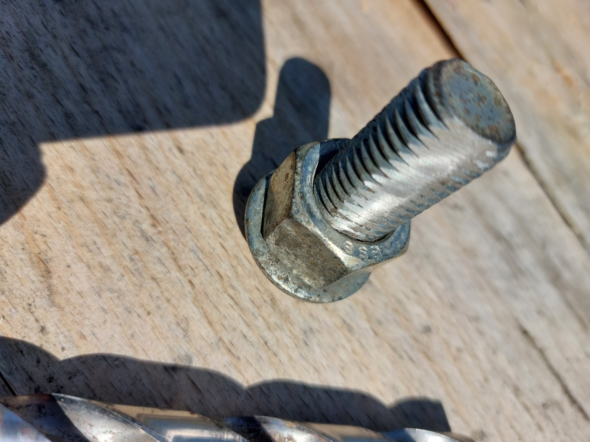

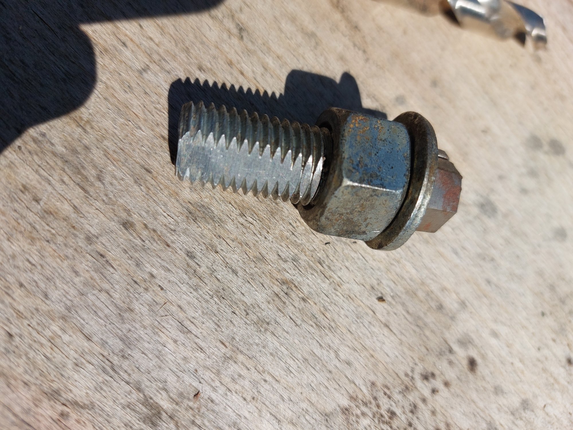

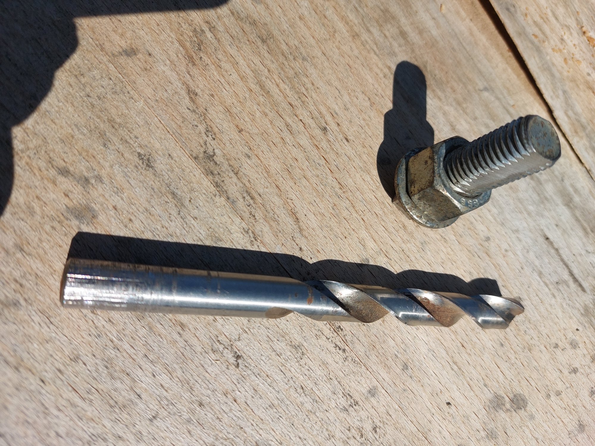

This is how 12mm drill bit, drill plastic out take your time then pick out the thread use very small screw driver bend the end so you can get some more out then use the bolt working in and out slowly. Bolts a bit of lash up but it works done this sort of thing many time over my life time
Pretty much what I said then.
I've used a 1mm cutting disc to make a tap out of an old bolt many times, one cut is enough, very useful to put a thread into wood or plastic too.
Brill, 66 years on the planet and never seen that done before! Never to old to stop learning eh (y)
I bet you have too, we all have I suppose not always able to put them into practice though.
