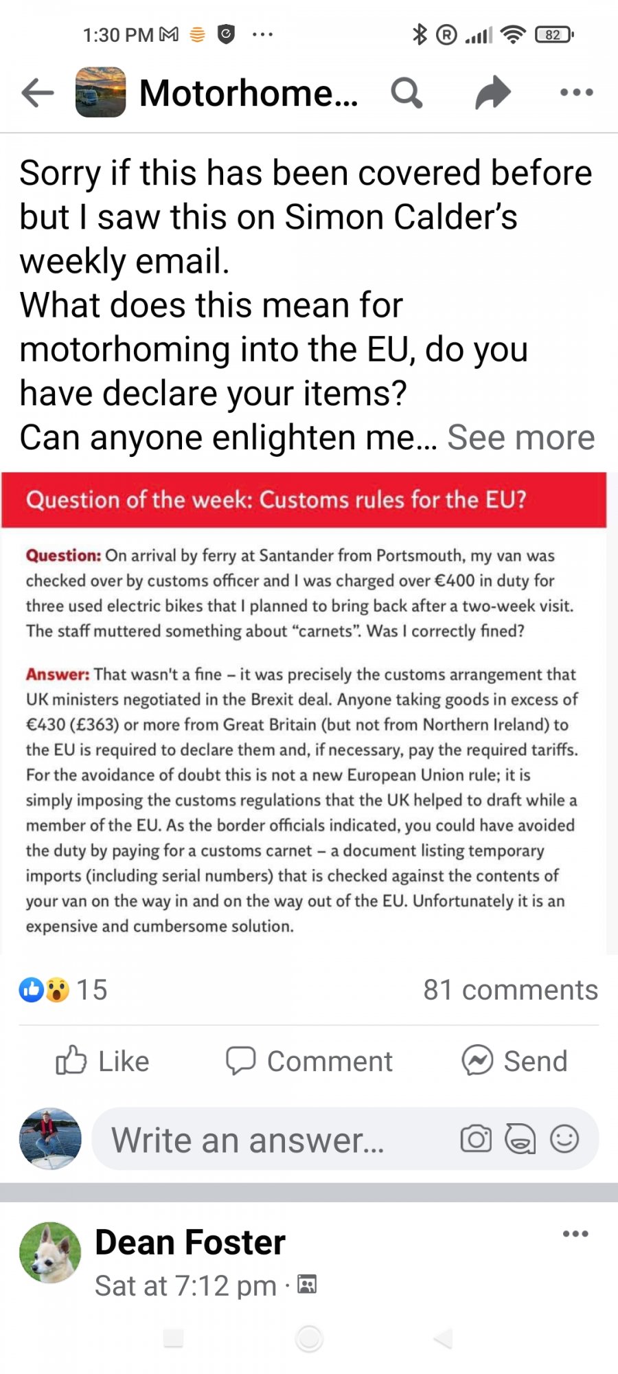

I've just read an article that a motorhome was searched by Spanish customs at arrival in Santander.
The owner of the motorhome had to pay a substantial fee as he didn't have a carnet to cover the two electric bikes he had in his motorhome garage,
According to the article you have to have a carnet to cover any goods over €430 for temporary import.
Given that I take an electric bike plus a 125cc Honda Scooter when I travel to europe, I'm wondering if anyone has gone through the process of getting a Carnet and can shed some light on how to go about it. Searched Google for answers but it is confusing.
Would I only need one for the electric bike only, as the scooter has a V5 that I take with me as well as insurance or do I also need one for my scooter. Thanks for reading, hopefully someone can shed some light on this.

It appeared on Motorhome Madness and there are various comments from the usual Facebook experts, master of none. I rather know other people's personal experiences if this is necessary and if so, how you went about it.
I'm thinking you maybe need a carnet if you are temporarily importing something for business use as opposed to leisure use.
Otherwise it's going to get silly, as my mobile phone, tablet, laptop and many other things valued over the amount set would have to be declared.
In the report @Mobilvetta linked, Temporary Admission might be available. However, further investigation would probably be needed before committing you and your stuff to hostile foreign customs! From close to the bottom of the linked page:
  • As an alternative to an ATA carnet, Temporary Admission may be used to temporarily import items such as laptops into the EU, provided the relevant conditions are met. The management of EU import and export procedures is the responsibility of the customs authorities of the Member States. It is important that individuals and businesses confirm the processes at their port of arrival and any conditions or procedures that may apply. Information can be found at: https://ec.europa.eu/taxation_customs/customs_en. Information on Temporary Admission procedures in the UK can be found at https://www.gov.uk/guidance/apply-to-import-goods-temporarily-to-the-uk-or-eu.
