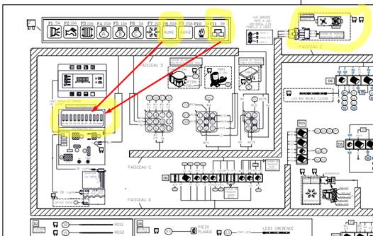

The Chausson 640 2022 from France that we have doesn't have separate Webasto fuses anywhere. But, Thank you for the ideas - I emailed Tyne Valley (who made the video) as well as Chausson. Tyne Valley was amazing and got back to me right away - they suggested that I remove all fuses from the technibox fuse holder, wait 20 min, reinstall and give it a go. Other Youtubes suggest you have to reset the Webasto fuses multiple times to get it to go. We had to pull all and wait 2x. Then it worked! Many thanks to Jeff at Tyne Valley workshop who provided this solution to me really fast - we didn't sleep cold thanks to him!
I heard back from Chausson several days later, they provided this diagram showing how the Webasto fuses link in the technibox fuse box - I believe if you just removed their highlighted fuses and wait 20 min, you would also reset the Webasto. The method from Tyne Valley of pulling all of them also worked like a charm.
I hope this helps anyone else on the internet who is cold and trying to reset their Webasto heater by pulling fuses!
