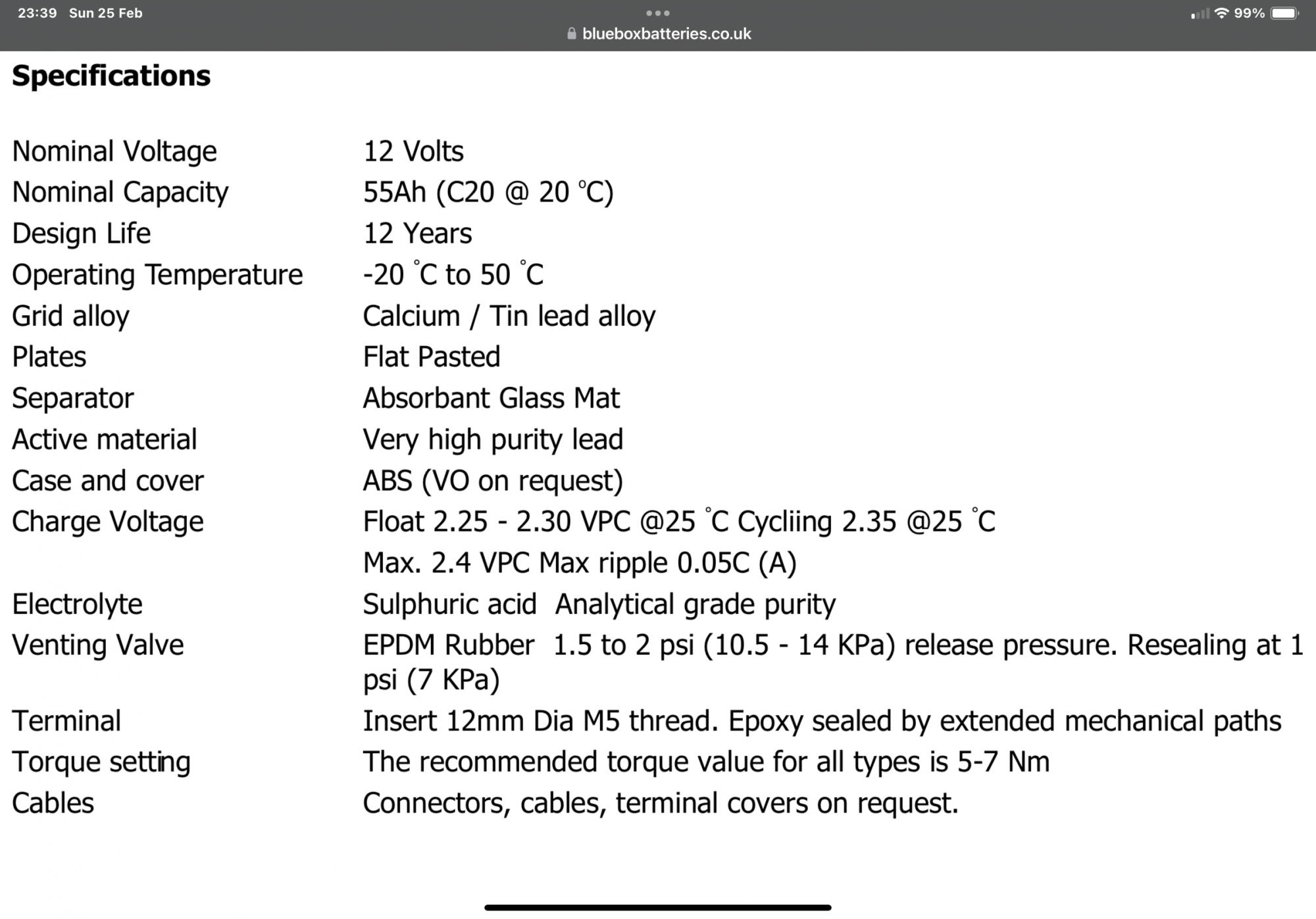

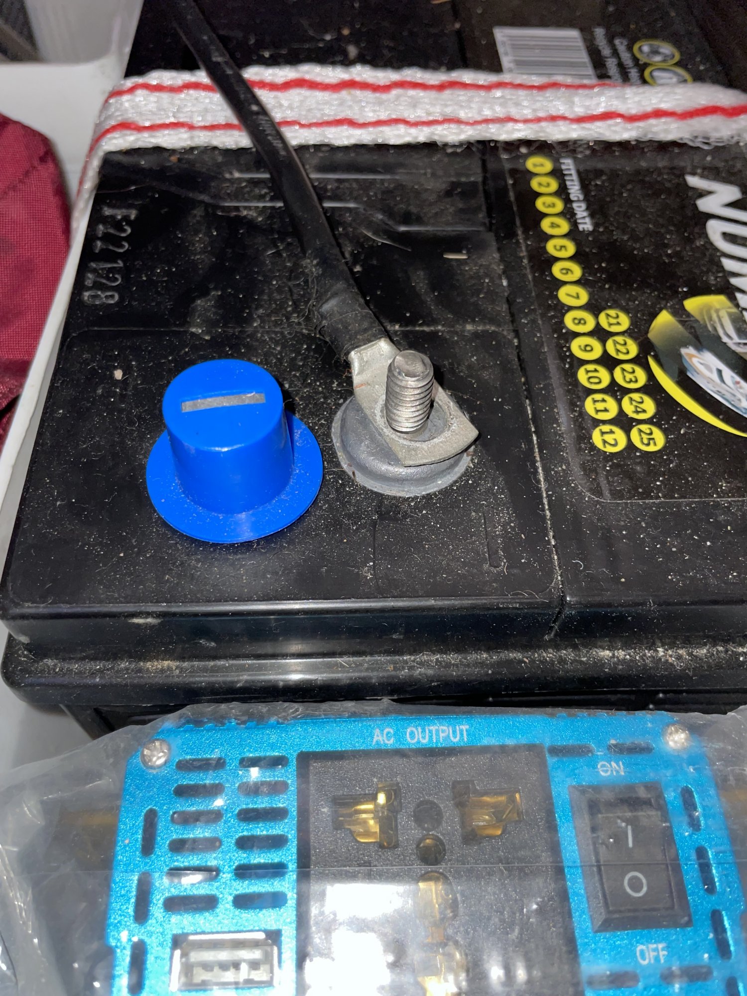

This is the existing terminal so I think I might be lucky, it says on the proposed battery float charge 2.27 to 2.3. And cycle application 2.3 to 2.4, can anyone explain please and would it be best to make one big battery or 2 smaller ones if I’m getting 6 in total ? IMG_0591.jpeg
