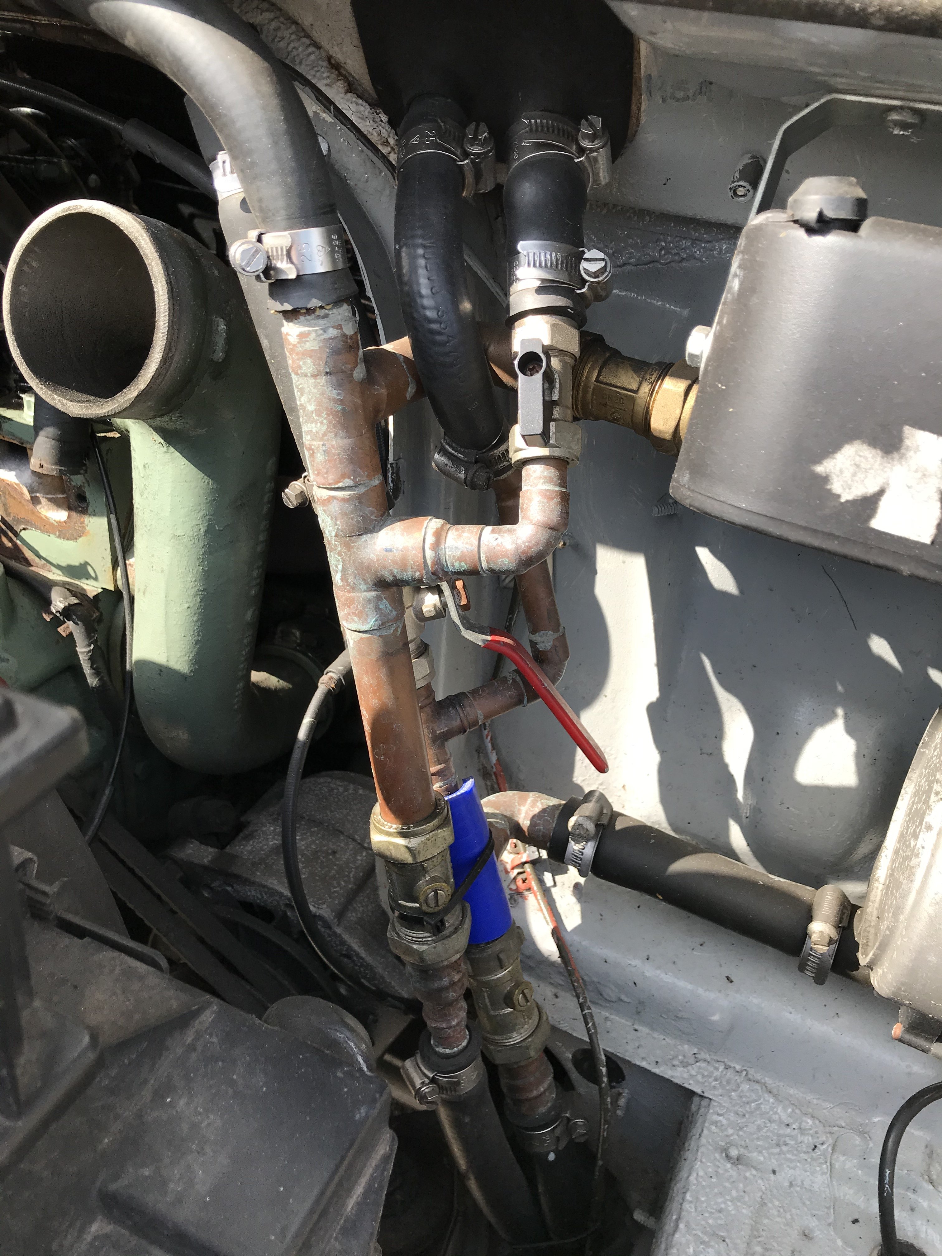

A single valve will stop the flow, but 2 valves will let you isolate the calorifier.
An option would be a solenoid valve and a manual valve on the other pipe for isolating if needed?
On Murky I used domestic plumbing 1/4 turn taps and isolation valves for emergencies.
That’s what I needed, perfect thanks!! I’ll probably tee in just where the lines go into the dash for the cabin air heat exchanger. Not sure how to determine which way the coolant flows but at least there are two pipes there in opposing directions, ie one in and one out. Would I be right in thinking it shouldn’t matter which line gets the solenoid?
