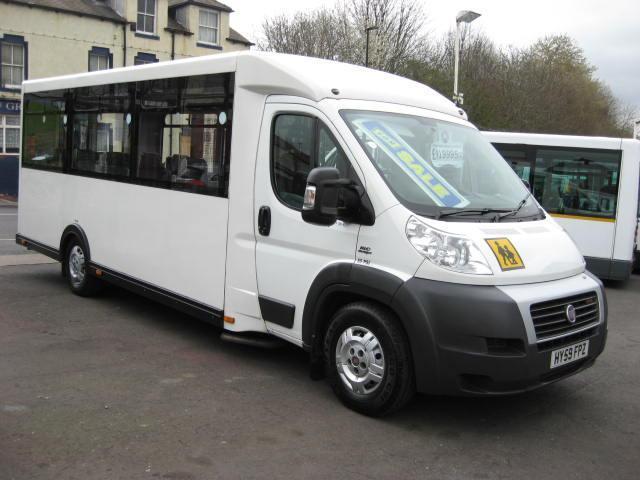

I have just missed out on a Merc Vario minibus used for schoolruns and fully tested, clean as a whistle plaxton coach built body extremely tidy and only being sold due to new terms and conditions of travel imposed by the educaton authority £3000 including vat sell the seats and disabled taillift a ratcliffe would make a dent on initial purchase cost, the only downside an auto box, 250000 kms so just run in

Following this with interest. I'm somewhere in the middle and potentially looking for a coachbuilt Bluebird/Mellor/KFS type minibus - best of both worlds I think, not too large and WILL be taken for long stints abroad.

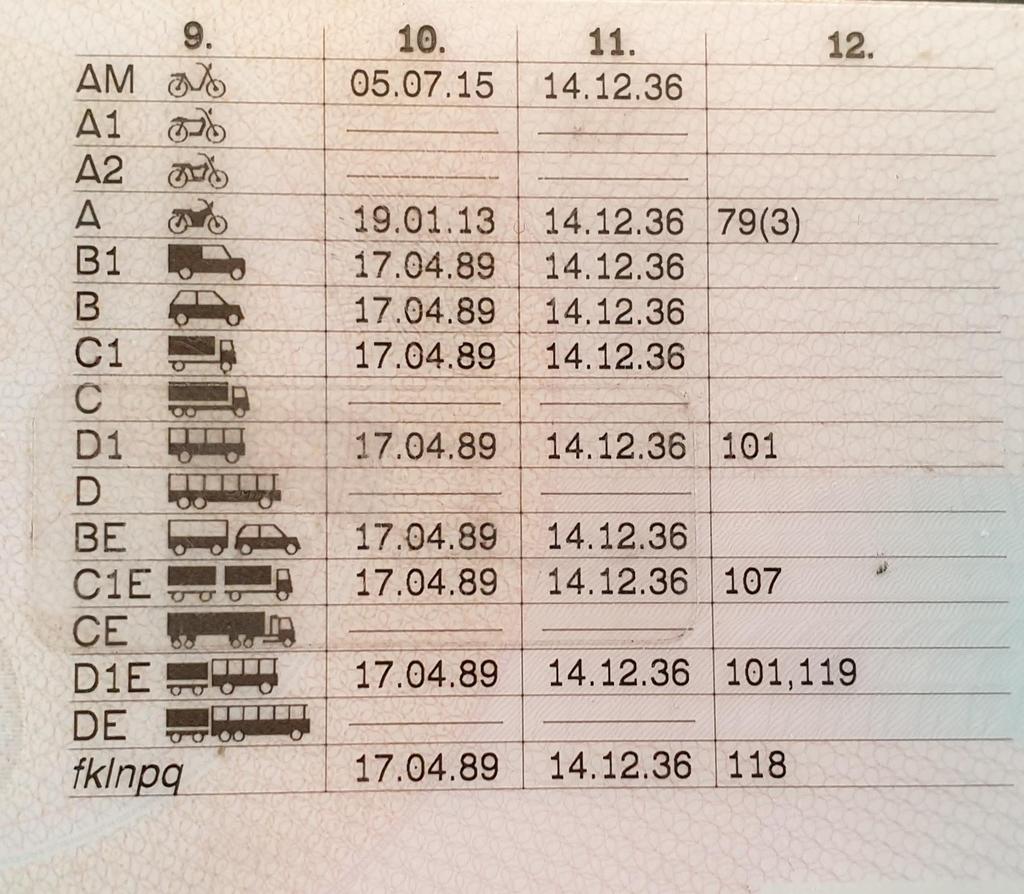

I found out that I can drive lots due to something called "grandparent entitlement" and with me passing in 1989 the vehicles I can drive are a lot more than my partner who passed in 1998, nine years after me.
Seems a bit unjust really
If you passed a car test before April 1997 then you will have a D1 entitlement via 'grand father rights' but with a 101 restriction so this can't be used for hire and reward.
A D1 category cover what are referred to as minibuses, so up to 16 passenger plus the driver.
If you are buying a 'bus' with more than 16 passenger seats currently fitted and certified then you would need a 'D' (sometimes called a PSV/PCV) category on you licence which allows you drive any size bus (inc bendy & deckers) with trailer with overall maximum trailer weight not exceeding 750KG's.
As an example a 24/29 seat Mercedes Vario based bus may be 'down seated' by the local council to 16 passenger seat in which case a 'D1' would cover it. Training council staff to gain PSV/PCV entitlement on their D1 is cheaper than cat D training.
