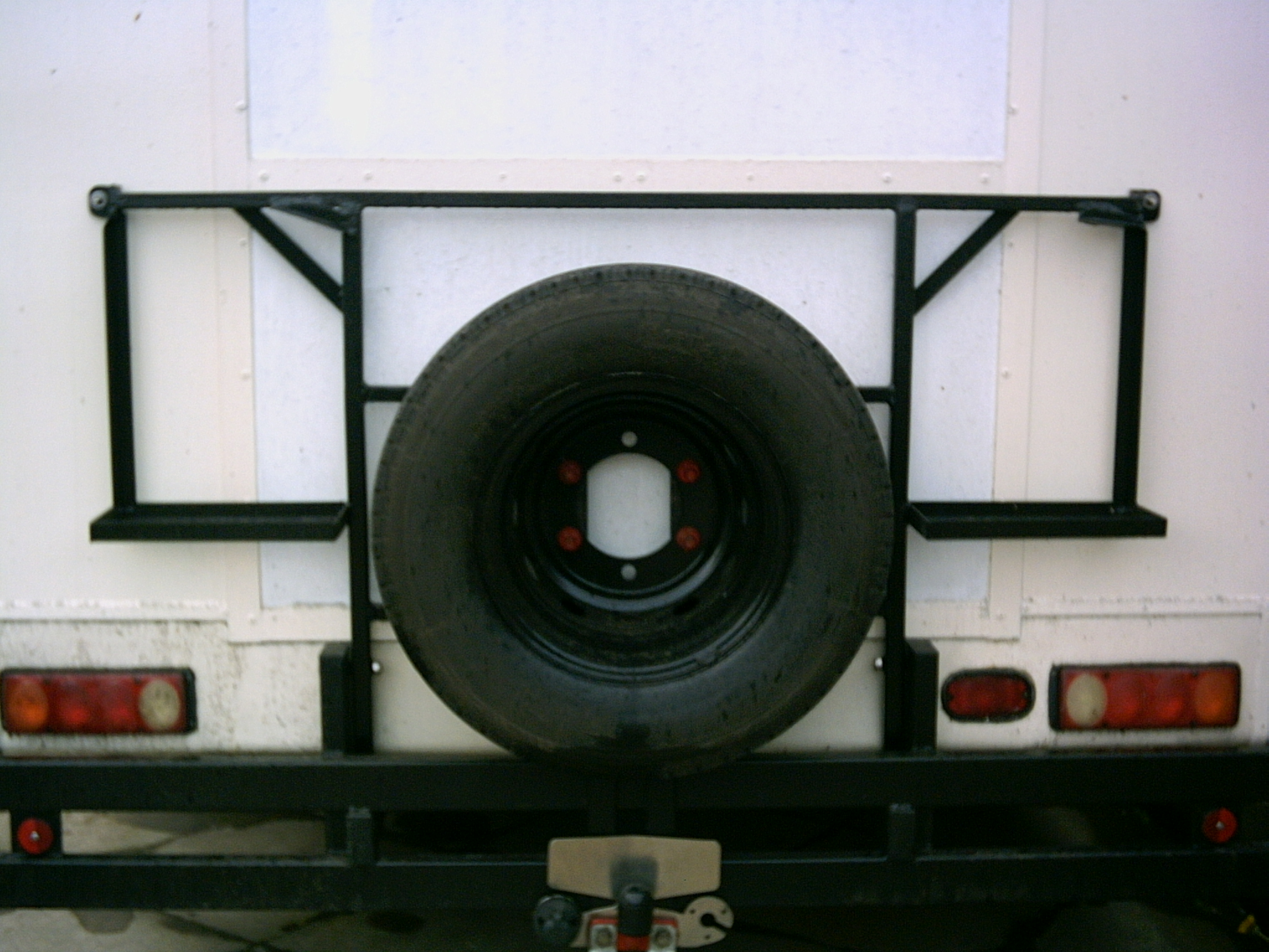

Mine is on my bum, and gage for 2 jerry cans
