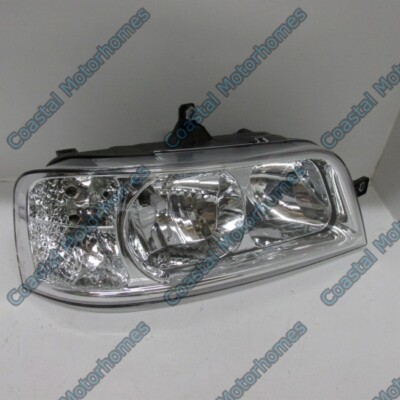

I need to change the headlight lenses as both are marked due to age.I ve used the kits to polish and recoat them but after 12months they are back to as they were.The local peugeot dealer says ,they`re out of production(2003 compass avantgarde 200) .Anyone else had this problem ? ,and can you suggest where to get them. Also i`m looking at brighter bulbs any advise as to what i can change to that the alternator can cope with. Many thanks all,chris

Loads on ebay....
Just make sure you check they are correct for yours (right hand drive etc) as it's not uncommon for left hand drive ones to be offered.

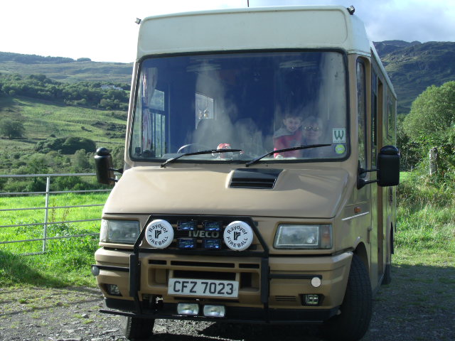

Due to being as dark as hell here in the country esp Donegal I have a lot of 100w zenon spots which is daz white in the deep dark night.
