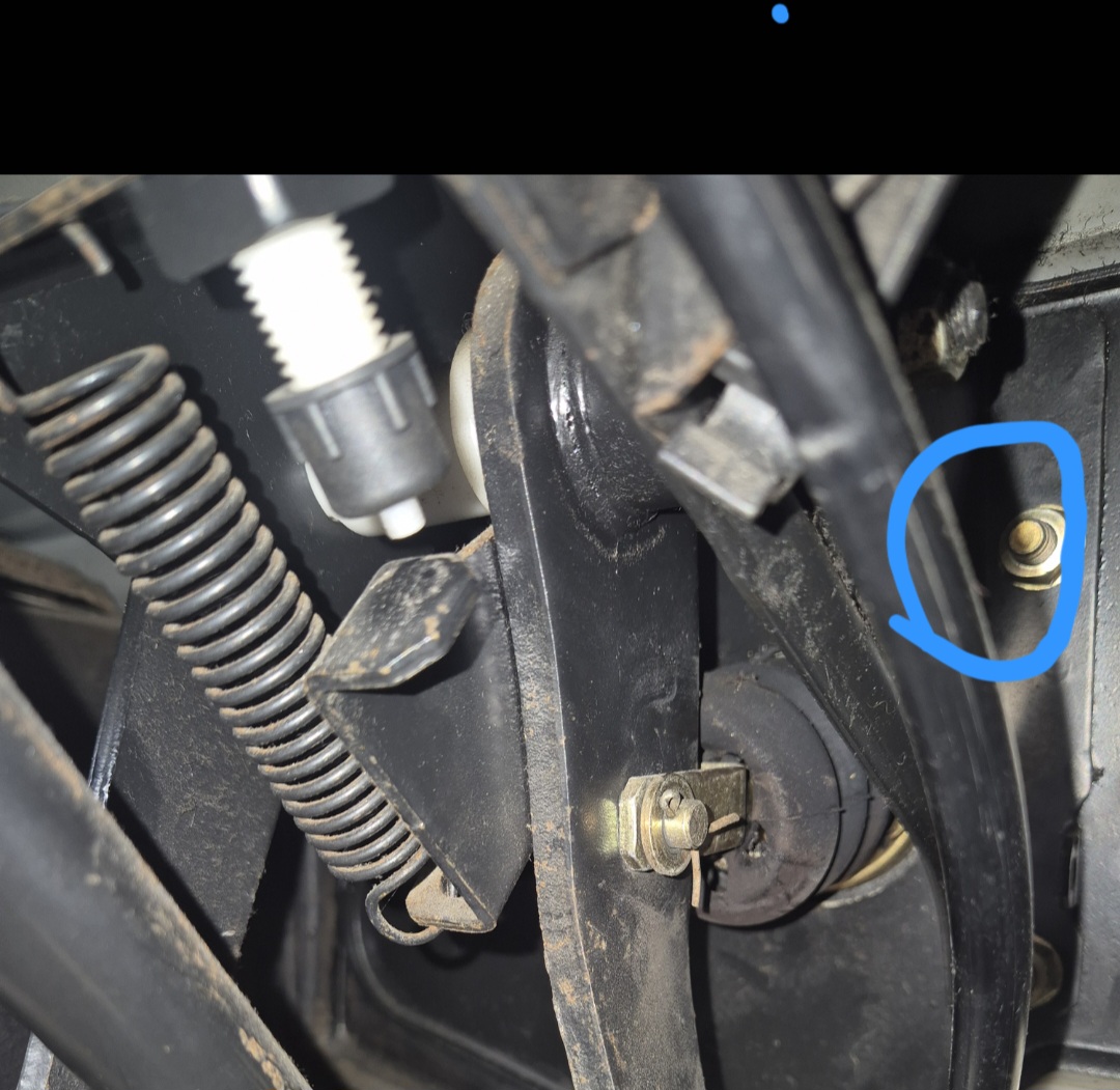

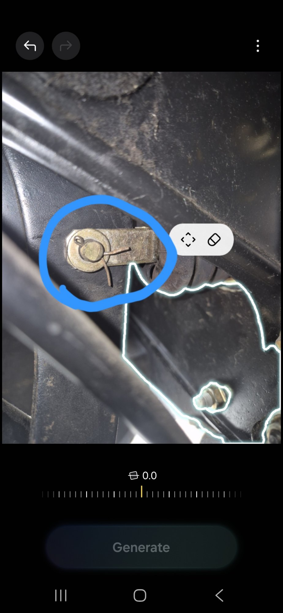

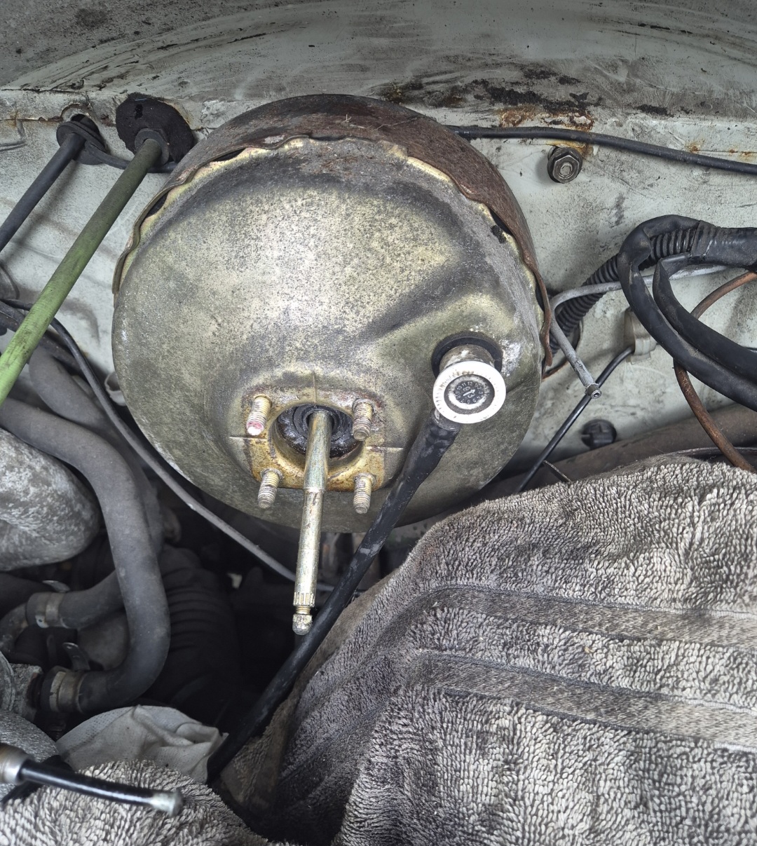

So it looks like I will have to cancel my holiday to Cornwall in August..was travelling down from Yorkshire. But hit a snag .it seems my brake servo has decided to pack in .as they dont make these anymore I need to remove it and send it away for repair ..trouble is everyone is mowed out .that aside I have removed the master cylinder .removed the pedal.linkage .pin and removed the four bolts on the inside of the cab under the steering wheel by the brake pedal..the thing still feels.pretty solid and is not budging ??any ideas am I missing anything ( 1994 fiat ducato bymer b534)
Or is it just rusted onto bulkhead in engine bay .thanks in advance

You can make any booster fit as long as the mounting holes line up, pedal push pin and servo one may require altering but not rocket sience.
