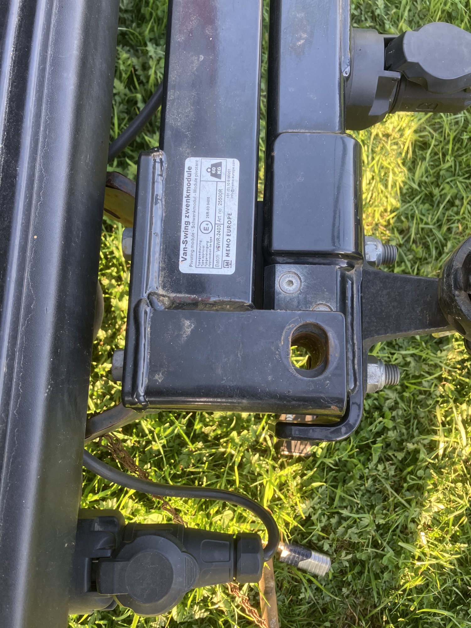

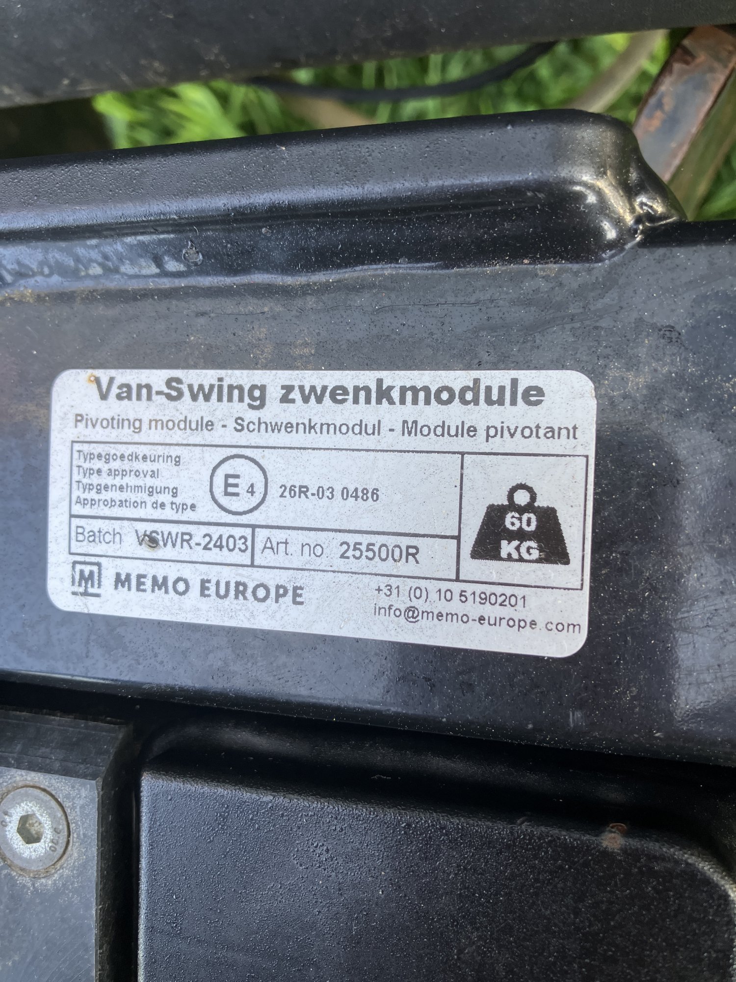

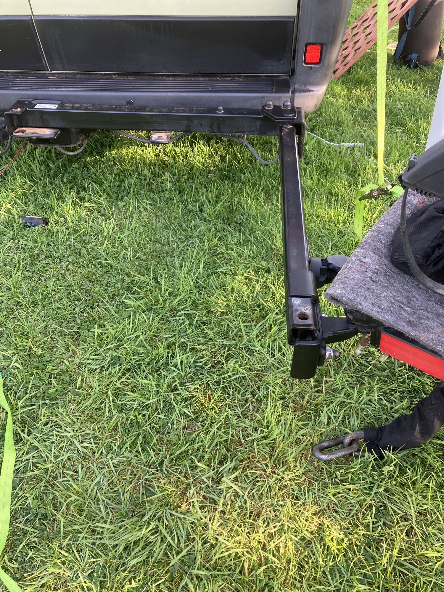

We have a pvc and 2 e-bikes , went down the tow bar route , with an atera, tilt frame , I tripped over the legs so many times we have upgraded to a van swing
Expensive but worth it saving the face planting injuries

When it comes to towbar mounted racks and wanting to easily open the rear doors, something like the van swing is a good option, the racks which hinge down might allow the doors to open, but it doesn't make it easy to access the rear of van. The van swing might look like a towbar, but you cannot use it for towing, if you want to retain the ability to tow without having to remove the van swing there is another rack, but I can't recall it's name.

The other one I was thinking of was 'busbiker', looking at their website and it looks like it can be combined with a towbar, but not used at the same time. The 'van swing' has to be unbolted and removed and a towbar fitted.

My BIL has a van swing, and carries 2 electric bikes, my only criticism, is that it extends the distance from the back of the van quite a lot, and must add at least a metre to the o/a length.
I use a tow bar mounting Buzz rack (for 2 e bikes), this does tilt down, but still not enough to open the back doors.
The van swing adds 9 inches tow bar bracket to tow ball
and to remove the van swing is 6 bolts and replace the two on the tow bar, I’ve had mine off regularly to tow a trailer
