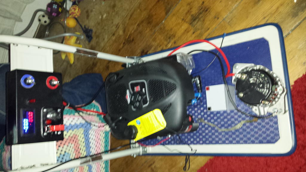

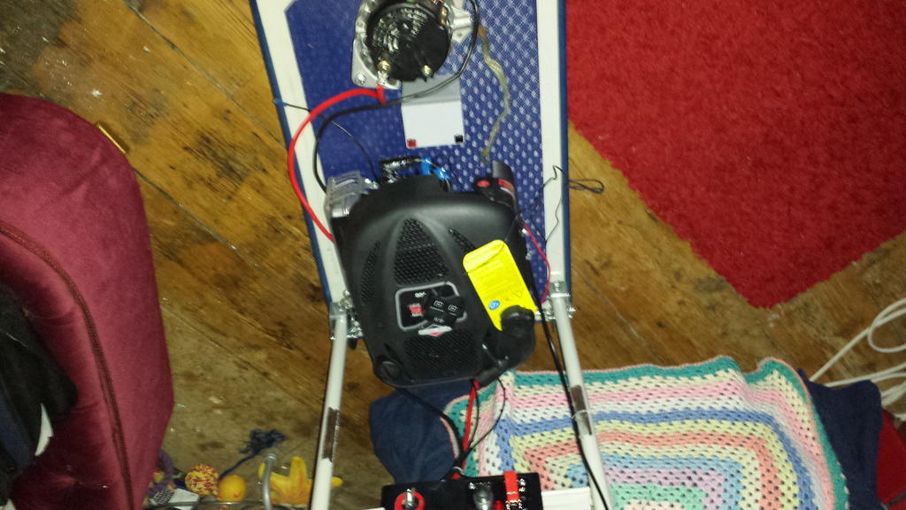

I made one out of a brand new briggs and Stratton 6hp lawnmower engine and a lucas 120amp alternator and few bits and pieces pullys ect there is detailed guides on youtube how to make one mine using new parts cost less than 250 quid charges a 110 amp hour battery from half empty in 20 mins use this a a backup for my 180watt solar panal I have 2 x 110 ah batteries
you tube link lawnmower generator - YouTube
pic attached handle folds down sorry for mess up with pics not that skilled at it yet
