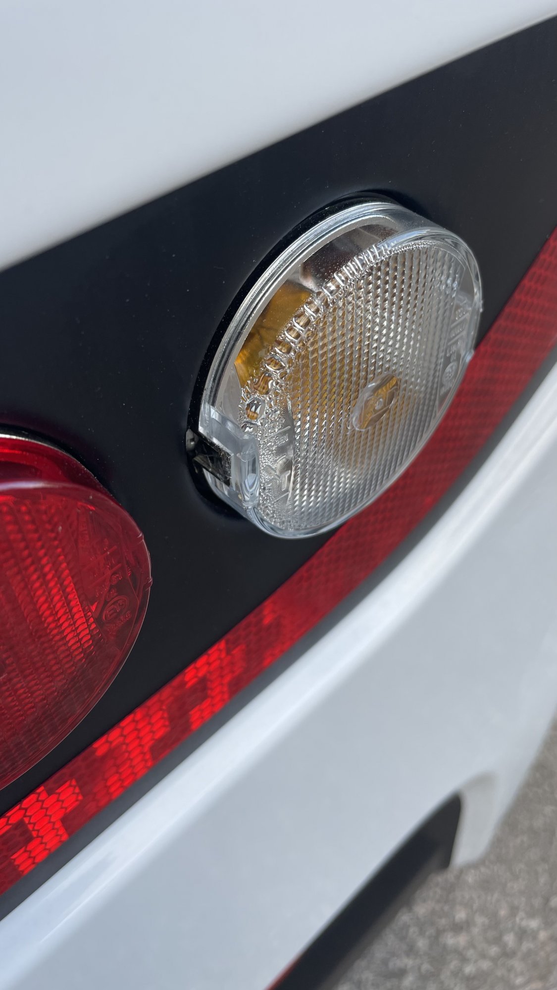

Hoping someone has come across these lens covers. I need to change the rear right indicator and am pretty stumped at the moment. Its seems to me that the lens cover indicates that to open you lever something at 3 and 9 o’clock at the side of the lens. I’ve tried getting under the gold lugs, of that’s what they are, with a small flat head screw driver, but no chance. I have found them on a suppliers website and I include a photo of this too. I have tried to find something on YouTube, etc but with no success. Any pointers would be helpful.

Couple of small flat screwdrivers should make do, both at the same time ,and some one levering it away also, all at the same time if a bit fiddly. Maybe just buy the tool 😉

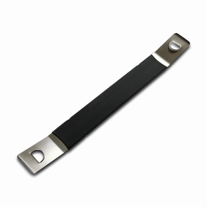

I would buy the tool, two flat screwdrivers will not locate into the D shaped protrusions I guess will be moulded into the light body, with the strap D shape ends in location, allowing equal pressure to draw out the light body.

Thanks Terry, I hadn’t found that myself using google. I will have a go and order one . I did actually speak to the Dethleffs dealer who said it was a real pain to do but he said that you needed two flat headed screw drivers and use both at the same time. Have you had experience of something similar Yeoblade? I had a go at this but from the photo Terry posts, I was clearly poking about at the wrong bit. I’m not very good at this kind of thing…..as you might have guessed.

Tah Dah! Thanks lads for all your help. The light fitting mover slightly from side to side to allow me to get a narrow screw driver down the side to push in a sticky out bit without too much trouble. Reassembly was surprisingly straight forward. Goodness knows how the special tool would work.
