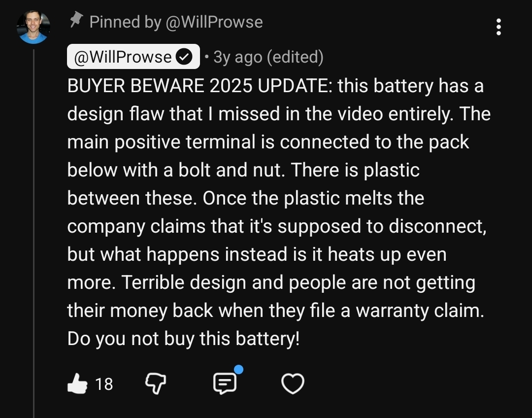

New update on this battery:
Pretty crazy this happened after 30 cycles! Geez

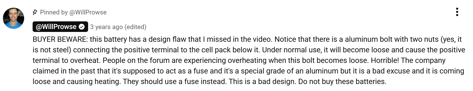

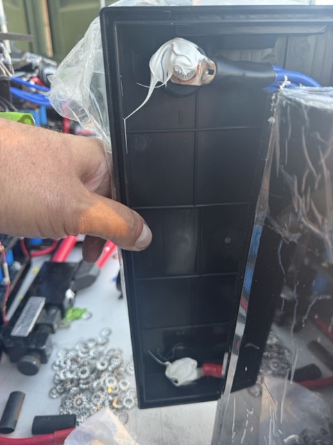

Absolutely terrible design. At 100A there's bound to be heat generated at that critical joint. The bolt will expand, the plastic will soften and deform and the resistance of the joint will rise. The raised resistance causes more heat and now you've got a runaway effect and the result is self destruction. The critical avalanche point will probably never get reached at lower currents so lighter users will probably escape the problem but ultimately BB rate the battery at 100A continuous and clearly it doesn't meet that spec.
The boating, camping and off grid communities that have bought these batteries are pretty joined up and I can see a class action law suit on the horizon if BB don't get their act together and persist with their "over current deliberate design" excuse.

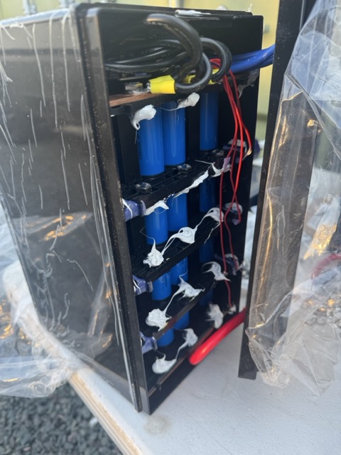

From what I can find it seems that the 100Ah batteries have always been built with the plastic spacer and they use/used an alternative build without the plastic spacer on the larger sized 270Ah.
It seems very odd that they should use what appears to be thermoplastic in that way, you might get away with it if using SRBF, or SRBGF, but even then I not sure you would sandwich it in that fashion.
