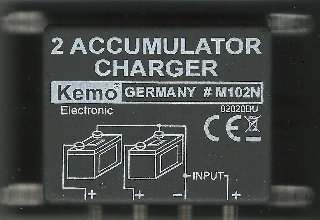

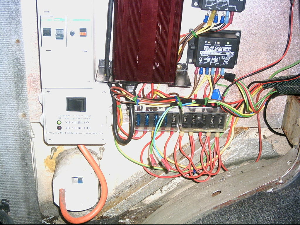

most batts will discharge in a few weeks thats normal ,have you a solar panel if so fitt one of these and both batts will get a charge the lowest one first.or fitt a numax charger and a charge spliter.
