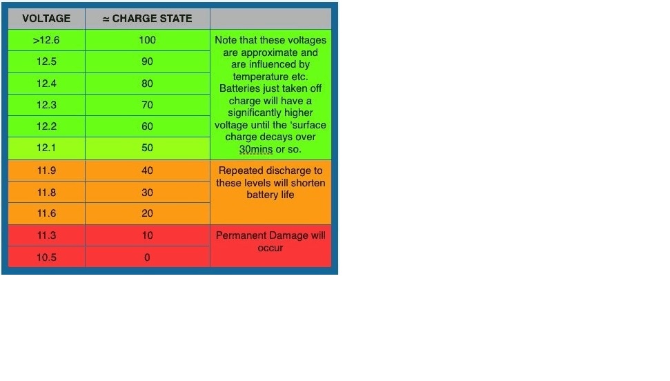

This table gives an idea of what a 150w panel will supply.
The voltage serves as an indication of the charge state.
