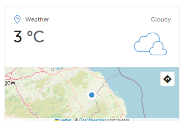

Tried to charge my Leisure battery sargent charger only putting 1 amp in , then it dawned on me it is too bloody Cold ,
Too Cold? It's a balmy 3C and I'm in me Speedos 🤡

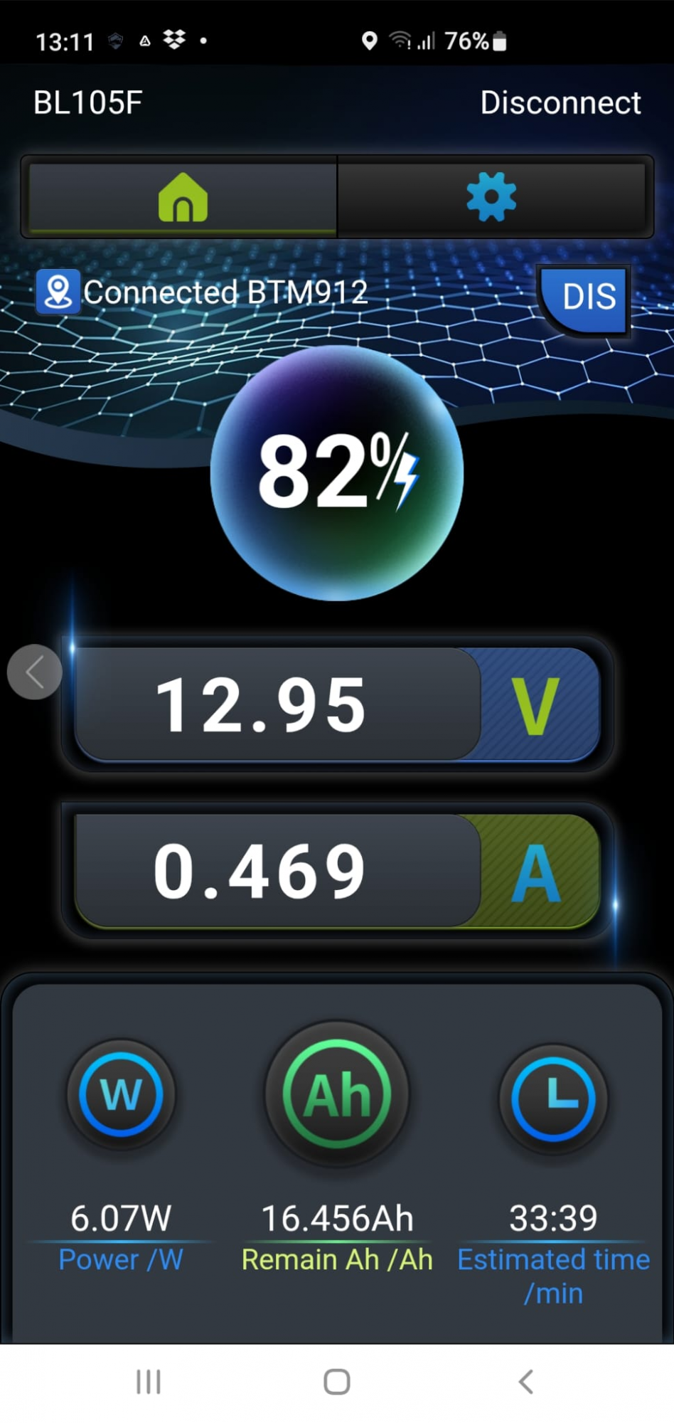

I looked at mine today while draining down (I meant to di it the other day but I was using the water.
Leisure batt with shunt.
Leasure batt with long time observations

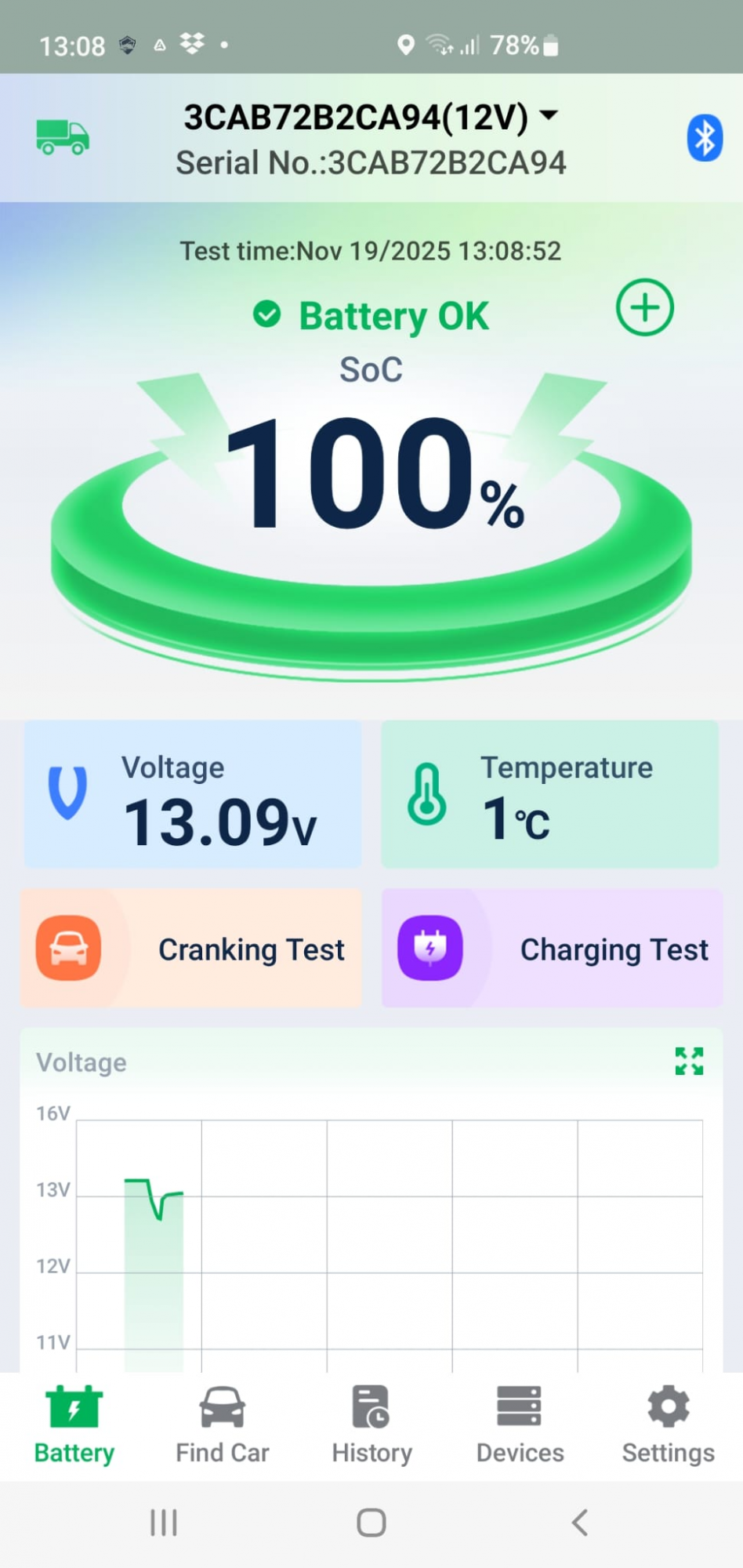

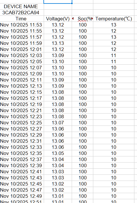

I just downloaded the data from My ancell battery monitor, very easy to understand and almost minute by minute, it all seems to be accurate enough for my needs.
Nothing to do with the cold.

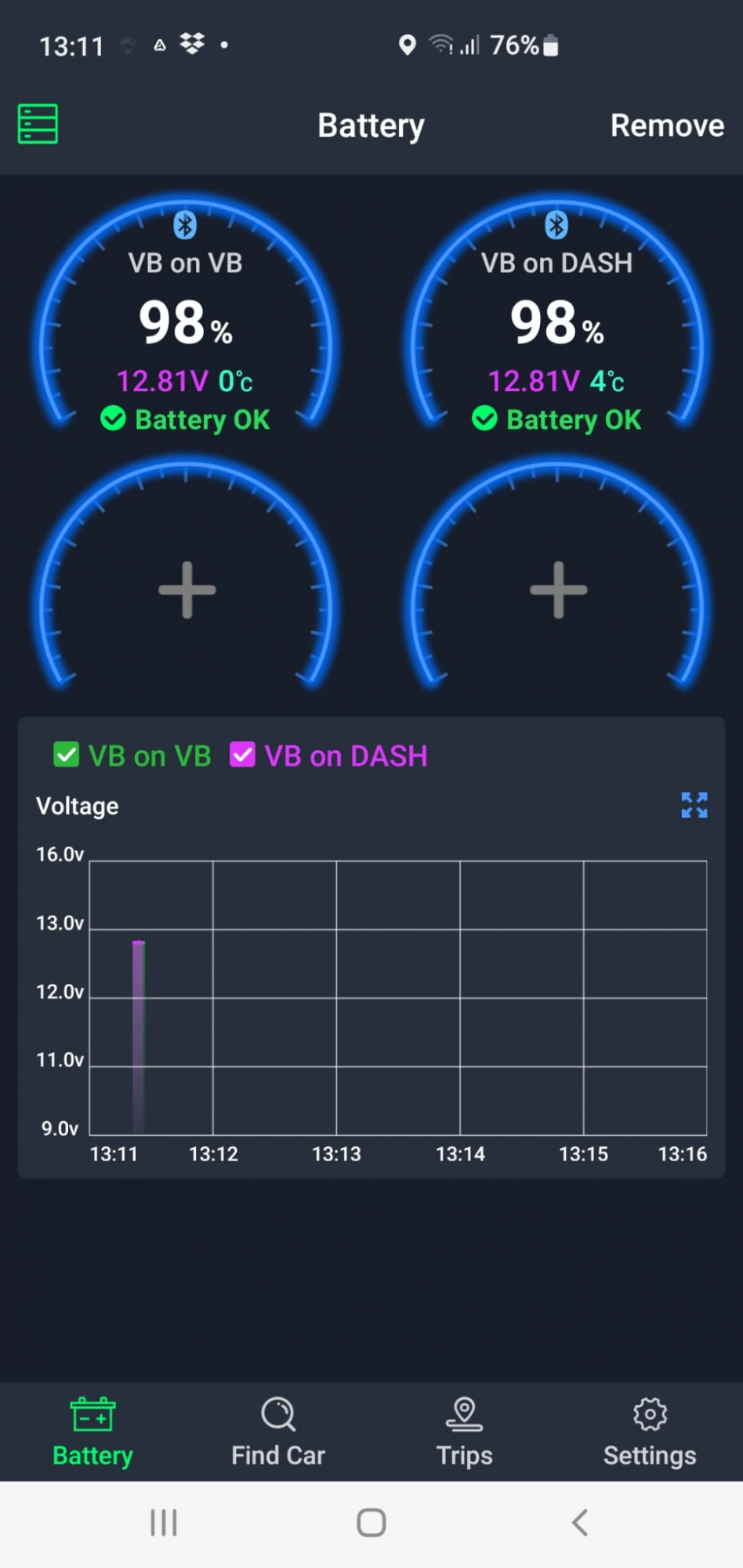

I get so confused with all this work of the divil stuff, I have four battery monitors now, (who said I'm paranoid????) not really they all tell me different things, one keeps a 72 day long-term memory of the LB, I was thinking of getting one for the VB, but I probably willn't. The others are simple 5 day monitors, and one is a shunty jobby, (tech term) which informs me of current use etc
No I don't want a little blue box.
As you say solar is unlikely to damage a lithium battery. The biggest risk is on cold starts from the alternator.
I have a Renogy 40A B2B which has the option to toggle with a remote switch to 20A. It is activated from the alternator D+ so I've wired in a 3 position switch so I can have 40A, 20A or Zero charge. It's generally left off because in the summer the solar usually does the job, certainly off during the winter for the reasons already mentioned.
You dont need a blue box Kev, things are looking great on your van so far, just keep whatsapping me images from your monitoring devices and I'll keep my eye on what's happening and prevent the flat battery/knackered ECU issues occurring again.
There's no perfect solution Kev, we've all seen people getting completely flumoxed because their dead simple PDU display with 3 lights says the battery is great and then they go flat in no time. The other extreme is to monitor the capacity in far more complicated and sophisticated ways BUT then people are faced with the not so simple process of interpreting the results. As we've seen having a myriad of voltage readings from monitors and particularly BMSs can lead to constant monitoring and high anxiety levels because things don't appear to absolutely 100% perfect. Be thankful you've not got a Bluetooth BMS on a lithium battery, you'd probably be well stressed about cell imbalances by now mate!
