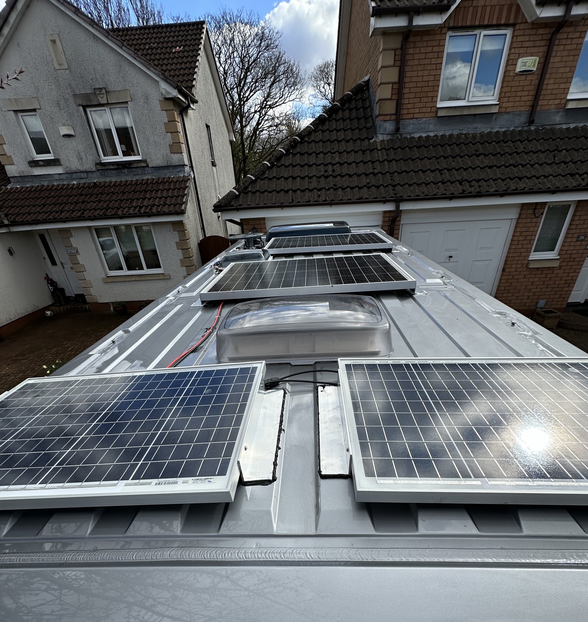

Takes donkeys to charge, best rate is 10 amps for 100ah battery, divide volts into watts 100 div by 12v- about 9amps on a good day, we dont get a lot of those Rob.
As I said though Trev, I had no problems. That's with the usual lights etc, compressor fridge and occasional TV. Although I rarely stay anywhere more than 2-4 days so then the alternator gives them a boost.
So I would say unless you are staying off grid for long periods without the engine being run then 100W is suitable for many people's needs.
I am now upgrading to 600AH Lithiums and 850W of Solar but that is only because I am converting to all electric for cooking, water heating and everything else.

Im the same and no more than one overnight, but when the van is at home i dont require to plug in excepth nov dec with short dark days.
That’s just a guideline Trev, not a necessity. It just boils down to the more solar the larger the charge
I have never seen the point of this recommendation. My attitude towards solar and batteries is really simple, fit the maximum possible in both battery storage, and solar harvesting. My current van has 2 100ah lithium and 340w solar. I could not practically get any more panels on my roof, and to increase battery capacity I would have to remove the vehicle toolkit from under the passenger seat and fit an additional battery there. But as my current set up gives me more than I need all year round I don’t see the point. I even run a victron 1200 inverter all year round, although I once had to limit its use in winter. My advice is fit as much solar and battery storage as you practically can, and use Victron, which as David stated has dropped significantly in price in recent years, but without any loss in quality or performance.
Desirable Trev but not required.
I ran my 240AH with a 100W solar panel for years with no problems.
The Dealer installed a 180w Solar Panel as part of the deal in April 2021 for the 100Ah lead acid battery. Converted to 120Ah Lithium in Jul 2021 then to 230Ah Lithium in Feb 2024. A larger Solar Panel would be useful for quicker recharging if we hammer the battery in poor weather, but it is manageable

I have never seen the point of this recommendation. My attitude towards solar and batteries is really simple, fit the maximum possible in both battery storage, and solar harvesting. My current van has 2 100ah lithium and 290W solar. I could not practically get any more panels on my roof, and to increase battery capacity I would have to remove the vehicle toolkit from under the passenger seat and fit an additional battery there. But as my current set up gives me more than I need all year round I don’t see the point. I even run a victron 1200 inverter all year round, although I once had to limit its use in winter. My advice is fit as much solar and battery storage as you practically can, and use Victron, which as David stated has dropped significantly in price in recent years, but without any loss in quality or performance.
Oh I agree Bill.
But Trev's statement that you require 100w per 100AH is a bit misleading and low electricity users would not need this. I ran my first motorhome quite adequately with 90AH and no solar panels for a couple of years.
Oh I agree Bill.
Just a genaral rule, as you well know some folk are electric heavy, im like you and use little, fridge some lights and usb charging for phones
