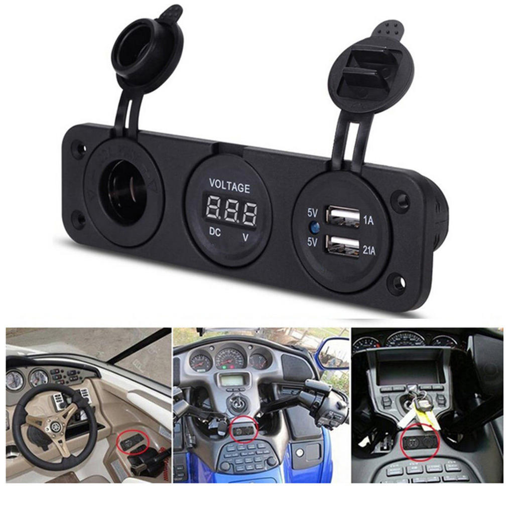

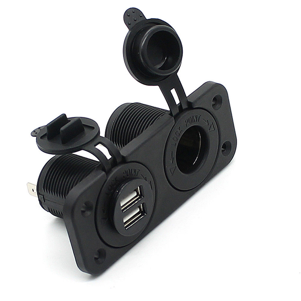

Simple thing to do is remove the silly old small 12v socket and fit one of these which will also give you usb to charge phones up or use a usb fan/laptop chrger etc.
