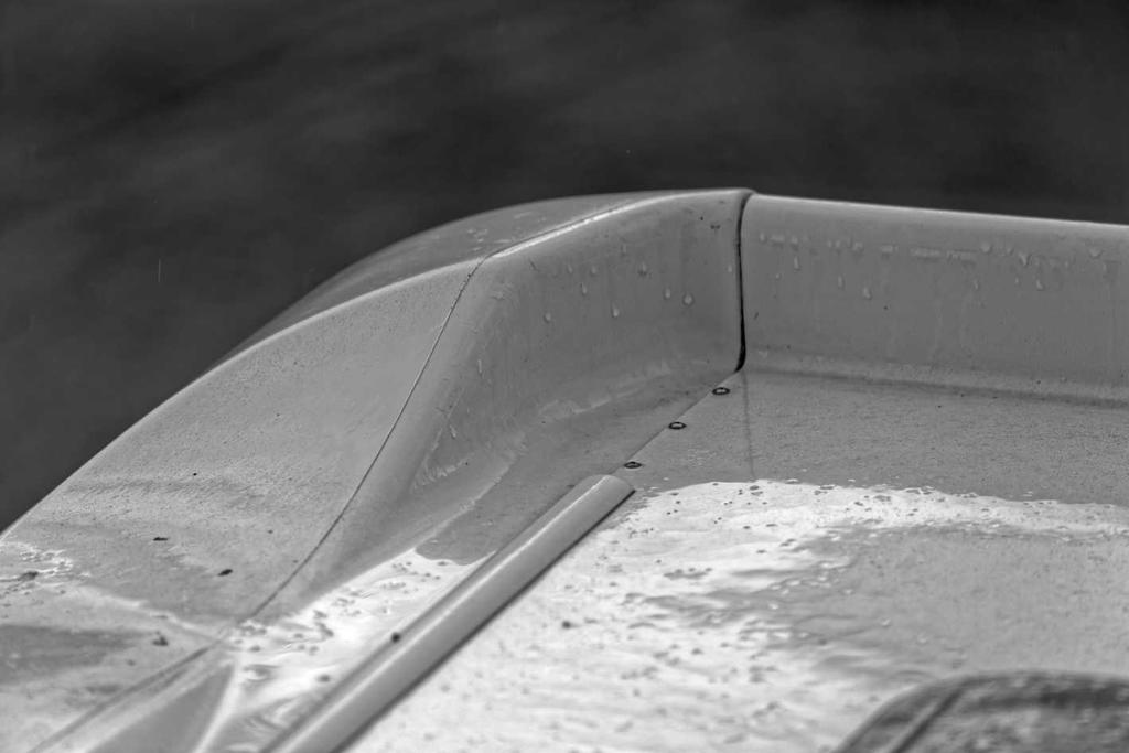

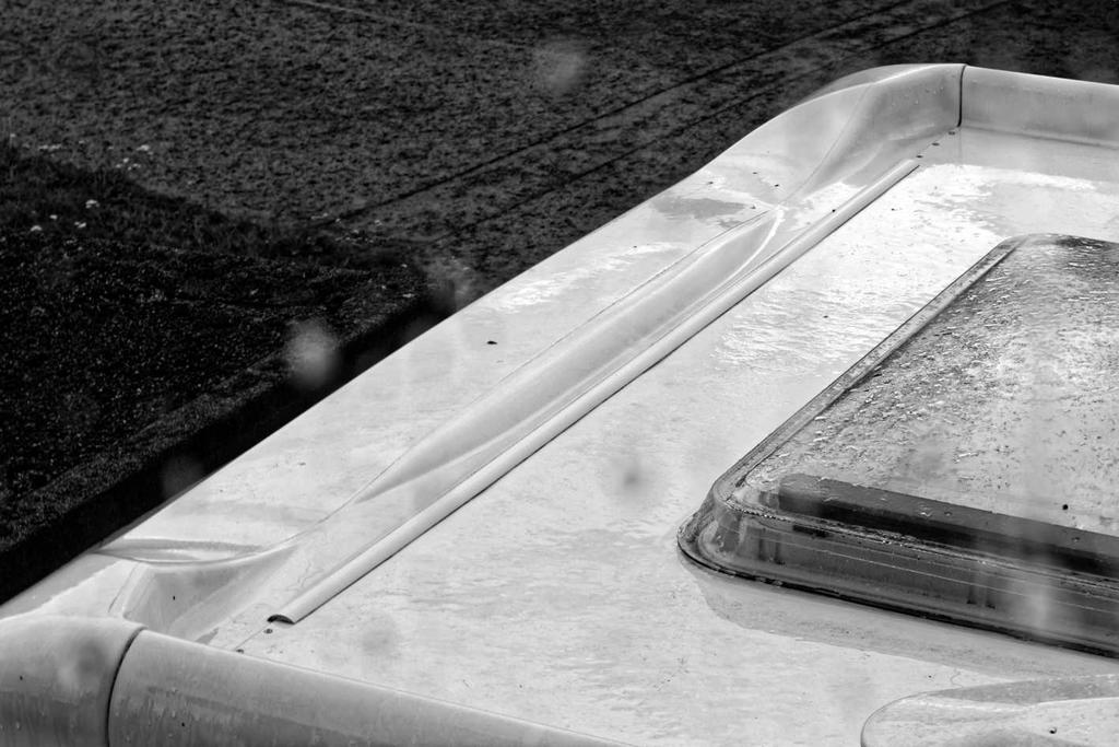

I have a 2011 model and seeking advice in regards to the roof
I have established that it's designed for rain to run to the front and disperse each side of the dome. Where the roof connects to the rear body panel is a strip similar to those used on the sides at joints. Each side of this is three rivet's. Now unless there should be gaps in those joints for drainage reason I think they need re sealing.

Thanks for your reply. I don't disagree with your views, however I'm cautious because of the way this motorhome deals with rain. It has no guttering and the sides are raised with the only escape for water being each side of the dome at the front. However I wonder if there's an additional perhaps quirky rain drain at the rear. I need to establish this before getting out the mastic gun, I don't want to block what may be a type of drain.
My Dakota is the same.
The strip is purely cosmetic as far as I can work out. If it extended the full width then water would pool rather than run down the rear panel.
I don't believe you need to do anything.

You can be sure it is sealed, unless of course there is evidence of water ingress. The line of rivets no doubt continues across the entire width of the joint. The D-section trim cover is just that and is cosmetic.

No water ingress yet, but I like to correct things before they get to that stage. Thank you :cool:
I thought I would update you with the response from Autotrail Customer Service
Great response from Autotrail Customer Services
2011 Autotrail Apache
Aftersales Team <aftersales.team@auto-trail.co.uk>
21 Aug 2018, 16:03 (22 hours ago)
to me
Good afternoon
Thank you for your e-mail, from the pictures we can assure you that this is correct, the roof and the rear panel overlap each other and are fully bonded together, the strip and rivets are there to add extra support to the area and ensure the bond does not fail, the strip running across the roof does not go edge to edge to allow water to drain off the rear of the vehicle.
