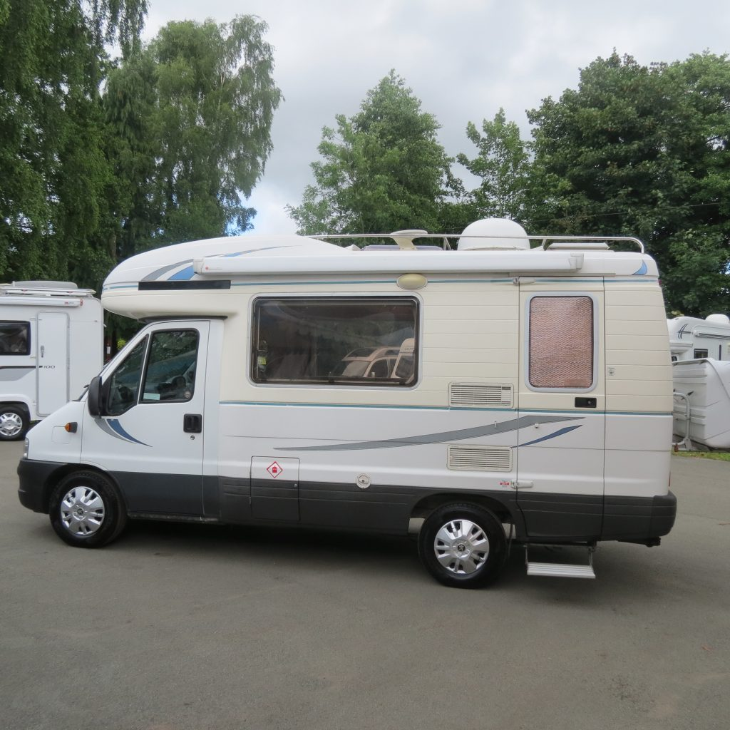

Looking to add another solar panel onto the roof bars as in the pic [not my actual mh]. The distance between the bars is approx 63". I have an unused solar panel that I've had hanging about for 3 years or more, it measures approx 55",
I have a belt and braces idea of how to affix the panel to the roof rails but I'm interested to know others members ideas which will more than likely be better than mine!
I'm thinking of bolting 3/4" square aluminium tubing to the underside of the panel frame then 'U' clips around the roof rails.
What d'ya think?

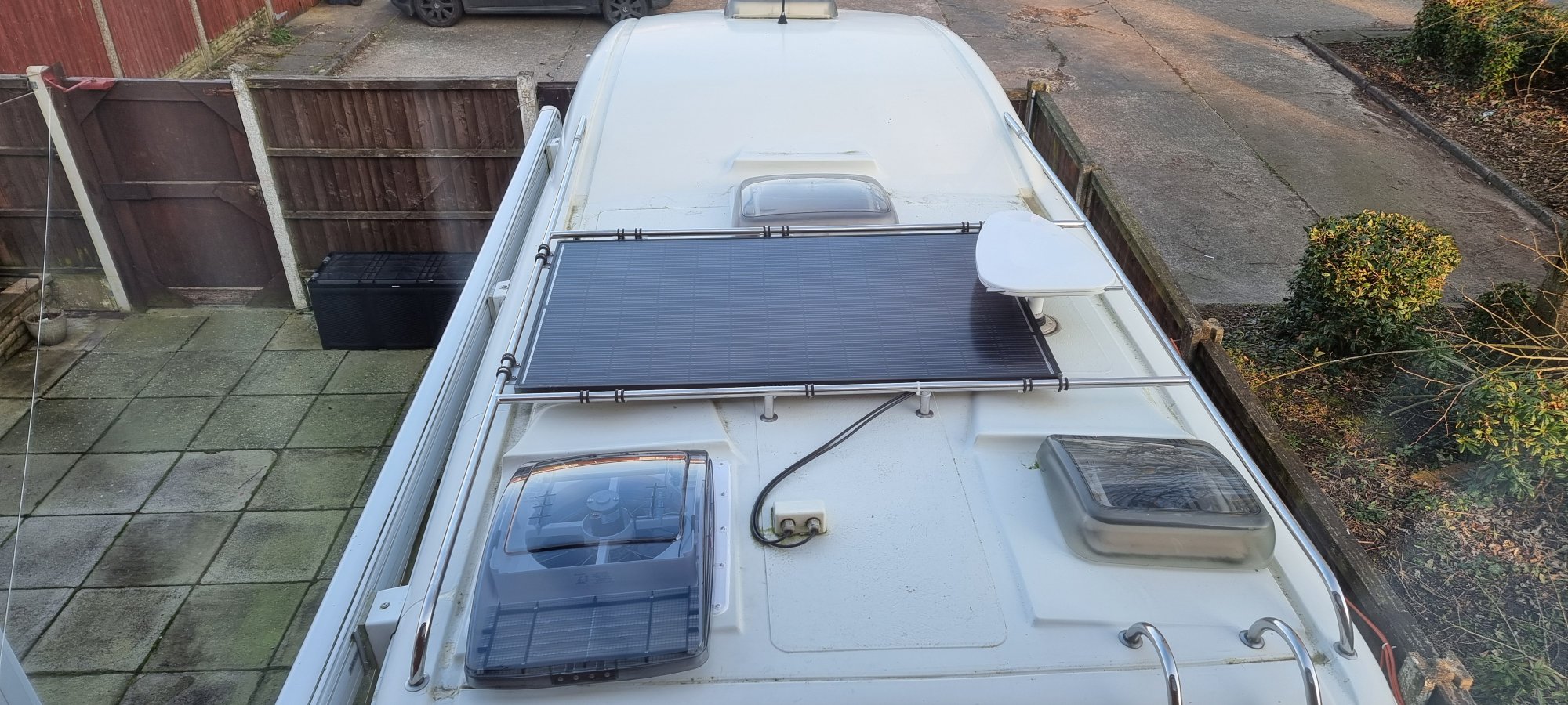

I fitted a 200w panel to my roof bars using 22mm Rubber Lined P Clips Hose Pipe Clamp Stainless Steel - they fit the autosleeper bars perfectly. Before that i had a 120w bonded on the roof with ct1.
